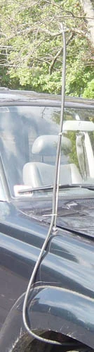

too much work better to use the powered variable altitude vent.:popcorn:
I think this is the best solution. A height proportional breather system.
attachment.php
Water gets deeper, just raise the antenna a bit more.
