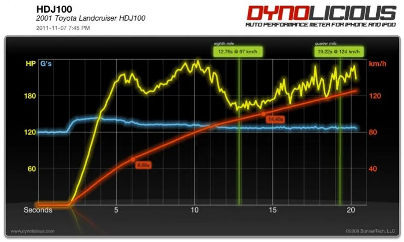

Here's my 0-100 phone dyno plot. Ignore the HP column, vehicle weight wasn't set. I was running 2 phone dyno programs at the same time, the aDyno one agreed but the plot isn't as clear.

You made me spent 13$ but it is alot better then. The free one i used. There was a slit declined for the first 300 ft.
14.4 sec, weight at 5400#, with 30% drivetrain loss.
Nice one. That's pretty much what I got with the HDJ100 here and a stopwatch.
It shows the advantage of an auto quite well, no dropoff in acceleration between gear-changes. I have a wide ratio gearbox and run 2/3/4th on a 0-100km/h sprint. Better gear ratios would take whole seconds off, but I don't own this vehicle for the 0-100 time.
