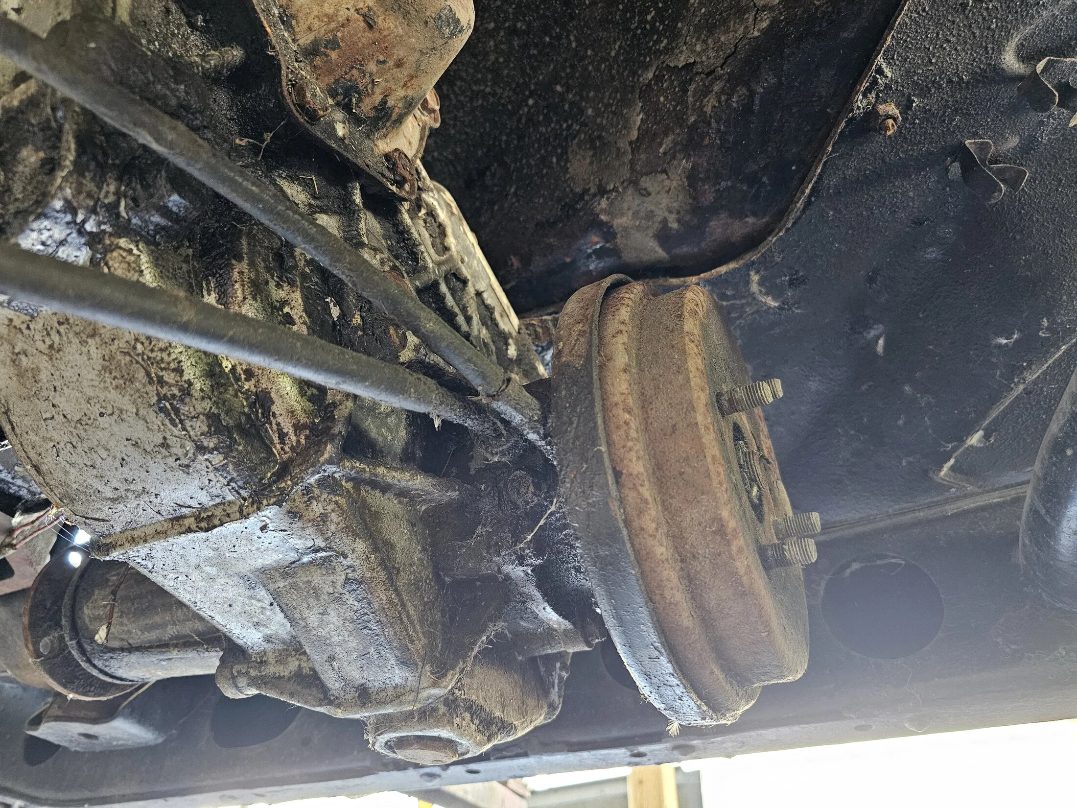

Agreed. Helping my uncle swap a 3B into his 77 FJ40. The axle e brake thing is a pain. Looks like we are shortening a FJ60 axle.

Could you please be more specific about this problem I am in process of the swap,removing 1F from the 1974,FJ40 frame and want to install 3B in it,it will be great if someone have solutions this axle E brake thing.

Thanks for a heads up, I think I should post a picture of my 3B engine and transmission i am not sure if it does have parking brake thing.

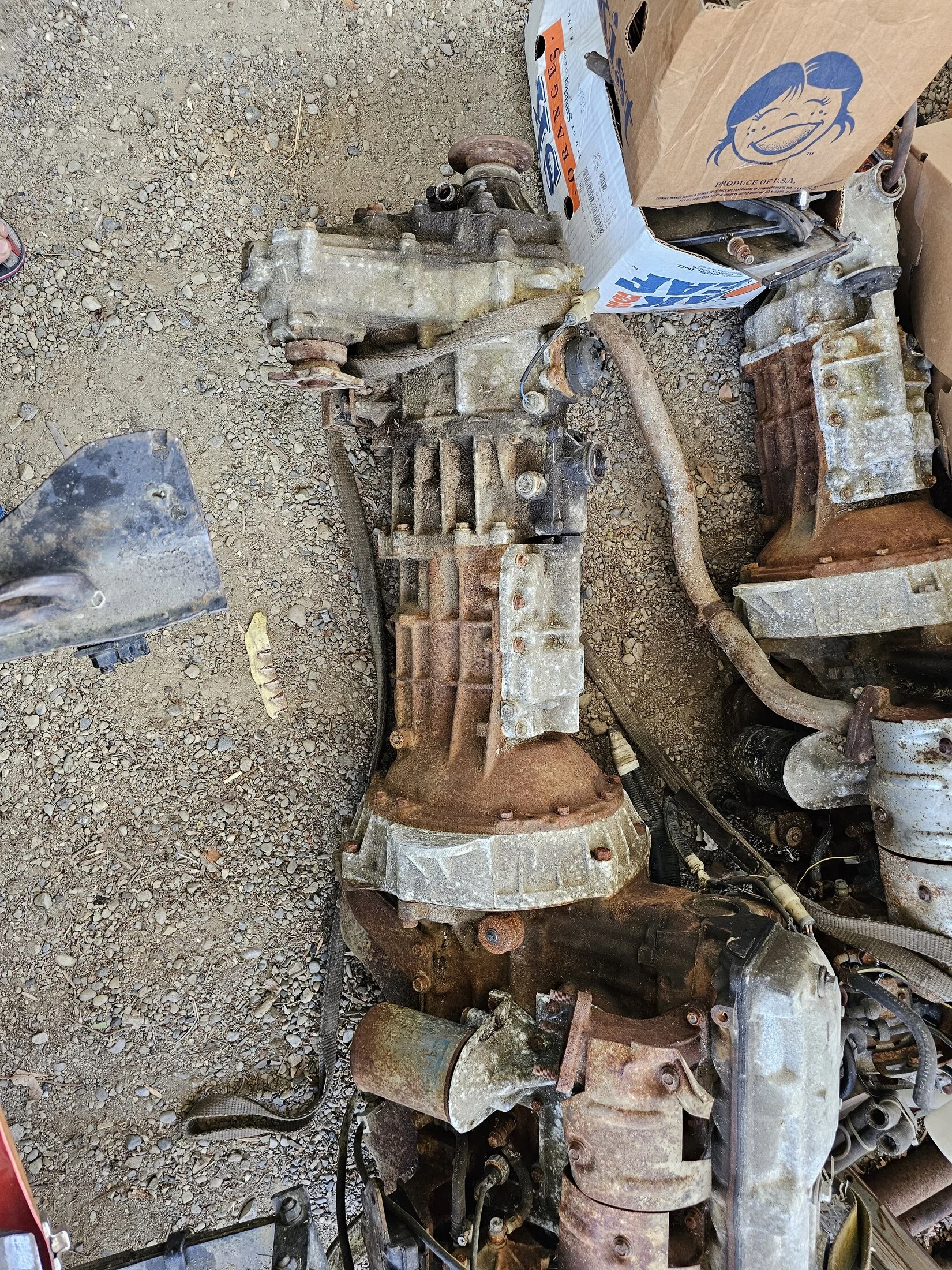

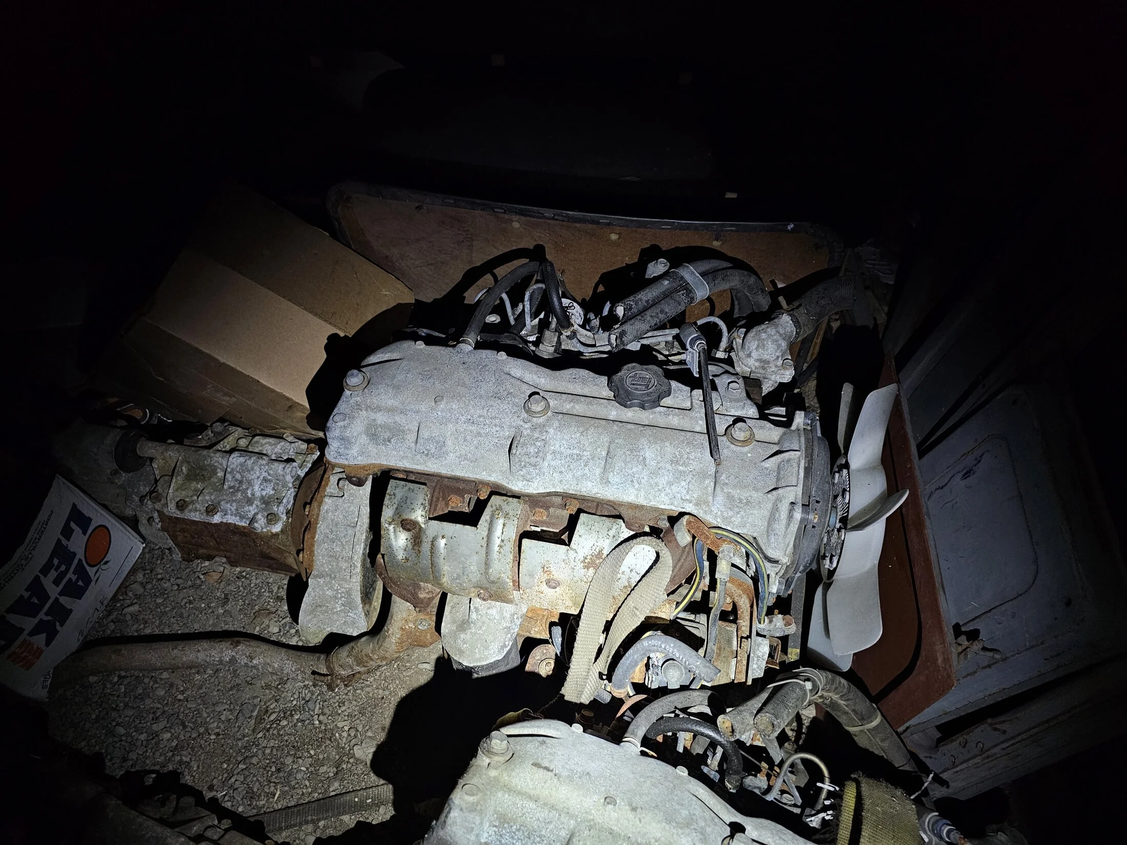

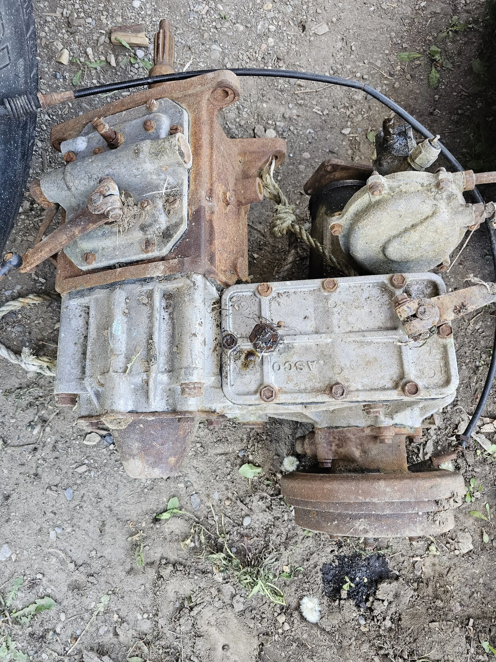

The first picture is the transmission with 3B engine which i want to put in,2nd picture is the transmission which is already in,I noticed the cross member is rounded so it is not in the way to install long transmission,this is thinking not sure.
That first picture is not a 3B engine, the transmission does not look familiar either and the transfer looks like it's from a Hilux or light duty Land Cruiser. Where did it come from? Looks like it might be an L or early 2L engine.
I'm with you on this one.. G52 transmission maybe.. and definitely not a 3B engine.
Thanks guys I got these two engines and transmissions with the two land cruisers I bought ,both vehicles have engines in them one is 1974 fj40 other one is 1981 bj40,the guy who sold me all these told me both engines and transmission are from bj42 .
Thanks for reply does L or 2L looks like3B engines,
Can you provide some more photos of the engines?

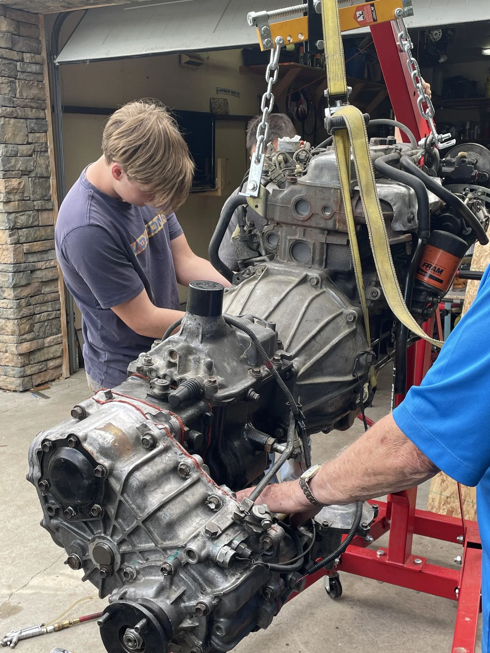

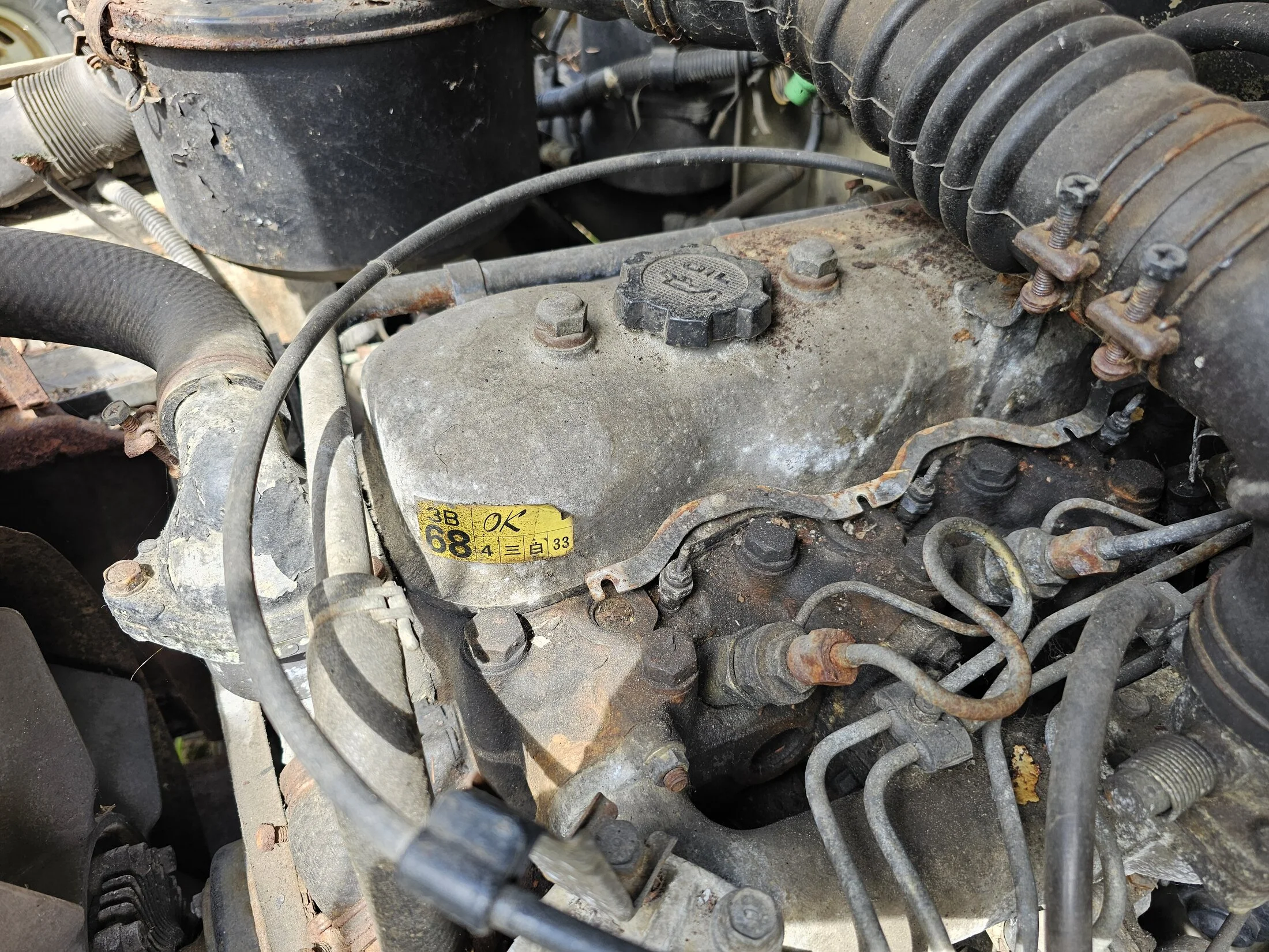

The girst two pictures are with the transmission and engines, 3rd picture is another transmission which is have clue what is that 4th pictures is the engine inthe bj42.
The last picture shows a 3B. The first two are either an L (2.2l) or pre-1989 2L (2.4l). The third picture I don't recognise but look like an H41 which would fit with a BJ42 and 3B.
