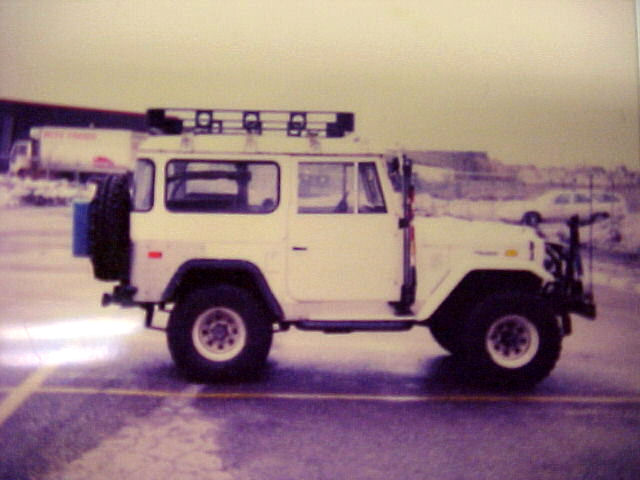

picture from 1994?
the DP's were holding the bondo from falling out....but...it did look good for some time...had the $$$ a few years later to fix...now no more bondo....and no more DP's.
