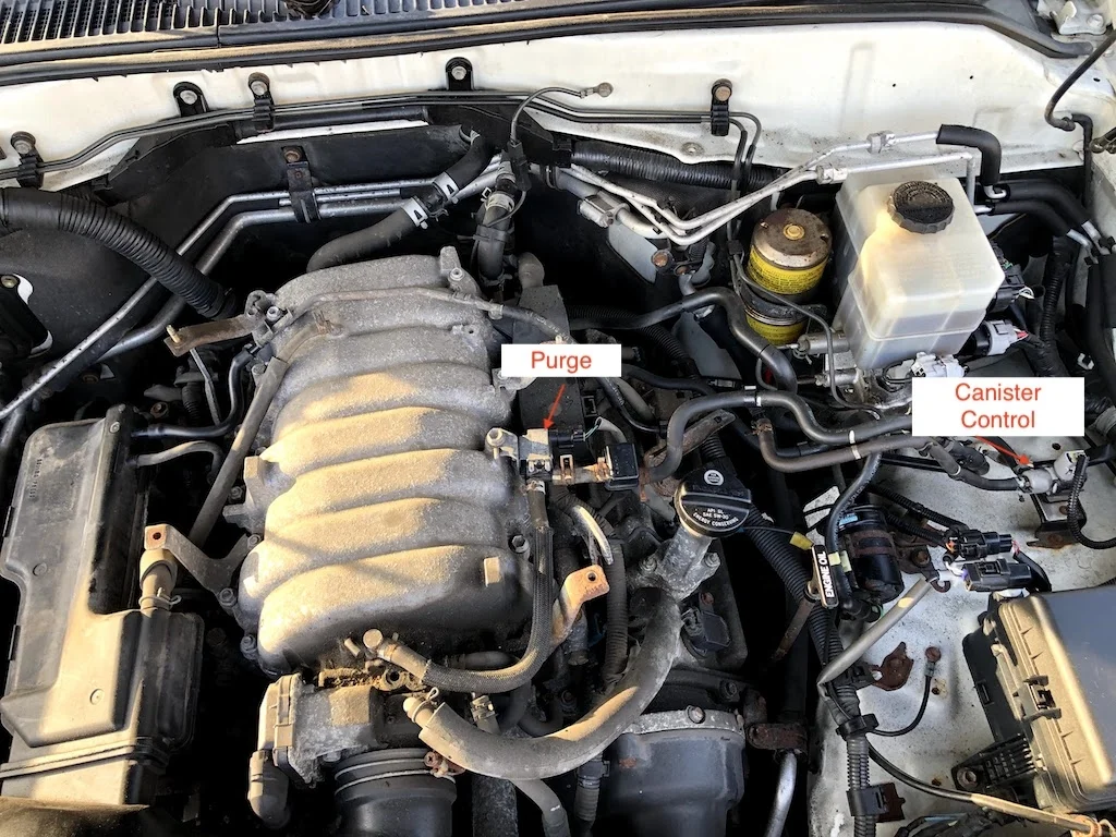

First, let's make sure the naming is consistent:
1. Purge valve (or VSV - Vacuum Switching Valve) - This is on the engine (intake) and controls pulling air from the charcoal canister into the engine. This is part number 25860-50100
2. Canister control valve - This is located on the fender and pulls fresh air from the air intake. Part number 90910-12261
3. Tank bypass valve - This one sits on the charcoal canister and is the link between the fuel tank and the charcoal canister.
I checked the individual operation of the purge and canister control valve using TS and they turn on and off just fine. However, with the car running, and the purge valve closed, it would occasionally pull air every few seconds. I checked by disconnecting the hose coming from the canister and putting my finger on the valve. This led me to believe that the purge valve is not sealing correctly.
I got a new purge valve, and that showed the same behavior! With the car running it seems the engine pulls really hard and the purge valve does not stay perfectly sealed. I think this may not be an issue, because the job of the purge valve is to seal the system when the car is off. What do people think? What're the chances that two new purge valves are both faulty?
Oh and the canister control valve does the same thing. With the car running, it also sucks in air every few seconds when closed through TS. Again, this leads me to believe this is normal behavior for both these valves.
