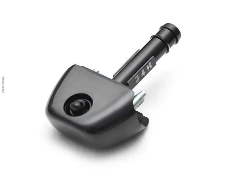

I've been looking for a replacement pair of nozzles for the headlamp cleaner/washer on my J78 Prado.
I've tried everywhere: Amayama, BE FORWARD, Cruiser Outfitters, Toyota DBX, binmahmoodstores, Mega Zip, Mudrak, you name it. I cannot find part# 85044-60011 ANYWHERE.
Oddly enough, my Land Cruiser has all of the hardware for the headlight washers, but the grille that the car was imported with did not have washer nozzle cutouts. I have since replaced the grille with one that does have the cutouts, but now I can't locate the nozzles!
Any assistance would be greatly appreciated. I'd even consider a finder's fee if someone can locate a set for me.
Thanks in advance, everyone-

Thanks for following up! I have the nozzle but so far no luck in getting them working, albeit, haven't tried too hard at this point. Any tips from when you were doing install?
