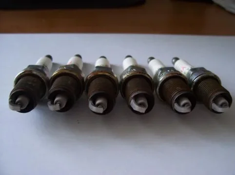

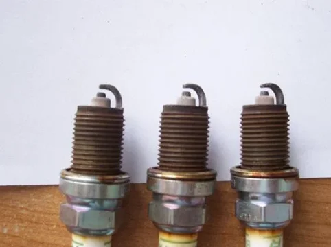

Hi, all. My 80 is a 94 with 158k currently on it. Changed my plugs last Saturday (October 28, 2006) and I thought they look good. I even compared them with pics from a link given by Cary on https://forum.ih8mud.com/showthread.php?t=117311&highlight=spark+plugs but not too sure about what I see especially that I was losing coolant. I had a leaking radiator, though.
These plugs (NGK BKR5EYA) were installed on June 28, 2005 and were 'subjected' to two long drives amounting to ~ 10K Kms.
Pic 1: Plugs all in a row (Left to right: Plugs 1 to 6)
Pic 2: Plugs 1, 2, 3
Pic 3: Plugs 4, 5, 6
Appreciate any inputs. If anything, I'd like to know that I'm not burning coolant. As mentioned somewhere in the forum, it (ie HG) will be a matter of when but would like to 'postpone' that since I still need to save up for that. :)

Look great, it doesn't get any better than this!
Look brandy new!
Thanks, gentlemen. It is nice to know that I'm 'safe' as of yet.
They look good.:cheers: Why did you replace them?

Quote Landtank: ...plug #4 looks to be a little tight on the gap
Rick, any reason to be alarmed?
Regards.
Don't worry all the gaps look fine. I don't know what Landtank is sniffing.
If you were burning coolant the plug would look very clean with a slight grey from the steam cleaning.

Just kidding, no way you could tell that from what you posted. They look fine.

Many thanks, folks. I feel relieved that my engine is still very much okay as far as the HG is concerned. Hopefully, it would hold much, much longer.
