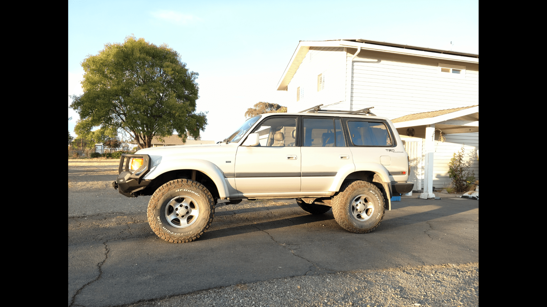

@BillyGoatMTB here is how my truck is currently sitting. 2.5vt front and rear and 315s. Right around 3" of lift on all 4 corners and a level stance. I am very happy with how this suspension turned out. I have an alignment scheduled in early Jan to get everything perfectly dialed in.
View attachment 2518065View attachment 2518066
What brand of tires and do you like the way they ride?
