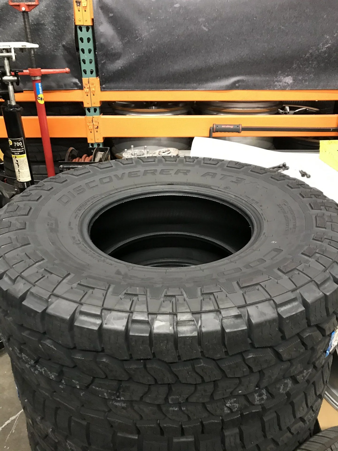

What brand of tires and do you like the way they ride?
Thx
Goodyear Duratracs. I'm on my 3rd set at this point. I don't have any complains about their road manners. They work very well in the snow and we see our fair share up here so that is a bonus for me.
This 3rd set seems to be wearing faster and is starting to get pretty loud. I may stick with them or go with something else next round. Still not sure. I think I have around 45k on them.

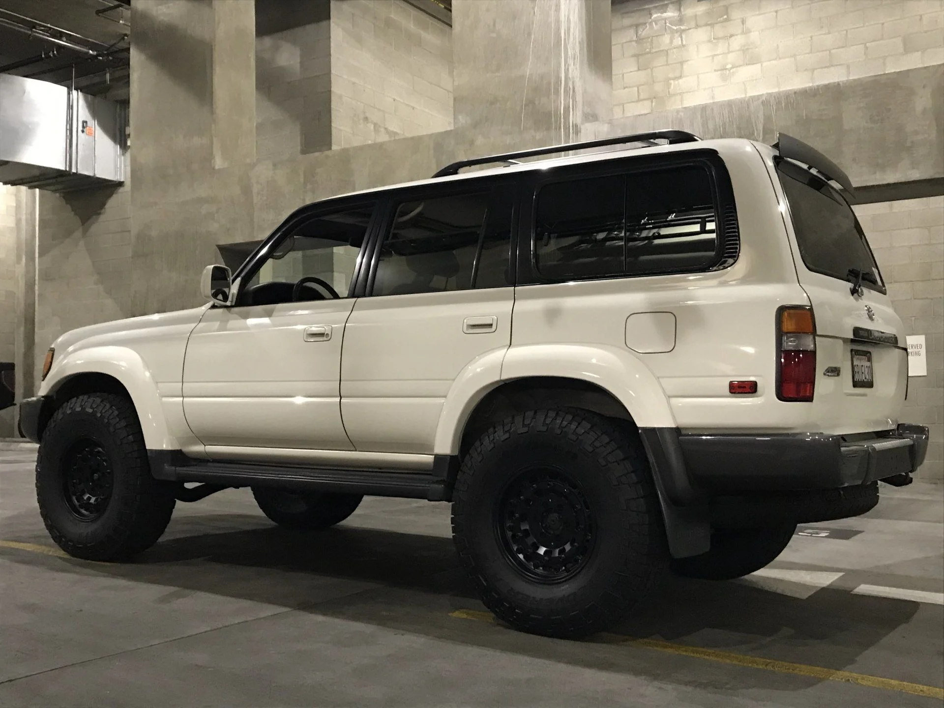

I made the move to 37s. Rides better than the 35s + 4.88s.
Without the Delta arms, I’d rub on the body on turns which would’ve been a deal breaker. Many fail to account for the fact that caster plates shorten your wheelbase.
