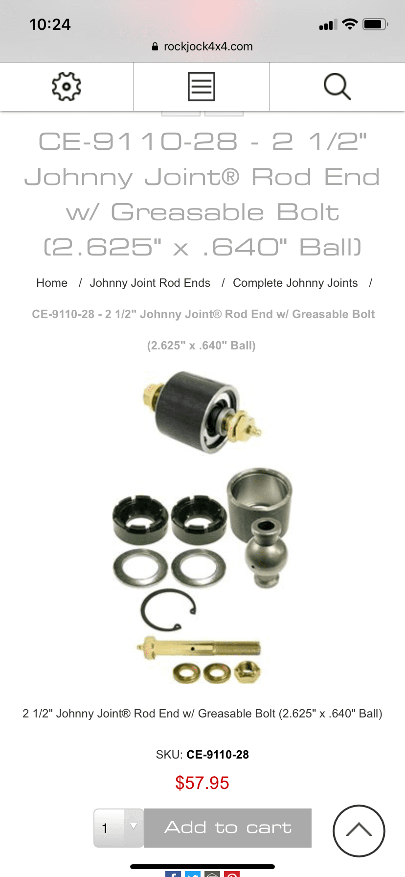

You mentioned Heim joints earlier in this thread but I never saw them mentioned again. Would replacing the frame end bushing with a Heim joint give more flex?
What about Johnny Joints like this?

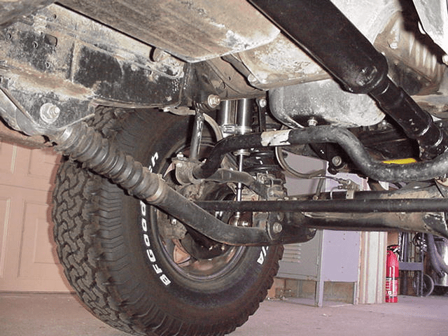

My issue is my friends budget built XJ just outflexed me on a ATI ramp last weekend so I need to get the most amount of flex I can without going linked. Im running 4” lift with caster plates on my HDJ81

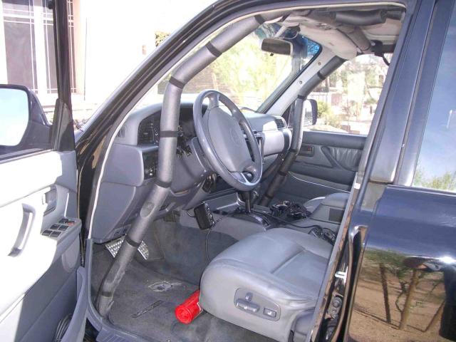

Years back I ran wristed front control arms from South Africa. Lots of tested showed the wristed arms did not help or hinder flex.
That's some OG go-fast stuff right there. What year was that?
2003-2004 The list of one offs is large...when was the last time you saw a full cage in an 80 :grinpimp: Art
