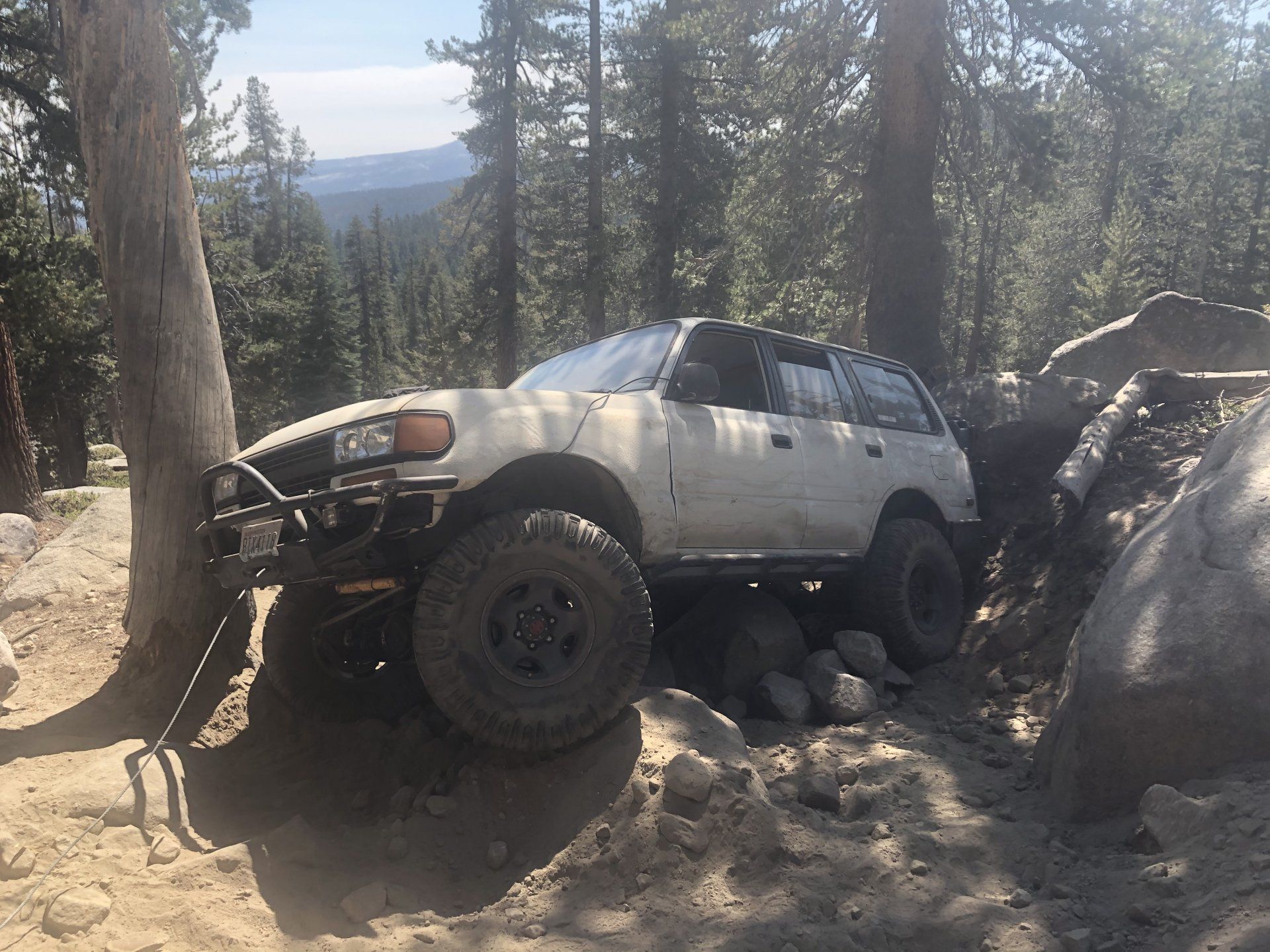

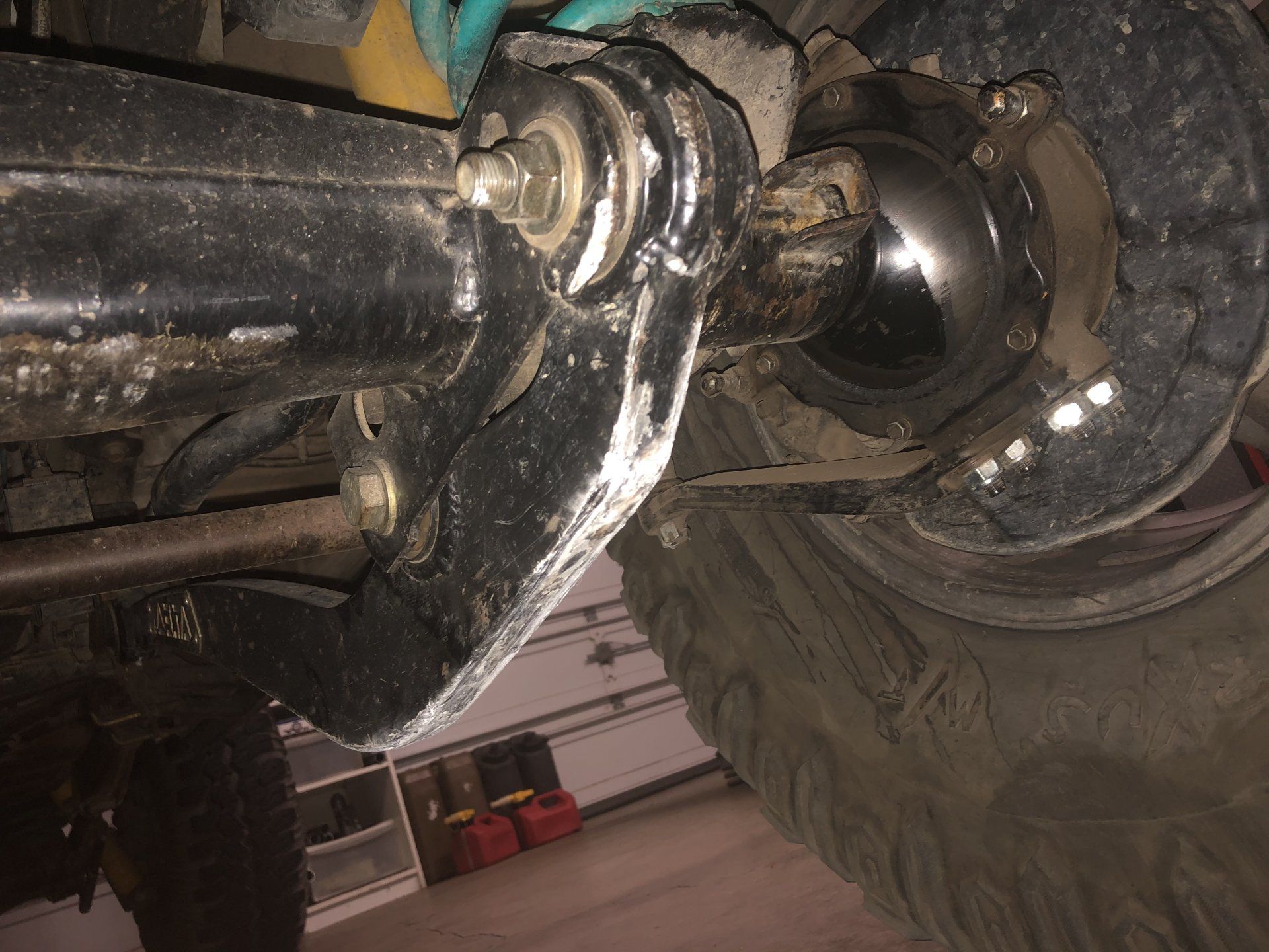

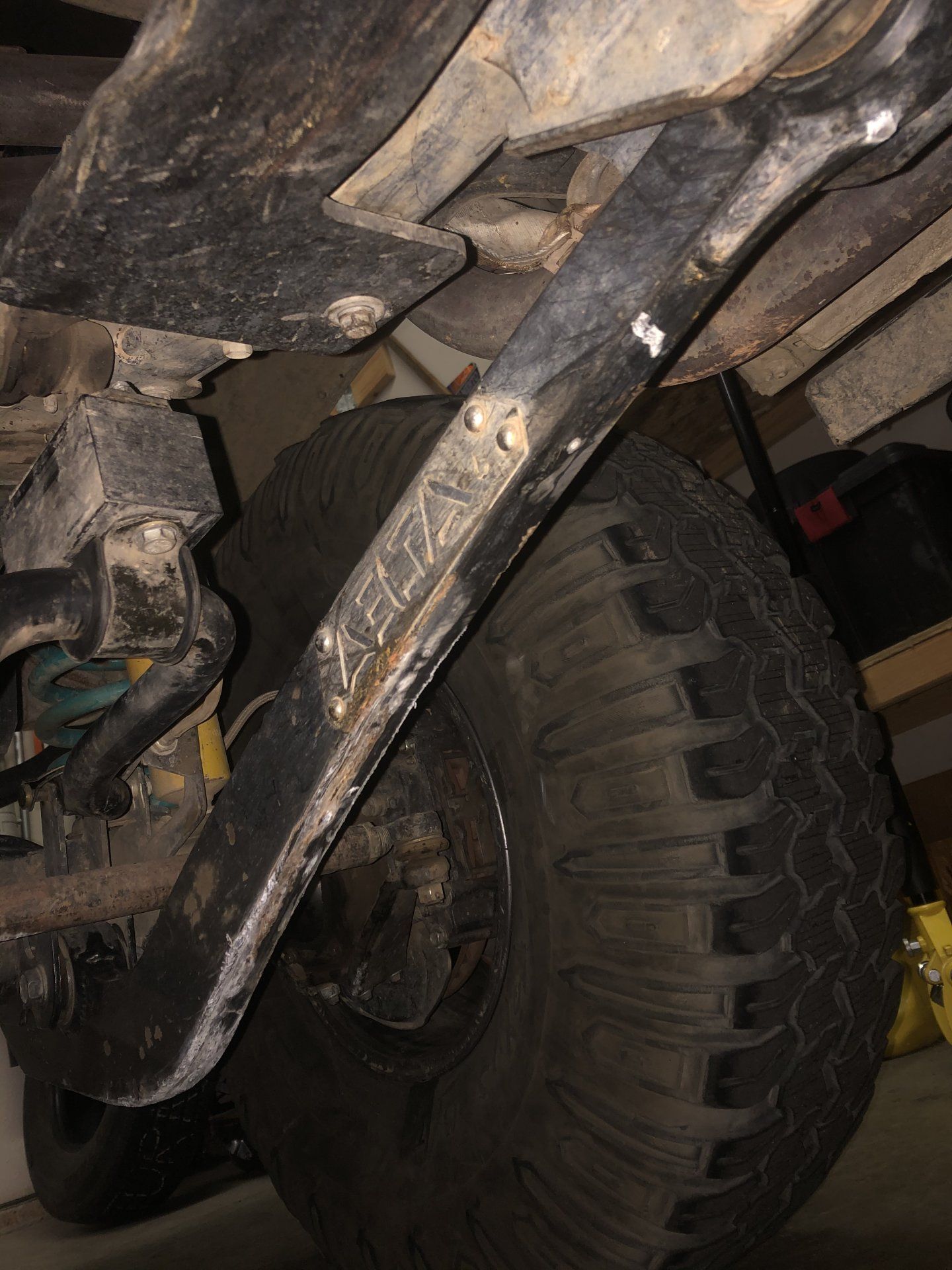

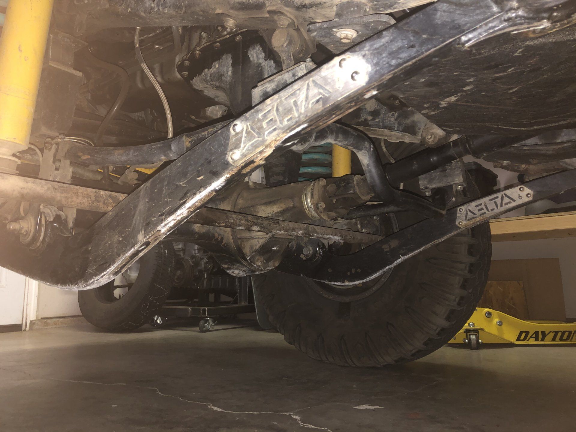

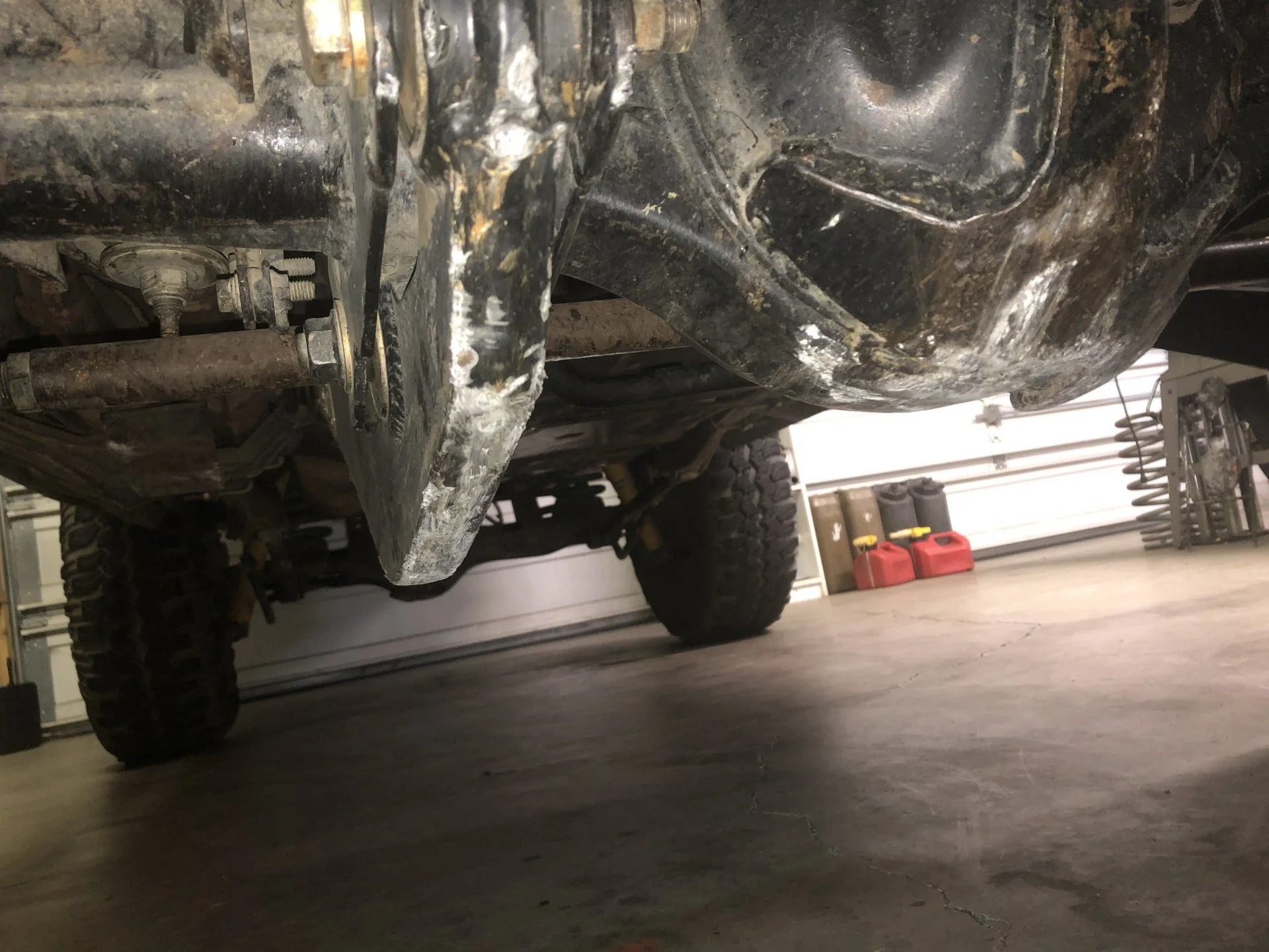

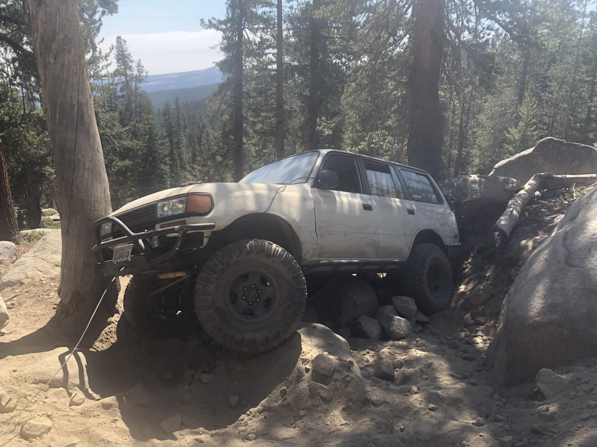

Finally got down to some testing on the rocks in CA on the Dusy Ershim trail recently. The Delta arms took some hard hits and don’t look or feel as though they were affected save the cosmetic improvements. :hillbilly:

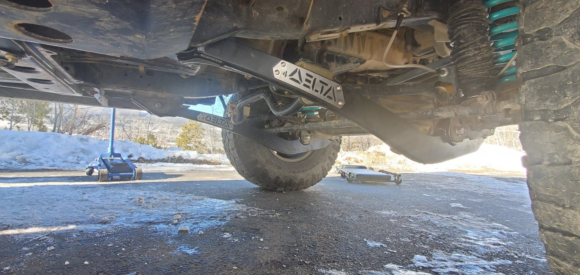

Got the 4" arms installed today. 2.5" Dobinsons variables up front giving me about 3" of lift.
I ran around town and a few brief trips on the highway for a week without any correction. Its amazing how much a small change in geometry effects handling. I feel comfortable with one hand on rhe wheel at 70 again. Big improvement and awesome product.

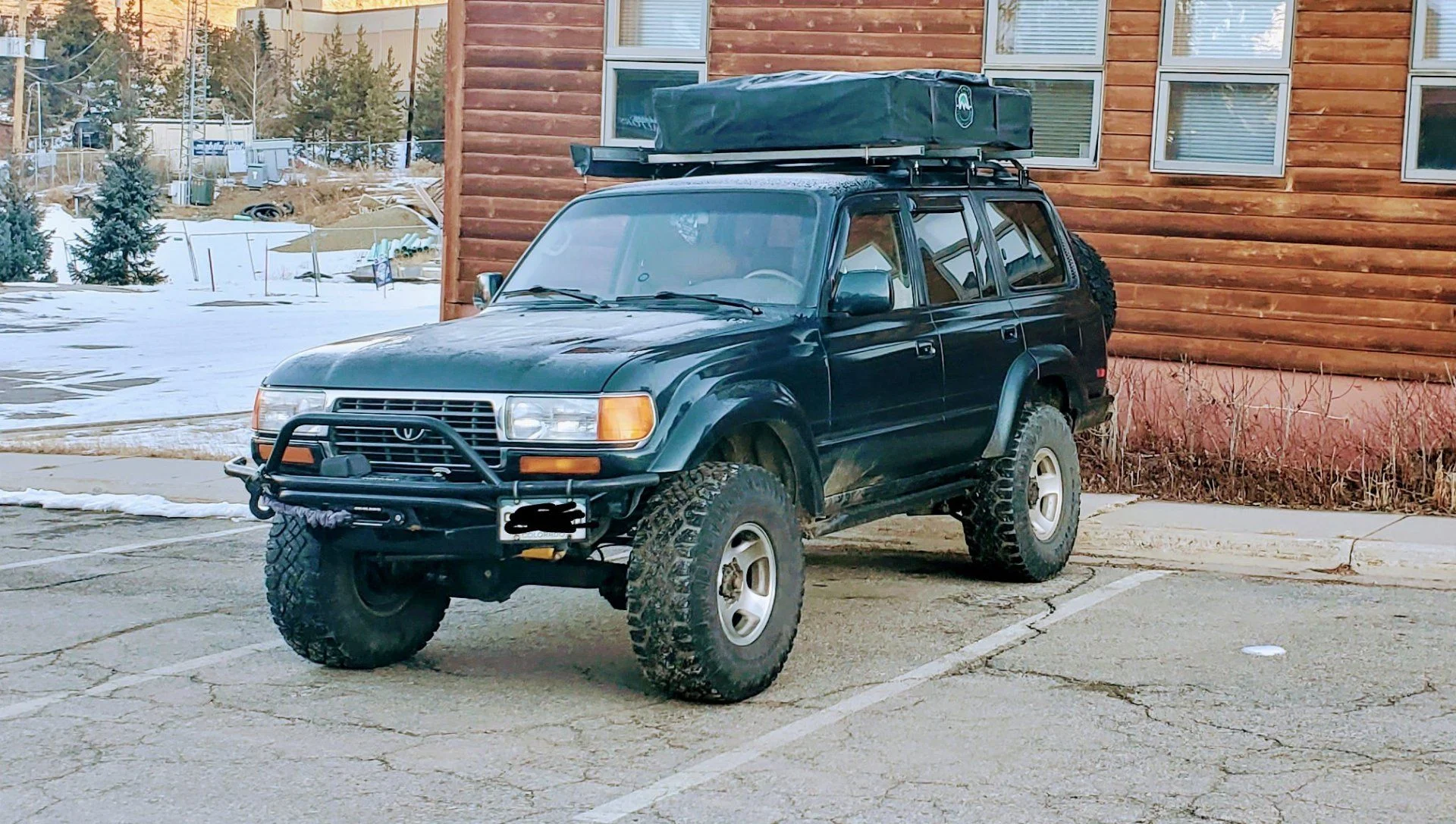

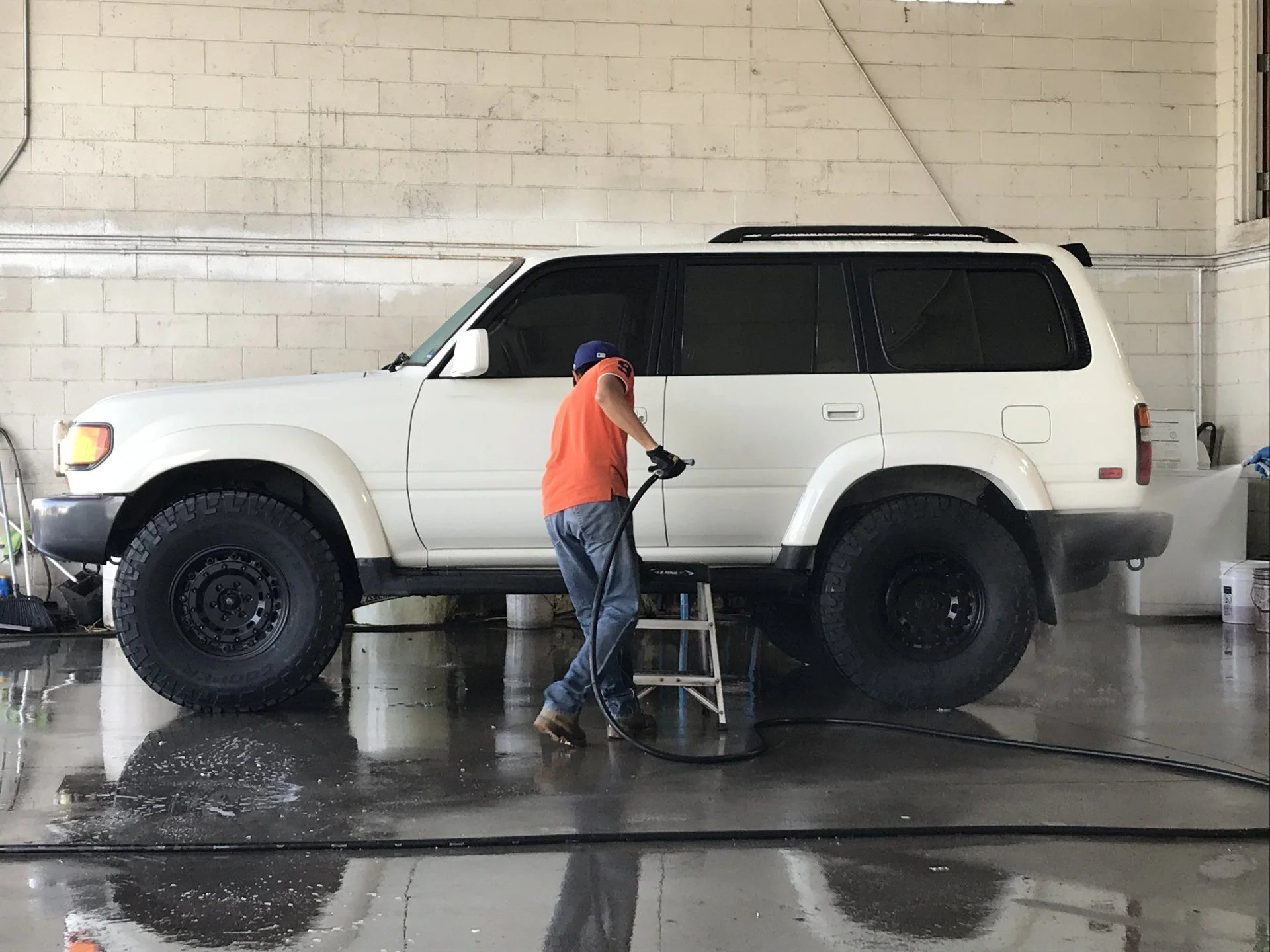

@BillyGoatMTB here is how my truck is currently sitting. 2.5vt front and rear and 315s. Right around 3" of lift on all 4 corners and a level stance. I am very happy with how this suspension turned out. I have an alignment scheduled in early Jan to get everything perfectly dialed in.

Looks mean! For reference, here's mine with 4" Delta arms and their panhard bracket.
2.5" OME lift, mediums / 37x12.5x17 / 4 degree caster L and R
Looking good
I almost went 37 but was worried my 3+ lift and all the Delta goodies wouldn't prevent massive rubbing.
I'm also considering re-gearing to 4:88 with my 315/75's I imagine 37's would swamp the 80?
How's your articulation? Did you regear?
