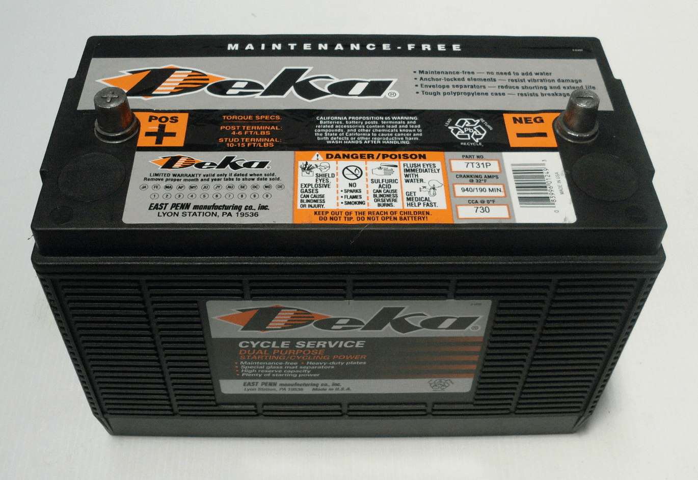

I think I may have found my battery. I spoke to Deka and they suggested I look at the 7T31P, this configuration is from their Heavy-Duty Commercial Severe Service/Dual Purpose category and since it is not marine it is supplied with regular center posts.
It is a 100ah - 730CCA - 225min@ 23A/190min@ 25A RC - 62lbs
This is an interesting option as it solves for the post/stud issue with the marine battery and it provides slightly more capacity as well as gaining additional CCA. All for less than $200.
I'm hopeful this might be the FLA winner for those of us looking for a single group 31 battery solution, it's on order.

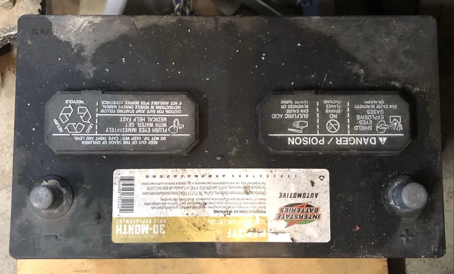

Does it have reverse posts like the Group 27F normally used in the 200? If not, you may need to mess with terminal extensions, etc. The factory cables are pretty limited in how far they can move.
I've never fully understood why people refer to our OEM group27 as having reversed posts, the positive is on the left looking at the battery from the front on most batteries right? If I look at the Panasonic OEM the positive is on the left like the Deka below does this mean the Deka is reverse posts as well? I'm not sure on this point.
It is more relevant when the posts are further to one side of the battery like on the stock battery model.
I agree that the posts on the Deka are centered rather than located towards the back of the battery and I'll need some Slee or other extensions for sure. It's also good for others that might come across this post acknowledge without those extensions and some small mods to the battery tray/holdown it's not "plug and play".

It's taken a fair bit of research of manufacturer specs and four calls to various customer service tech lines to get to this point. The Deka retailer told me today he hasn't sold that battery in four years working there so it will come from the factory. It's definitely not an on the shelf item but I was having a pretty hard time finding a high quality non-AGM dual purpose recommendation in any forum threads.
My requirements were:
Ability to fully charge from OEM alternator (i.e. not AGM)
Designed for dual purpose starting/deep cycle use
Min 100ah and the highest RC I could find
High quality trusted manufacturer
For others looking for something very similar but needing it in stock the DP31CS has just a little lower stats and has center studs that can be converted using adapters like @Sandroad posted above. That one is priced at $175 right now from Deka.
The Deka Marine Master batts are interesting.
That's what I thought too and I thought I'd have to deal with the awkward marine connection layout of the two studs/two posts to get what I needed but Deka pointed me to this Commercial Dual Purpose with even better stats and just single posts. Win-win.
The 7T31P is the one I'm going to try and the DP31CS is the one I'd replace it with if it was an emergency and I needed one in stock.
