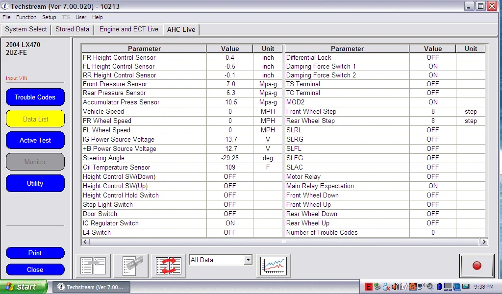

Below is my one of my three pulls of data post ARB Front Bumper (no winch) installation. Overall, it doesn't look too bad. My current setup is that I have relatively new rear OEM springs, 30mm spacers, new Pleiades spheres and recent flush.
I'm planning to re-measure, double-checking FR/FL, and then put 1-turn on the TBs to make it within spec.
Planning to go for a rear bumper and aux fuel tank in the near future.

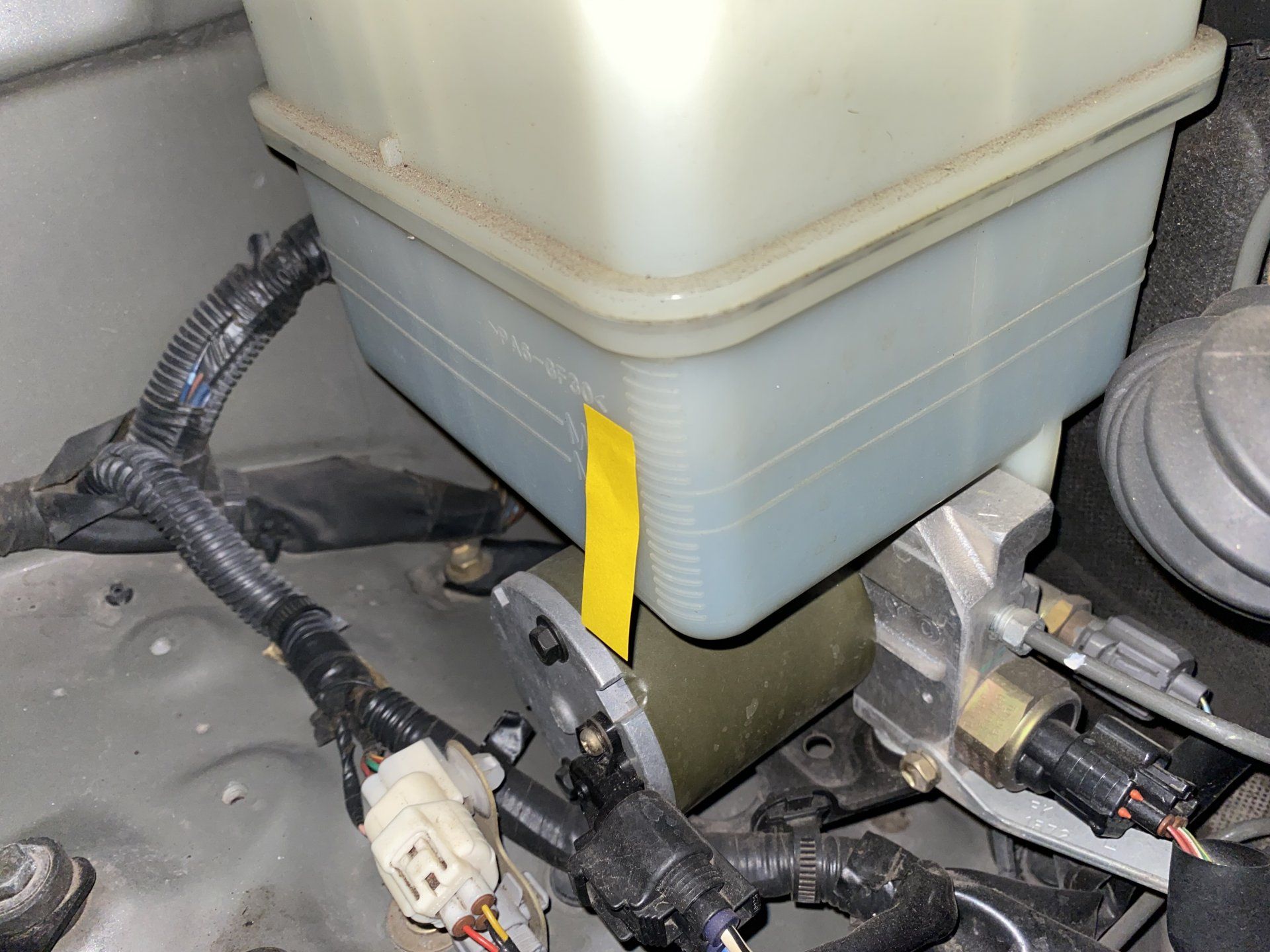

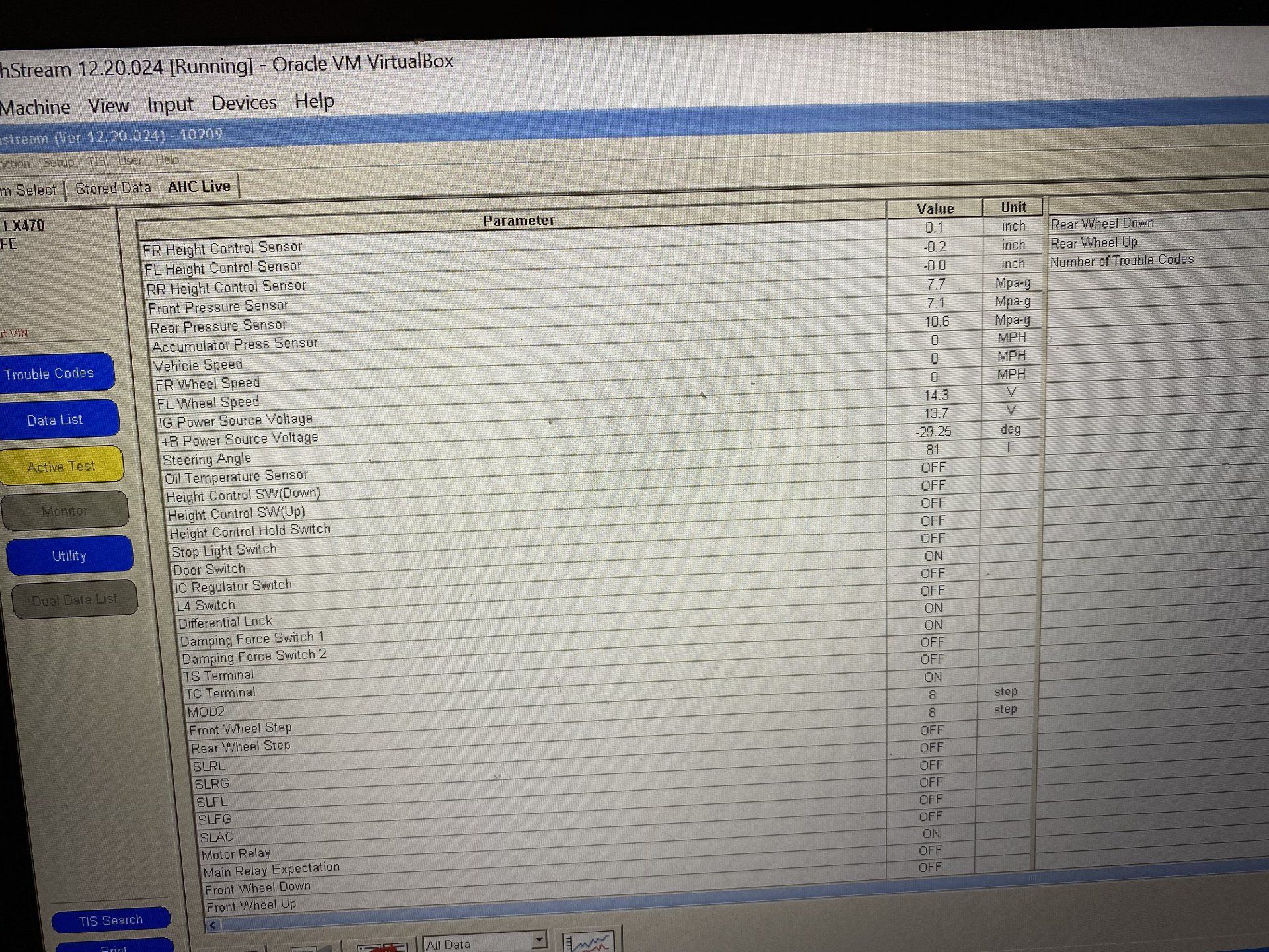

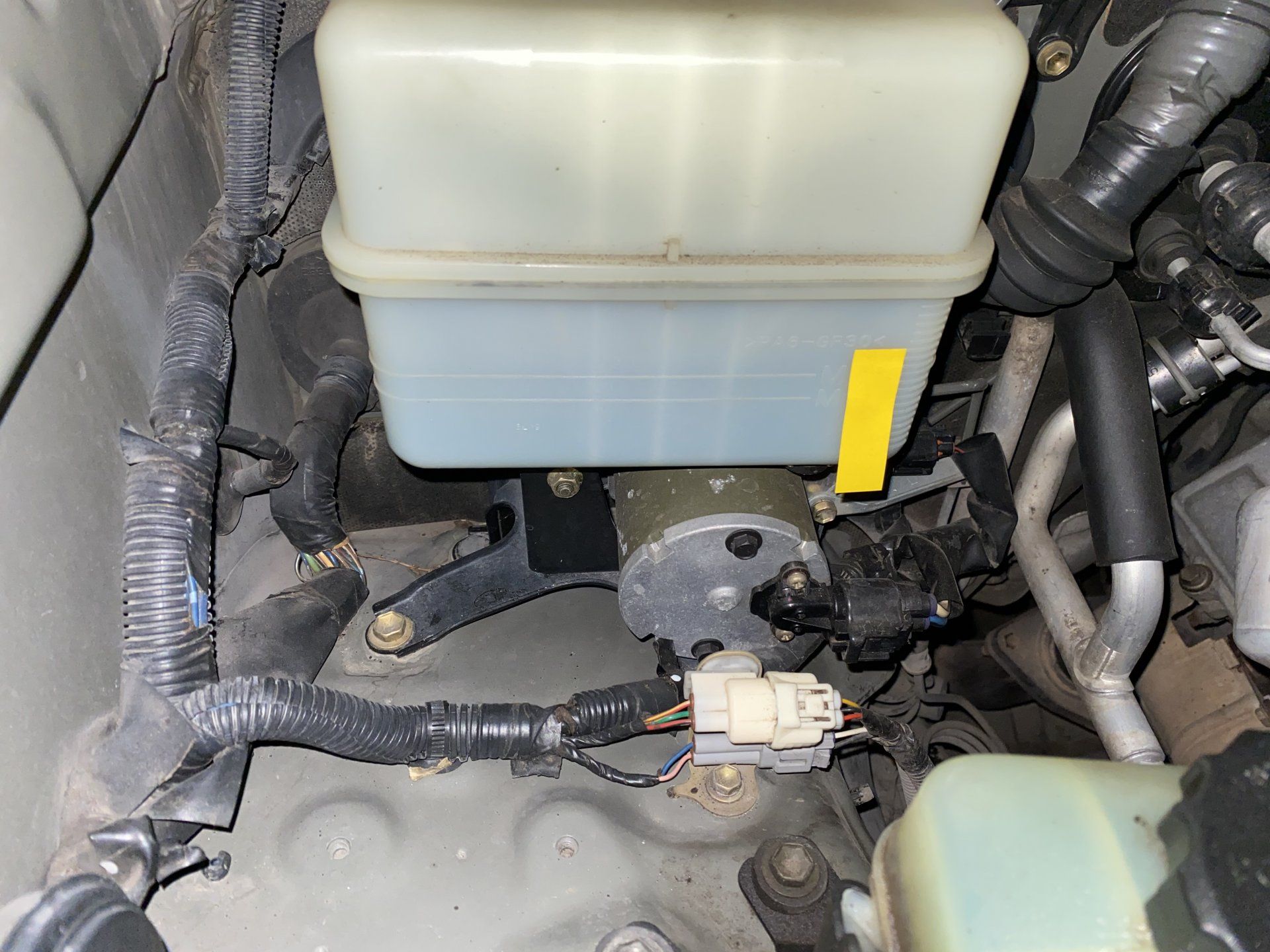

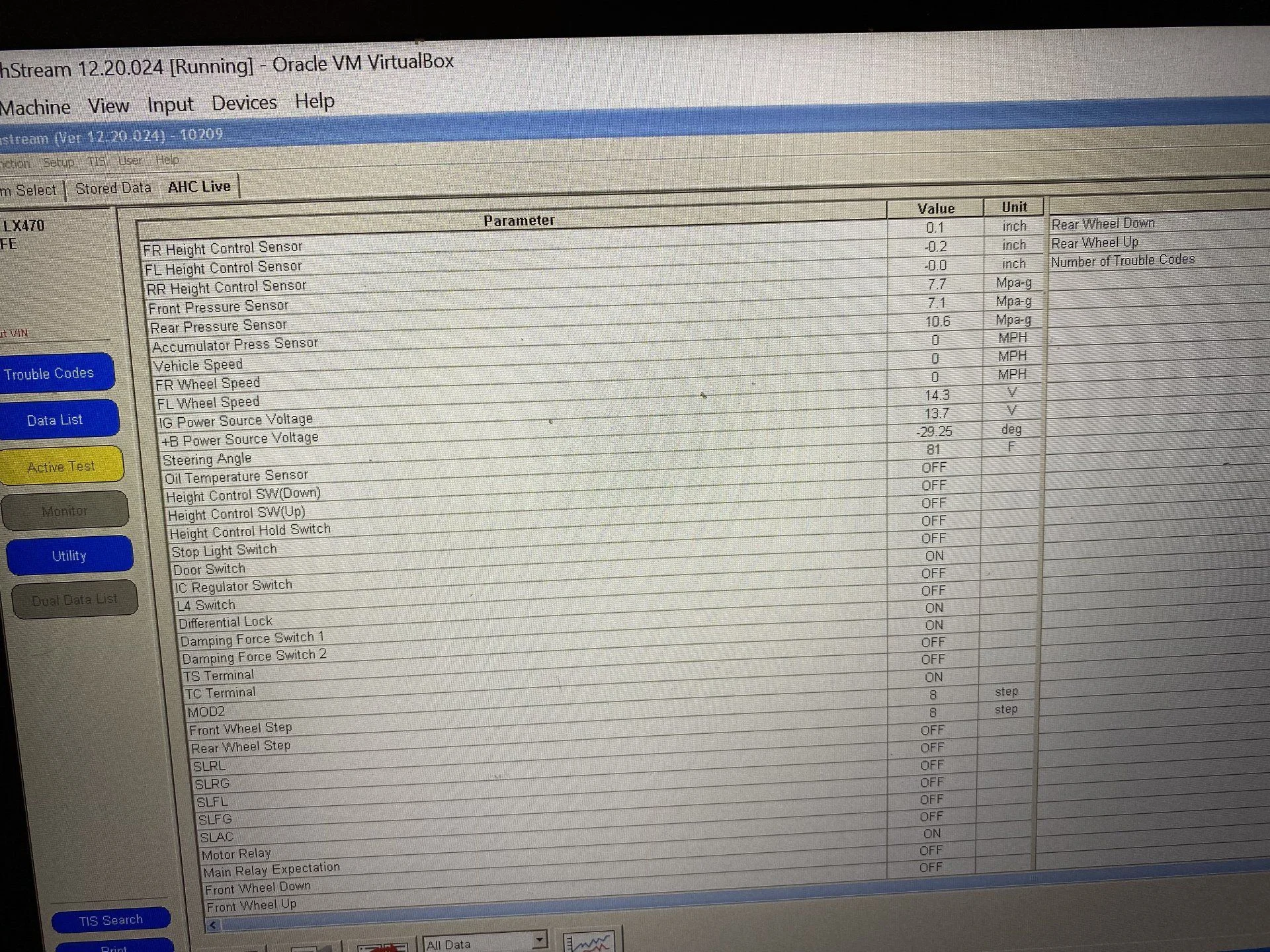

I have recently imported my 287k miles lx470 from the states and spent some time on these forums trying to catch up. My ride seems “ok”, but when I do tech stream and the reservoir check they seem to be worn. The right shock and fluid was changed by a Toyota dealer in June 19 before it was put for sale.
I would appreciate if anyone could comment whether my readings calls for a replacement.
Low setting
normal
What do you mean by "worn"? How many graduations do you get when doing that test?
