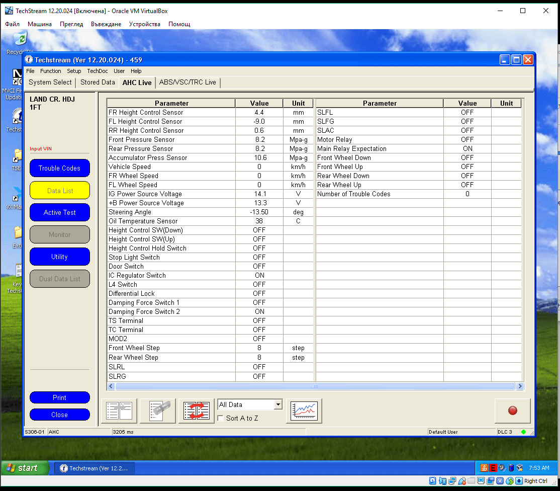

I am attaching a screenshot of my live data from TechStream:
The attached screenshot is on a flat level surface, with only me in the car and almost empty tank.
Today, I will perform another test with a full tank and will keep you posted.
What bothers me the most is the difference in the height control sensors:
FR: 4.4mm
FL: -9.0mm
RR: 0.6mm
I guess I have to play around with the height sensors?
If so, what are the perfect measures I must chase? Three zeros?
However, I also performed a double-check with the tape and it indeed proved the difference.
I will attach later the exact data from the tape.
Cheers,
Azi

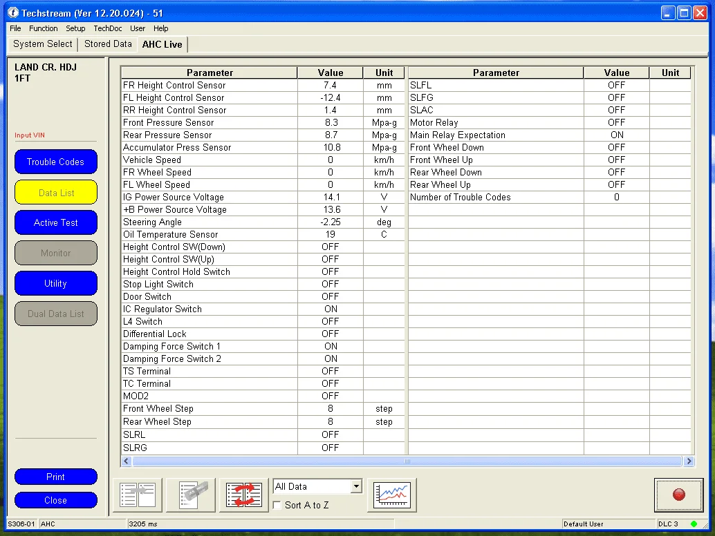

UPDATE:
Just performed another test will full tank - attaching the results:
The height control sensors now are even weirder.
FR: 7,4mm
FL: -12,4mm
R: 1,4mm

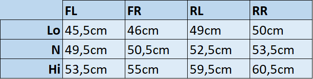

Also, I re-measured the center cap to fender distance and it looks good.
My first measures were wrong - bottom of the rim to fender, not center cap to fender.
Attaching the results of the measurements:
Converted to inches and having in mind the manufacturer's numbers - Front 19,75" / Rear 20,5" it looks OK.
There is a slight 1cm difference from left and right (0,39" - less than a half-inch) in both rear and front, but still almost at the right height:
Front: 19,48"
Rear: 19,88"

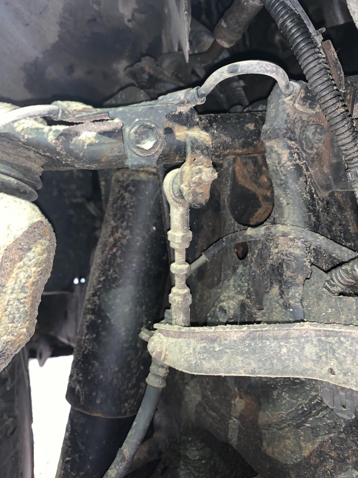

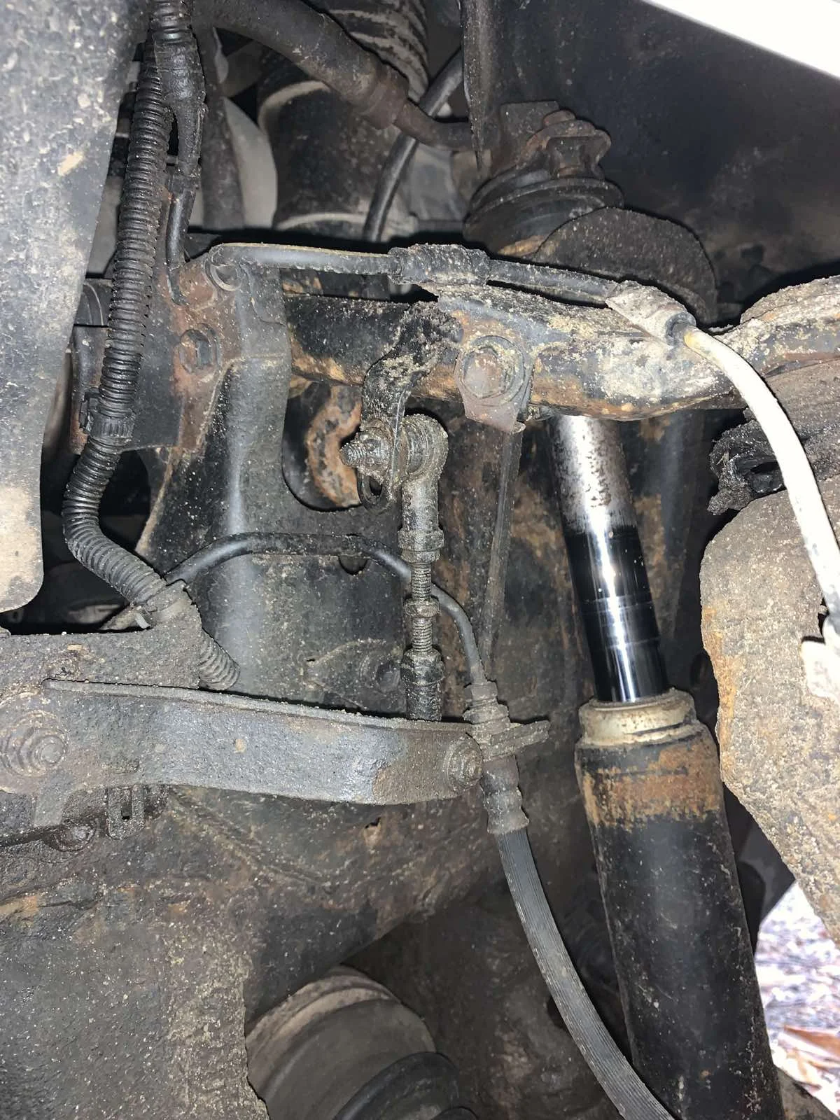

Also, I took a few photos of both front height control sensors and they look OK, not damaged/twisted.
Attaching the photos:
Front left (Driver's side):
and front right (passenger's side)
Any guidance would be appreciated in order to solve the bouncy ride...
FR: 4.4mm
FL: -9.0mm
RR: 0.6mm
Cheers,
Azi
UPDATE:
FR: 7,4mm
FL: -12,4mm
R: 1,4mm
Front: 19,48"
Rear: 19,88"
FR: 4.4mm
FL: -9.0mm
RR: 0.6mm
Cheers,
Azi
UPDATE:
FR: 7,4mm
FL: -12,4mm
R: 1,4mm
Front: 19,48"
Rear: 19,88"

Actually you got a point there, I was able to get close to zero average value on all three sensors by tweaking and modifying the FL sensor. I ran out of threaded part on FL adjuster about 2mm before zero, I had to modify and lengthen the threaded part to achieve zero on FL sensor. After the mods on FL threaded part and able to achieve zero reading, the ride was totally transformed for the better but deep inside I knew that something was not right due to the fact that I had to modify FL sensor’s threaded part to achieve zero reading on N position, yet I chose to ignore it and bask in the comfort of the cruiser. And by the way, my cruiser is still totally stock with stock 18” rims and BFG tires, so no extra weight on it.
Just a couple of hours ago when playing with my truck I did notice that when on L position the height sensors reading are all over the place with large discrepancy between FL-FR sensors reading, it is only almost flat out equal on all three readings when on N position. I also did FSM procedure of 3 AA batteries voltage test on both FL-FR sensors and found out that both are showing different voltages to each other on Max H - N - Max L sensor arm position. Having found the spirit to work on the AHC again, today I also noticed that both my front height are not 50 mm / 19.5” anymore!!!! Both are 15mm lower!!! I did not notice it until today because the ride is still ooohhhh so comfortable 🤣 I swear I did at least 10 L-N cycles with plenty of ride in between and always settling itself at 50mm/19.5” consistently when I last set it up a few weeks ago. Realizing what happened today, I think my case of slow raising AHC is similar to yours and it is about time for new sensors on all corners.

How important is it to maintain REAR height sensor reading to be as close as possible to the front? I can set my rear height to factory spec easily but on the position that give proper height the sensor reading is always far off from both front sensors.
I really am starting to really hate this AHC thingy, crazy never ending problems.
What??? If the car is on a level surface, (physical) heights and pressures in spec, and then move from Lo to N, all the 3 sensors should be at zero +/- 5 mm. That's the whole purpose of the AHC. What sensor height readings do you get?
