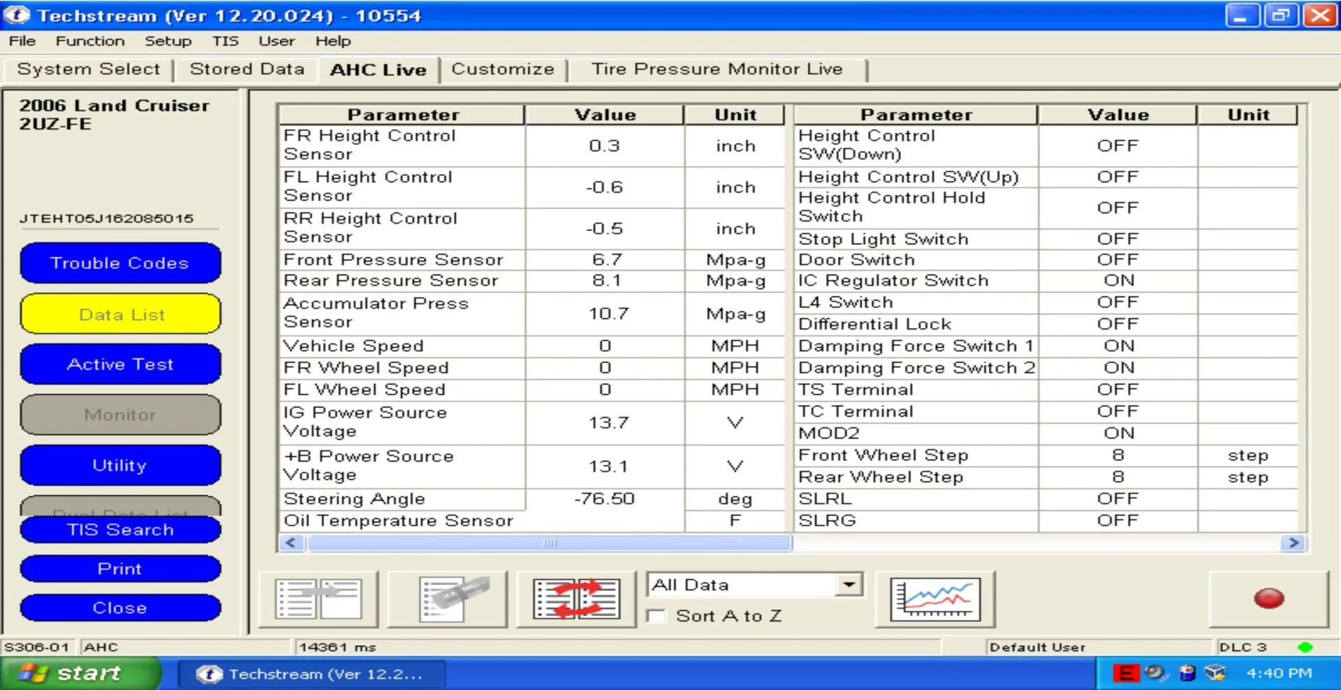

Last year, I adjusted TBs, cross leveled, exchanged fluid, etc and got the pressures back within spec. I was without Techstream for a few months and noticed the ride quality degrading especially in the rear. When I got Techstream working and was able to read pressures, the rear pressure had increased up to 7.8. I ordered new LC AHC springs and installed a couple of weeks ago. Pressure is still on the high side at 7.4. Ride is improved, but I’d still like to get the pressure lower to be in spec.
What should I try next to reduce rear pressure? Spacers? Any other ideas?

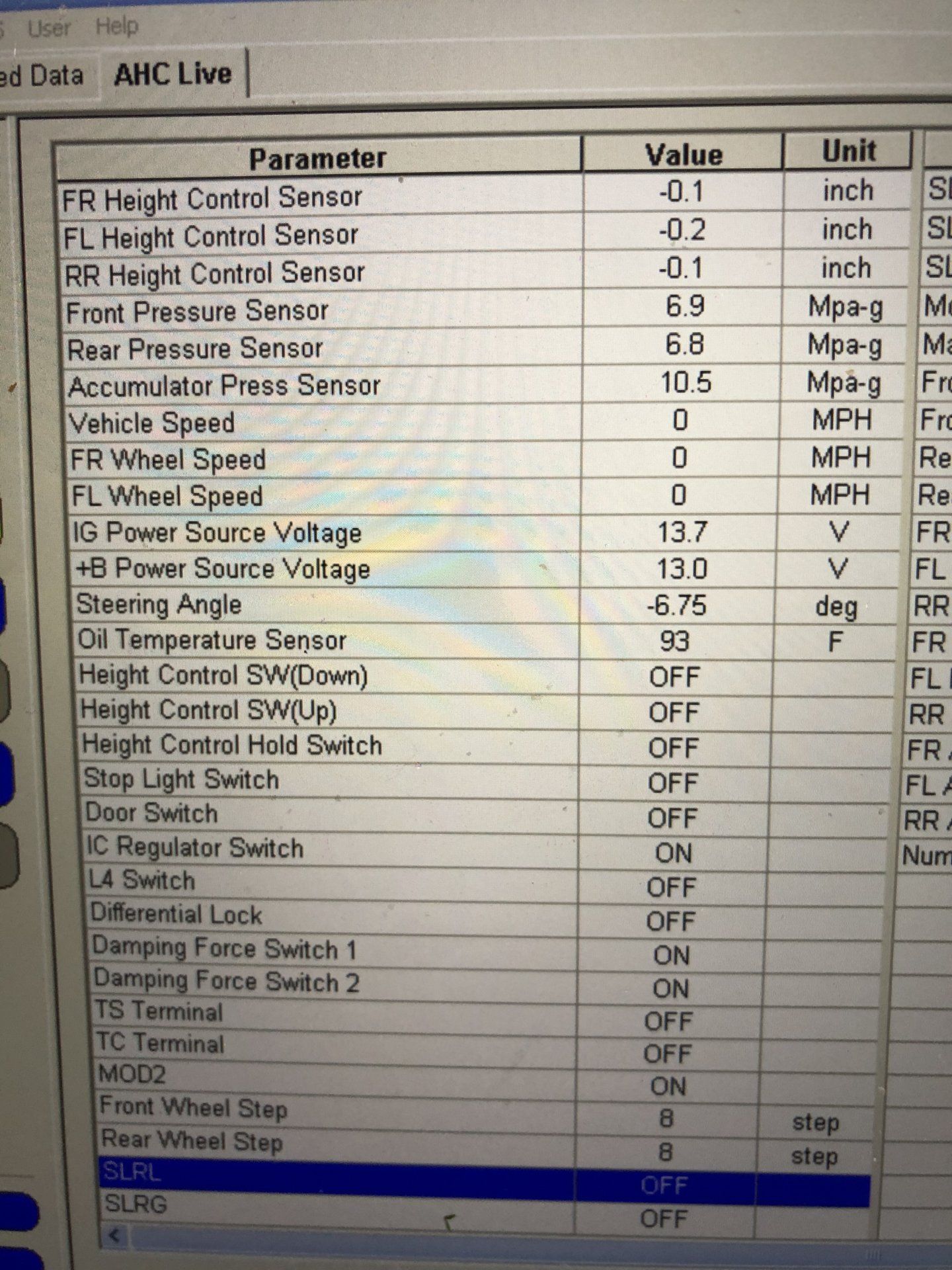

Just an update on my experience with new OEM LC AHC springs.
It’s been three weeks since they were installed and my rear pressures have continued to fall. I’ve been adjusting and checking pressures in Techstream weekly and am down to 6.8 in the rear.
Not sure why the pressures have been dropping, but I went from L to N three times and received the same readings.

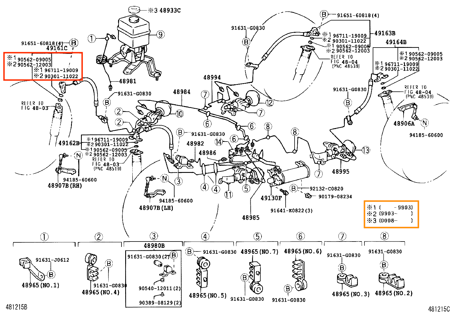

I need some help identifying the part numbers for the O-ring and washer that go between the shock absorber (ok hydraulic strut/ram) and the hose.
I am looking at the diesel equivalent of this diagram:
(Diesel one is here: 480651N.png, same part numbers for the o-rings and washers)
The o-ring and washer (red rectangle) have two variants, depending on the numbers in the orange rectangle. What are those numbers? How do I pick the right one?
The two different sets of o-rings and washers have completely different part numbers, different prices, so they must be different...
That's the build year and month. March 1999 is the cutoff. (I hope that's not your build month)
