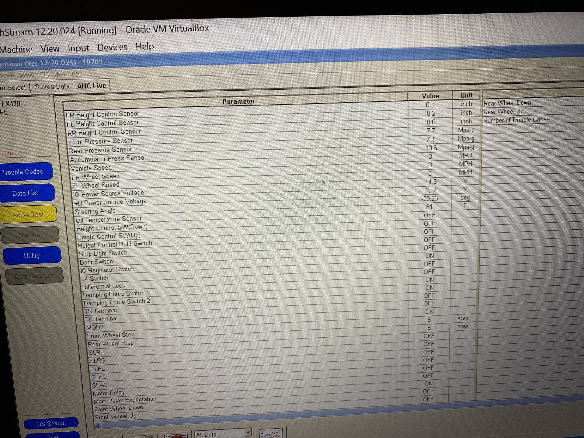

Finally got my techstream running and front pressures were 8.4 (sheesh) and rear was 7.7. Going to have to do some cranking on the front and im planning on removing the third row anyways and seeing what the rear is like.

Is it normal to get a zero reading for the Accumulator Pressure Sensor while the Temp Sensor is unplugged? I've consistently gotten ~10, until I disconnect the rear sensor.
