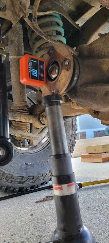

I will double check my wheel bearings. My previous wheel bearings became loose due to spindle wear. That may be the case again. I have new spindles sitting on the shelf ready to be installed. I confirmed that I ordered my spindle kit in 2022 when I found wear on the spindles during a knuckle rebuild.
For testing cracks I had the exact same idea but one extra step. Someone turns the wheel back and forth but I am going to put a finger where cracks normally would appear. I should be able to feel the two surfaces move independent of each other even if I can't see it.

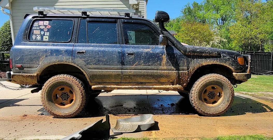

Great suggestions but I think I've fixed it.
It turned out to be a multifaceted issue.
  • Bearings were not at the torque that I set them at originally. Pushing and pulling the wheel in a variety of different ways I found the ever so slightest bump of a loose wheel bearing. Bearings were tightened up and truck driven. I thought it was sorted but on the last quarter mile of my test drive I got the start of death wobble. It seemed reduced but it was also at slow speed.
  • @roadstr6 suggested the panhard bar. I checked the bolts and found the frame side bolt was not as tight as I expected. I tightened both panhard bolts and checked radius arm bolts and bushings. I experienced some intermittent vibrations on my test drive but nothing close to death wobble.
  • Finally I took the Cruiser to Discount Tire and had the wheels/tires balanced. They did find that the previous balancing job was not done correctly, and also found a slight hop in one of the tires. Unfortunately after 6 years, there's no warranty left. The Cruiser seems to ride smoother and braking is solid and consistent.
I've put 50+ miles on the Cruiser in a variety of city/hwy drivings with lots of braking. No hint as wobbling. I have a suspicion that when we got home from our last camping trip, I used the pressure washer and blew off some of the wheel weights stuck to the inside of the wheels. Discount Tire doesn't clean the surface before sticking on wheel weights and some might not have been adhered to the surface properly.
