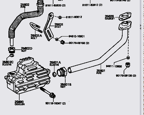

Mmm, I think there is a bushing that goes around the pipe, that's compressed by the nut to seal it. Pull up the parts diagram on toyodiy to see what's in there.
On my laptop now. The sleeve is what I was thinking of, part 90410-25041. Is that there and not crushed to oblivion?
Man.. I’m not seeing part 90410-25041 on here. However, I didn’t take the big nut (26801B) off because the pipe just slid out when the stud from the manifold hit it when I was wiggling the manifold out. I assume there is no sleeve or at least not functioning.
On where? The part number for the sleeve is diagram item number 26601A.
Dude...:lol: Part number 90410-25041 is the sleeve circled in red, with the red pointers. It is item 26601A in the parts diagram. I don't know why some items have full parts numbers, and some have abbreviated numbers (like the sleeve) but they do.
So maybe I need a class on deciphering part numbers. Using the diagram provided, I cannot see where 90410-25041 came from in any way in reference to 26601A.
I figured the part number and a reference pic of the part I described would be enough. NBD, next time I'll fully explain.
Back to the problem at hand. You have a leak at that union. Was the sleeve present when you reassembled the EGR tube into the cooling block? If not (make sure to double-check) then that's the part you need.
