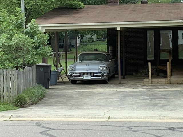

Speaking of unmolested classics... I see this from my kitchen window every day. It belongs to the 80-something year old neighbor. I’ve never seen anyone else in the family take any interest in it. I’m not even exactly sure what year or model it is, but I want it more and more every day.
Looks to be a 58. That one I would RestoMod. In stock form those huge engines were gas hogs and a bit of a slug for the size. They also have a pretty sloppy suspension. They go for a whole lot more money with a modern engine and suspension. They are also a whole lot more fun to drive. Biggest expense on something like that would be a full re chrome. Probably in the $30K range just for all the exterior and interior chrome and doubtful you'd get that investment back. Hard to de chrome one though as the bumpers are a huge part of that. Once done they are over the top cool.
Looks to be a 58. That one I would RestoMod. In stock form those huge engines were gas hogs and a bit of a slug for the size. They go for a whole lot more money with a modern engine and suspension. They are also a whole lot more fun to drive. Biggest expense on something like that would be a full re chrome. Probably in thee $30K range just for all the exterior and interior chrome and doubtful you'd get that investment back. Hard to de chrome one though as the bumpers are a huge part of that. Once done they are over the top cool.
I had no idea re-chrome could cost that much. Just one more reason I don’t care for too much chrome.
Very few re chrome shops left out there due to EPA regulations. I am sure it can be done cheaper but top shelf chrome is big money.
