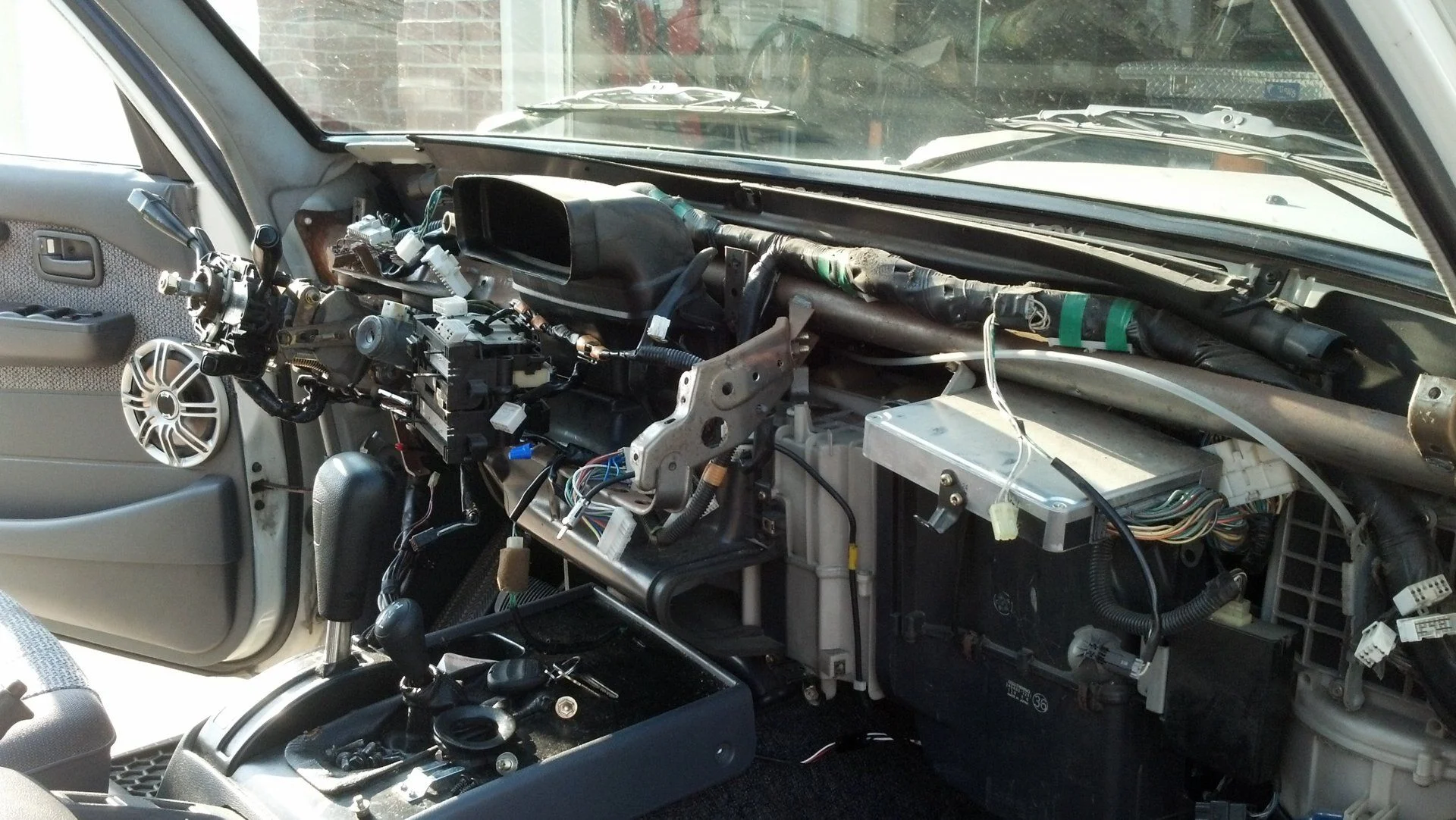

I just did this last week.
I'd suggest:
1. Removing the DS seat
2. Removing the steering column, but not the wheel. After you disconnect the DS airbag and IG sw, there are two bolts and two nuts which attach the column to the dash. There are two nuts, bolts and lock/flat washers which connect the column to the output shaft. TAkes fives minutes to remove and is well worth the time.

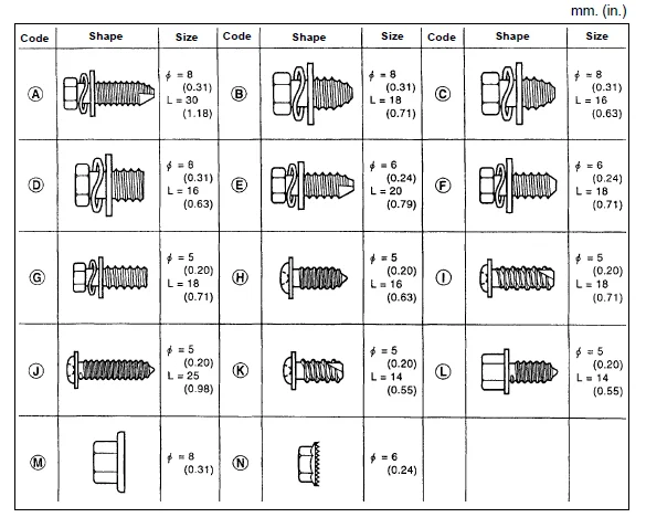

3.Put these in containers, so you don't lose any:
4. Removing the PS airbag (takes 5 minutes)

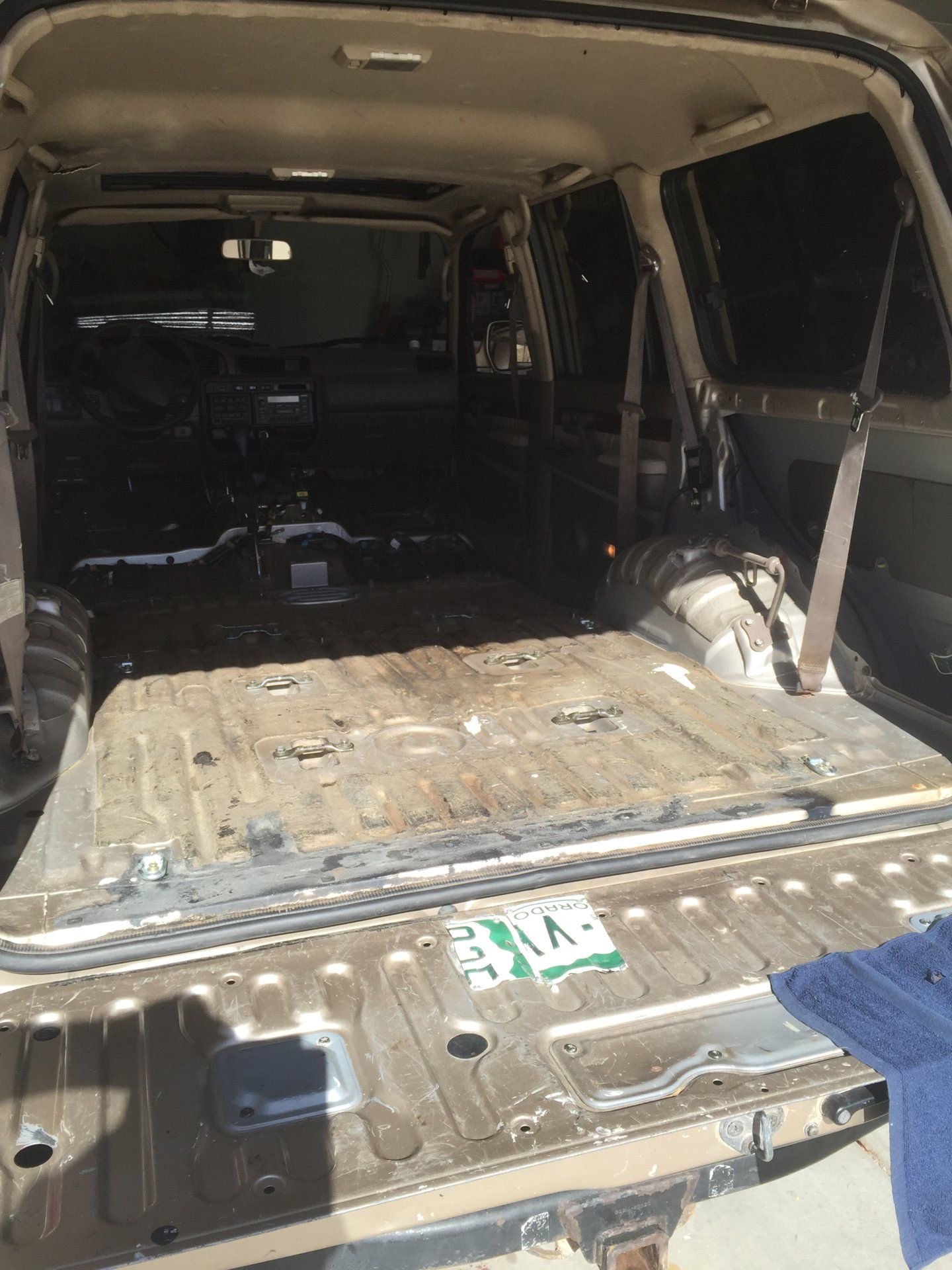

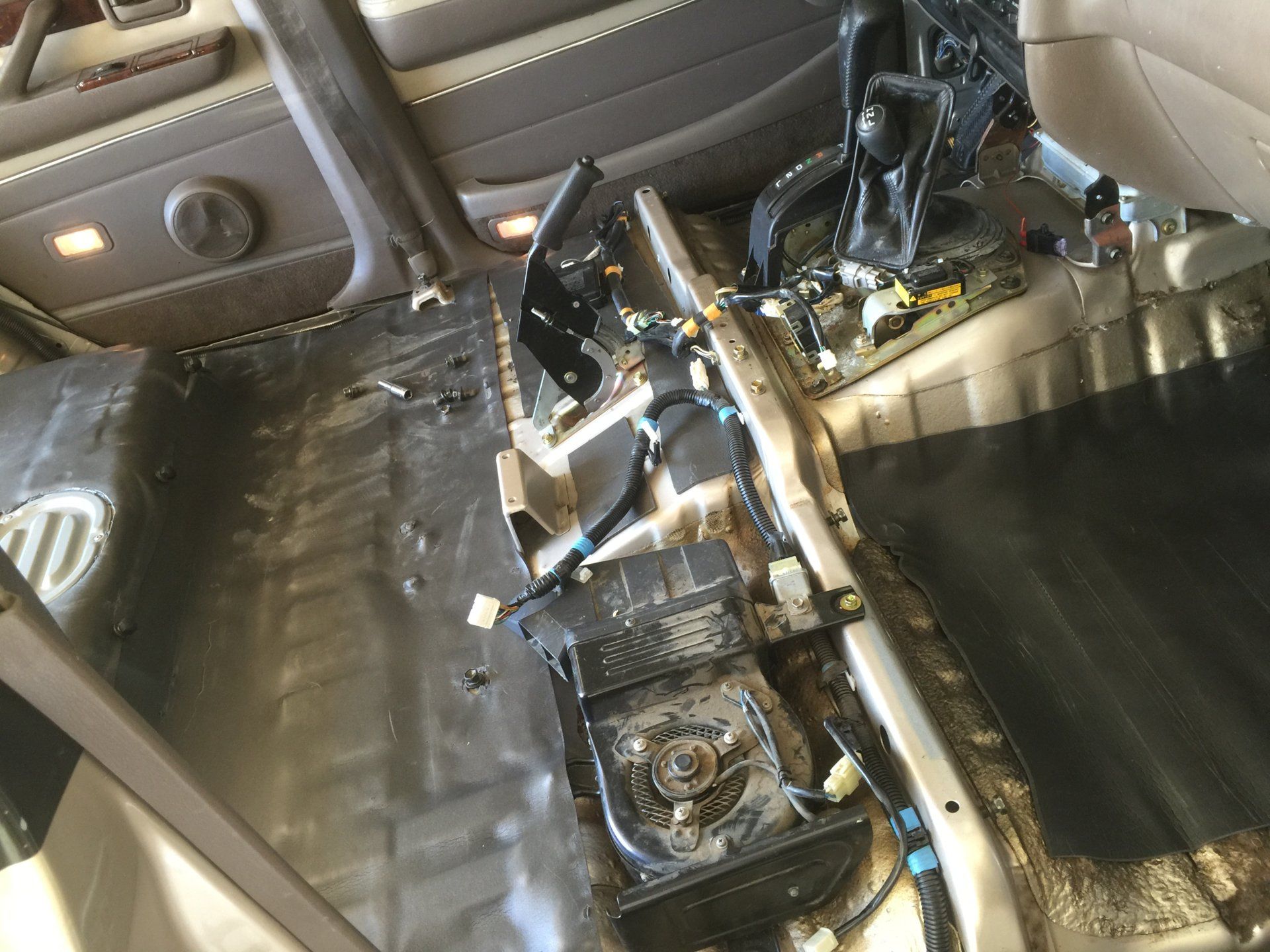

Did the swap myself. Removed all interior from one and installed in my current. Also did dynamat under the carpets. I chose to ignore the headliner but dash, door cards, carpeting, even seatbelts were swamped! I just went slowly and everything worked out fine

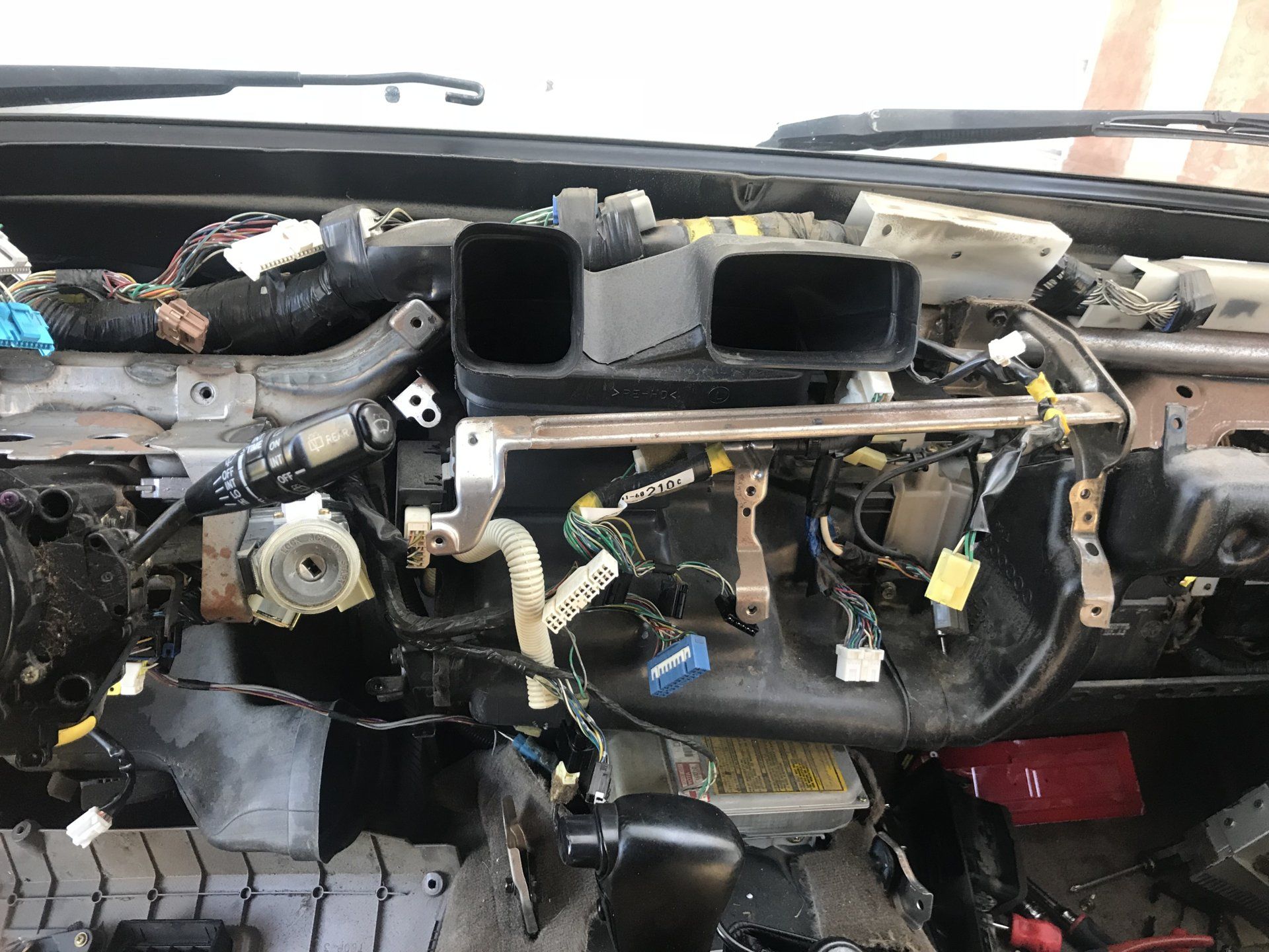

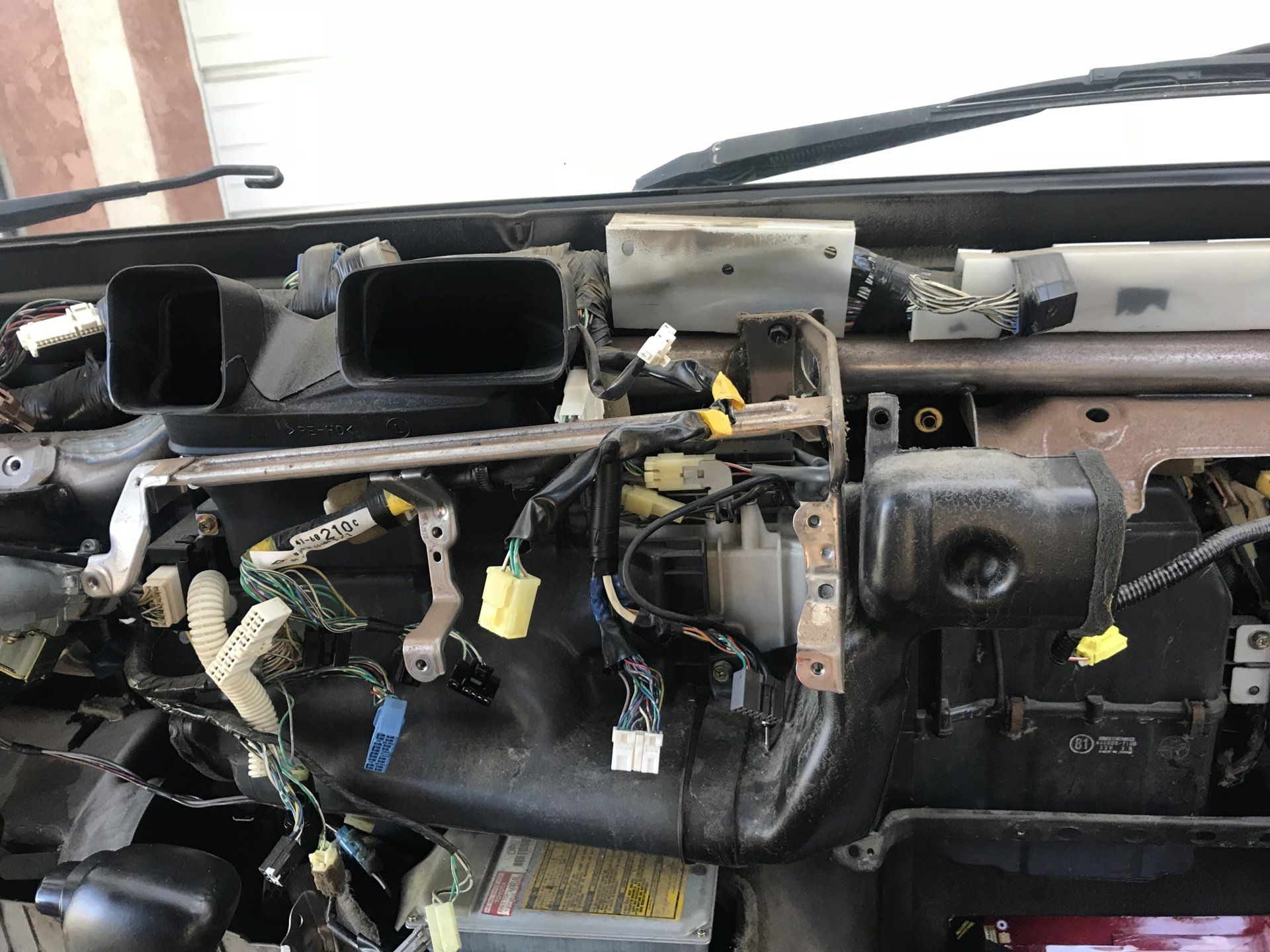

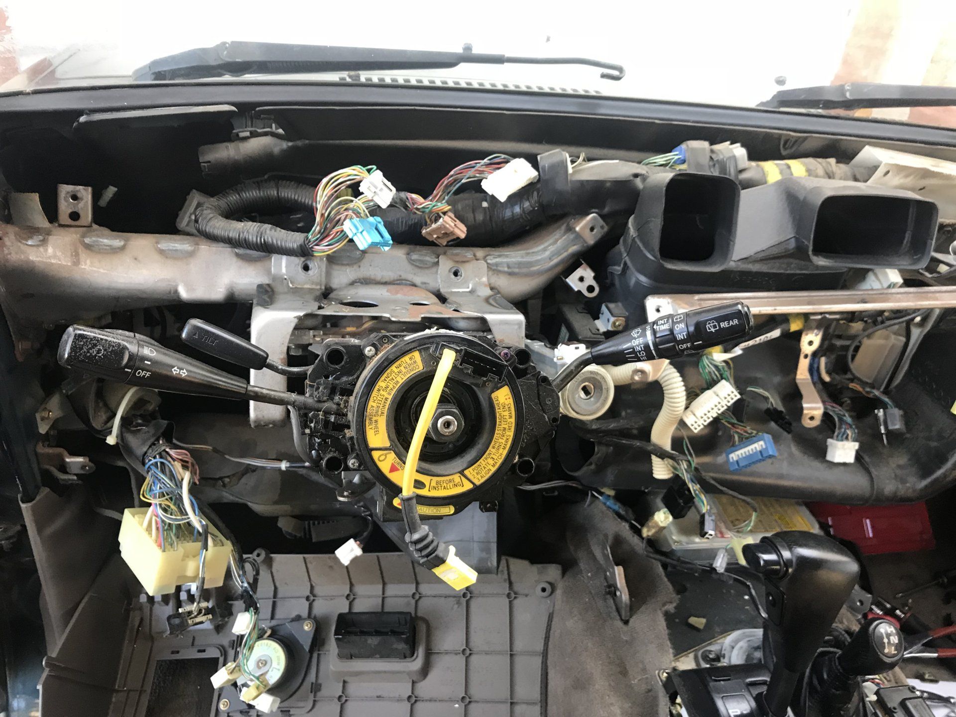

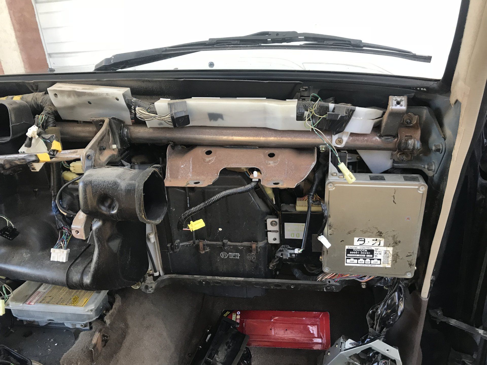

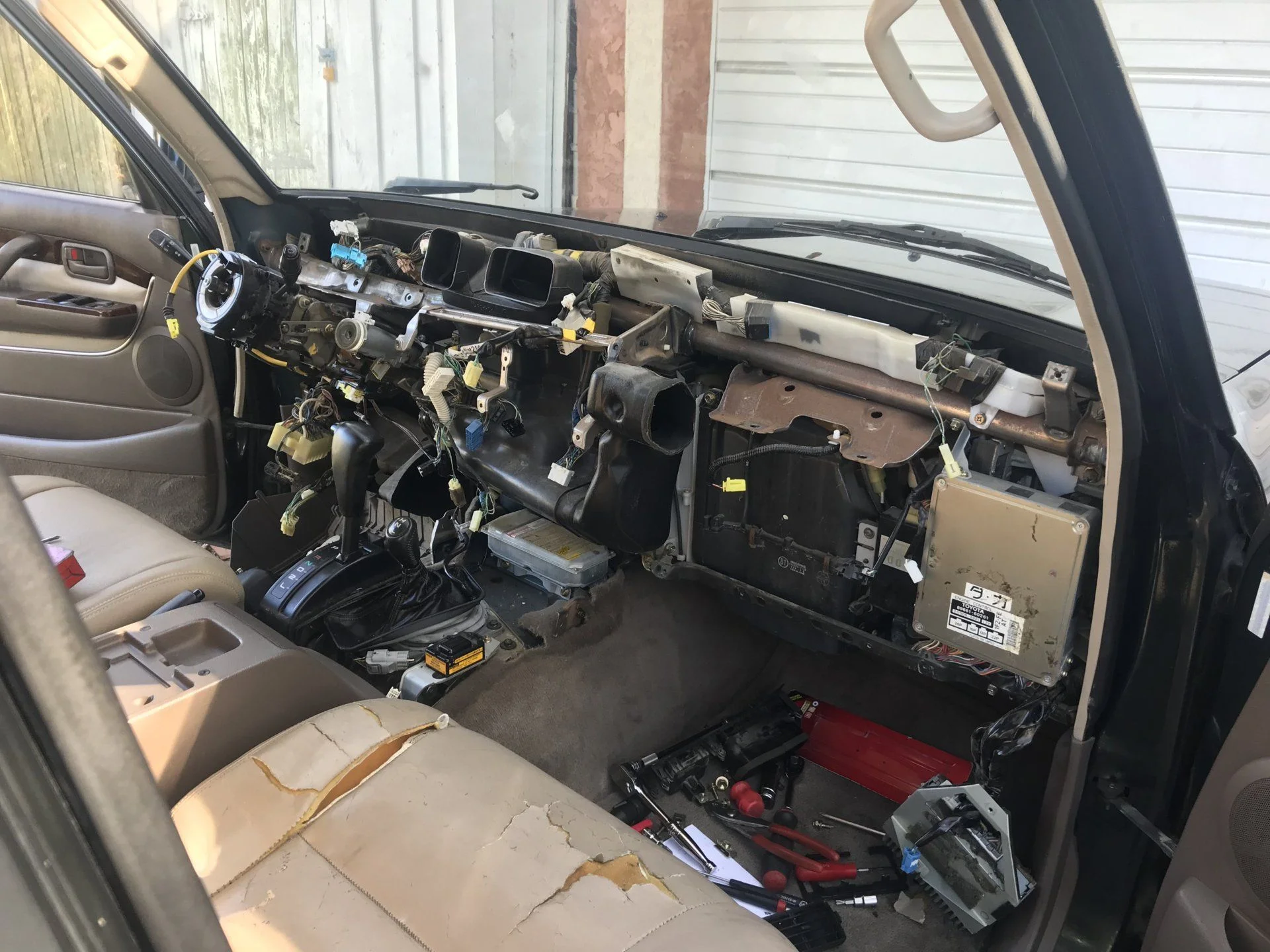

Finallly... got it out.
That looks pretty clean for being 20+ years old.
Under 100K;)
:clap:
Next time (!), pull the DS seat and steering column. Wayyyy easier.
