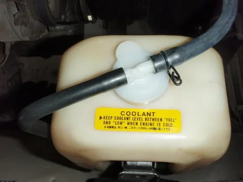

Where did you get the new coolant sticker from Dan? Looks great
Hey mate, sorry for the delay. I got the decal from Cruiser Corps ebay store, along with a couple of other things. Worth the $3 i reckon. :)

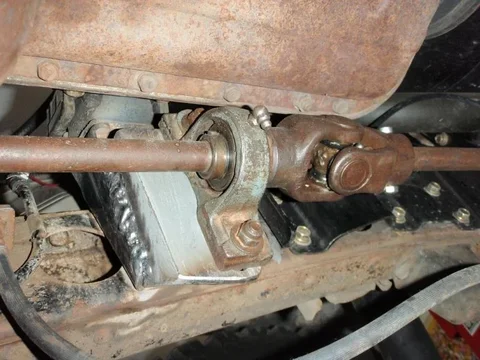

I had to grind down the home-made Toyota PTO gearbox adapter so the Thomas Winch shaft could slide onto it...
Then I drilled through the uni where the grub screw went and fitted a HT bolt. I noticed it goes through he casting line, but hopefully it will work ok.
I had to make up a mounting plate for the shaft plummer block bearing and even though I could slide this bearing along the shaft it worked out good where it was, as I could attach it to the LH engine mount using a piece of mild steel angle I had lying around. Welding in this position was difficult for me with my stick welder.:o
I'm using another HT bolt where the shear pin used to live for the moment. The shear pin I removed is a bit bent out of shape. The OEM Toyota shear pins I have sourced are far to thin for this application unfortunately.
Even though the welding looks very average, I'm certain it will hold. :hillbilly: When I eventually do a frame-off I can clean this mounting plate up to look neater.

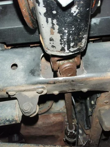

I had to enlarge the opening in the front frame cross-member to accommodate the first uni joint.

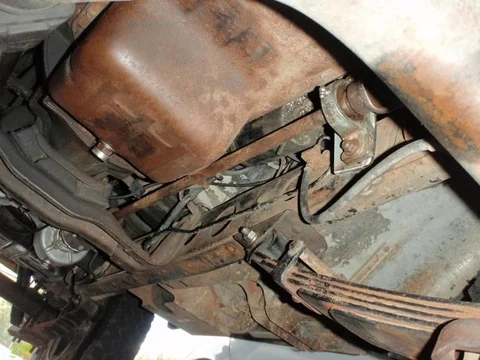

I was surprised how relatively straight the drive-shaft turned out being!
I'm pretty happy with how it turned out overall.
Damn, 1st gear on the PTO is very slow. I could imagine it will be able to pull you out of just about anything. I'm looking forward to testing it out sometime.

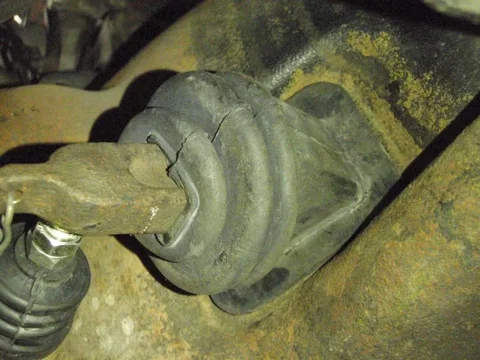

Had a couple of hours to tinker on the 40 today so I fitted an OEM clutch fork boot I picked up, to replace the wrong-type boot that I butchered and fitted 3 years ago.
Old
New

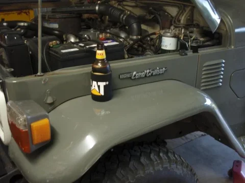

I love the flat fenders on these beasts, they are very useful for holding tools. :lol:
If and when i decide to strip it back and have it resprayed the original colour ...:beer:
