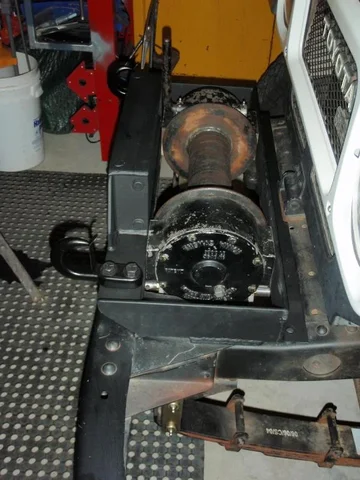

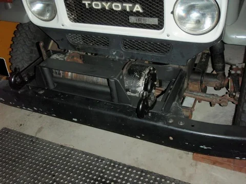

PTO winch is coming. PTO gearbox is installed and I've cleaned up the Thomas winch. I just need to fab up a new mounting frame for the winch, buy some cable, make a lever for operating it, source some new unis for the shaft and modify the driveshaft to suit the Toyota PTO gearbox instead of the Thomas gearbox it came off. I'll get there one day! :rolleyes:

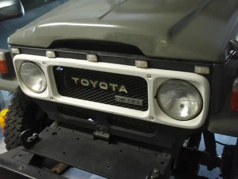

On the weekend I took off my bezel and sanded it back to bare metal. Looks like it has taken a hit in the past as the PO used a fair bit of bog to smooth the bezel over after some really rough panel-beating on it. Sprayed it with primer and then a couple of coats of an "off-white" colour I found, and I reckon it turned out ok. Looks more like a 40 than before anyway.
Now I want to fix the rust in the bottom of the bib, remove the LED lights the PO fitted and paint it the same grey as the rest of the cruiser.

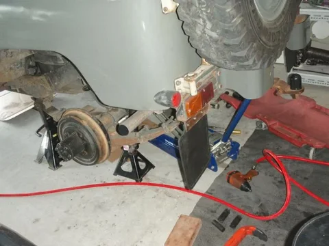

I also finally tackled my springs. I removed the bottom two leaves out of each spring pack. I assume they were added to make the springs heavy-duty as they were not clipped in at all. Just undo the centre pin nut and they fell off. :) Cruiser now rides heaps better. Still a bit bumpy, but the bone-jarring stiffness has gone. Shackle angle has come away from vertical slightly, and it made a huge difference. I knew i bought my compressor for a reason. With air tools it was a piece of cake and pretty quick. Wish i had done it two years ago! :rolleyes:

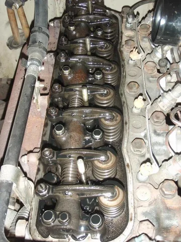

Decided to lift the rocker cover and check/adjust the valves. A couple needed minor adjustment, but nothing to dramatic. Look like a bit of moisture must have been under the cover as some surface rust was developing on the rocker shaft and some of the locknuts. It cleaned off easy enough, but glad i checked.
New OEM seal. The one that came out i'd say was the original one as it was fairly squashed.
New seal sits well.
I love the little details Toyota put into it's parts. Check out the detailed TEQ and Daihatsu stamps inside the rocker cover. Cool.:)

Not much been happening on the 40 over Christmas and the New year. I've sourced a new roller fairlead from Gears and Winches down in Brisbane, who were originally Winch Industries, the manufacturers of the 8000lb winch I have. Just waiting for some funds before i pick it up and then the PTO project will take off again. I've got the steel at home ready to fab up a cradle.

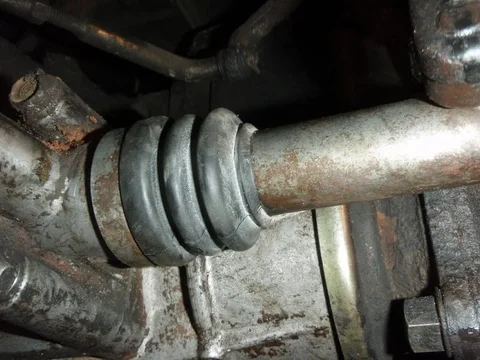

I was hauling some pavers a few weeks ago and the LH front tyre tube blew out on me about 5km's from home, so had to get that replaced. Changed out the engine coolant and also the perished rubber boot on the 4wd selector shaft.

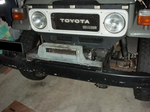

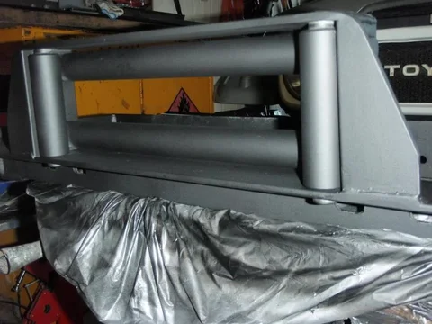

Well, I picked up my new roller fairlead yesterday and started to make the new winch cradle today. I used 75x75 5mm angle and it will be mounted to the front chassis rails with three HT bolts each side. Do you guys think that that will be ok? The cradle and winch together is going to be a heavy mo-fo! :lol:

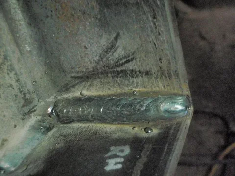

Pretty pleased with some of the beads I was laying with my little inverter-arc welder, especially because I haven't been welding often, since about 10 years ago. :doh:
I have to drill more holes, finish welding and trim it up a bit, but hopefully it's all done by tomorrow arvo.
........I used 75x75 5mm angle and it will be mounted to the front chassis rails with three HT bolts each side. Do you guys think that that will be ok? .....
Well I use just TWO 12mm bolts each side Dan. And I don't even worry about whether they're HT or not.
I did however thicken/strengthen my OEM bumper around my front pair of bolt-holes. (The other two are in the thicker chassis rails.)
And I don't think my bolts are even close to being the "weakest link" in my setup. (Shearing four ordinary 12mm bolts like-a-guilotine would take considerable force!)
The way I see it, other things would break (with hopefully my winch shear pin being first), way before I'd shear those 4 bolts.

One step closer! :D
Finished up the winch cradle today and put the first coat of paint on her. Going to put one more coat of flat black on tomorrow morning then bolt it up. I'm really happy with how it has turned out! :)
