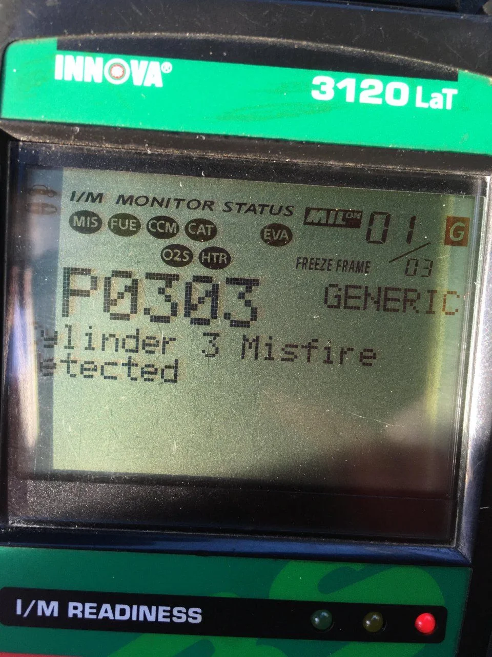

I have a misfire on cylinder #3.
More specifically, the ODB reader says: P0303 Cylinder 3 Misfire Detected.
Is it easy to replace the coil and/or spark plug? Which cylinder is #3? Third one back on the drivers side?

drivers side, second coil back.
8 7
6 5
4 3
2 1
Spressomon beat me to it...
I want to thank everyone for their quick response.
I switch coils from cylinder 1 and 3. Off to auto parts store to clear the codes and then get the problems to appear again. If it says Cylinder 1, then we know it is the coil.
