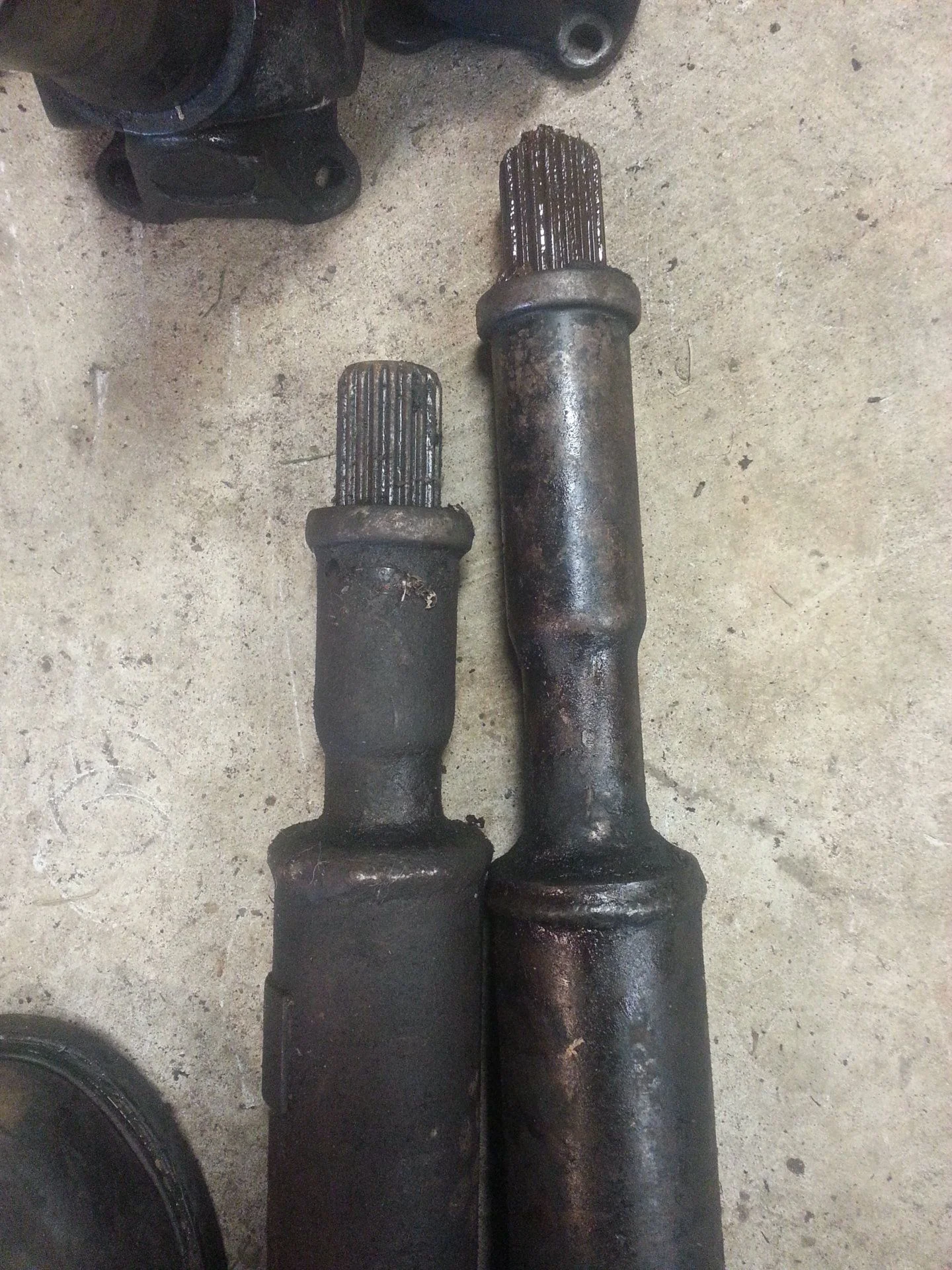

Pretty sure I've managed to avoid having to weld on the rear drive shaft....unless my measurer is too short one end it'll be about 3/4" from full compression at rest which should be close enough for the girls I know.
There's quite a few variations of driveshaft out there in cruiserland. Gives you some options before you start cutting and welding.
I banged in some new universals while I was at it, mainly because I had a different bolt pattern at the tcase end, so I did some mixing and matching, meant taking two ends apart, but still easier than redrilling.

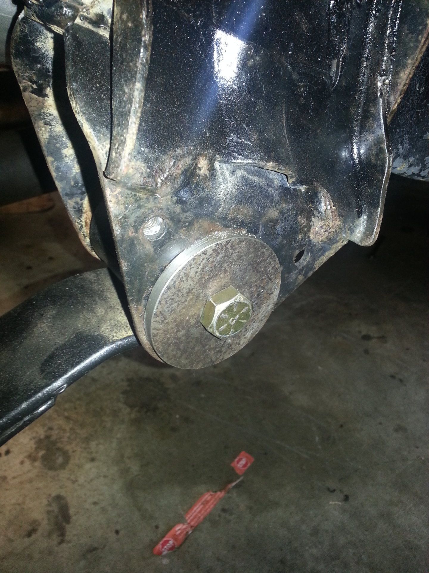

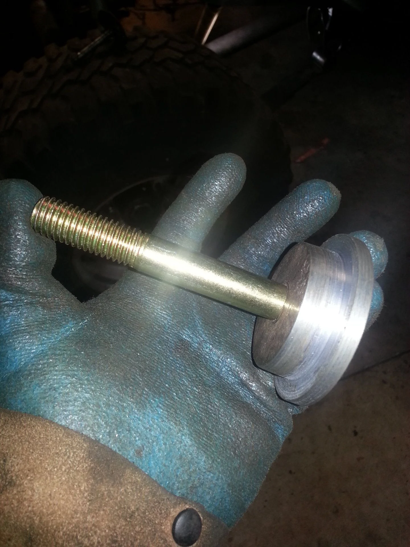

I wasn't happy with the adapters I'd made for the fixed end of the rear springs. The chev springs are a bit narrower, so I needed a spacer as well , and a stack of washers is like something a Victorian would do...
So I continued to abuse the wood lathe and made a couple of these. ( this frame has different rear pins than other cruisers...considerably larger diameter , guessing they're the same as a 75 series)
More better. :)
Not 100% done. Think I'll countersink the bolt a bit, give it some shape to look more like the old fj45 pins.
Now they're done. Not that it makes one iota of difference, but they do look better with a bit of shape to them.

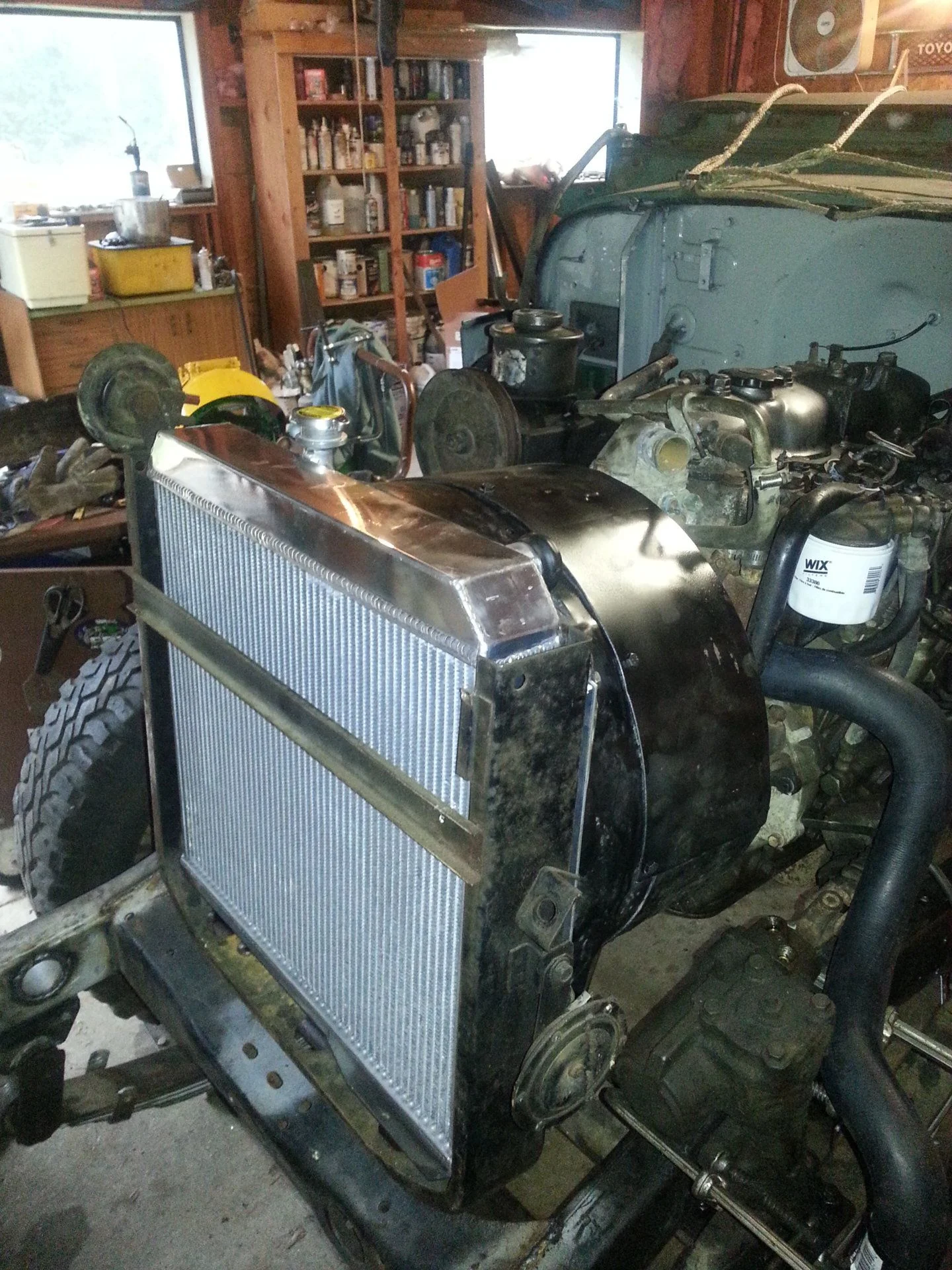

Got some shiny s***. Fits ok . I'll have to do a bit of notching to get it lower in the mount, but I'm changing the way the rad support attaches anyways. Figger I'll use the bj60 mounts, should keep the vibrations away from the shiny s*** a bit better.
About the last real purchase of new stuff I'll have to make. Other than tires I guess...and maybe a clutch, as the one in there looks like it was "lady driven" :lol:

That's a nice rad, where did you end up snagging that from?
Ebay special. About 300 bucks, looks pretty well made, so we'll see.
Probably the same factory the ones you'd get at lordco etc would come from. I read somewhere there were only a couple places out there making the cores, so even a fancy expensive one is probably not a lot different from one of these.
But yeah, we'll see if the water stays on the inside of it...:lol:

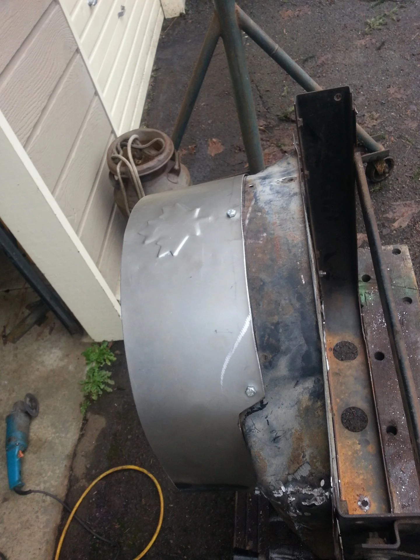

Anyway , today I used my indifferent sheet metal skills to turn a s***ty fan shroud that really didn't fit, into a s***ty fan shroud that doesn't really fit.
Been threatening for years to make a removable top section so I could get to the water pump without a massive headache .

Nice fan shroud; I like that you made it removable - good idea. I made a new top for mine also, and ended up riveting it on to the existing shroud. Now I wish I'd made it removable as you have. I always dread removing my fan and shroud, as it always scratches the s*** out of my forearms.
We take good care of the equipment now. It was the previous machinist who was here for 40 years that allowed the equipment abuse to happen. If any good stuff comes up for sale I'll give you a heads up. Would be nice to know it was going to a good home. Usually it goes up on BC Auction, but we might be able to swing something else.

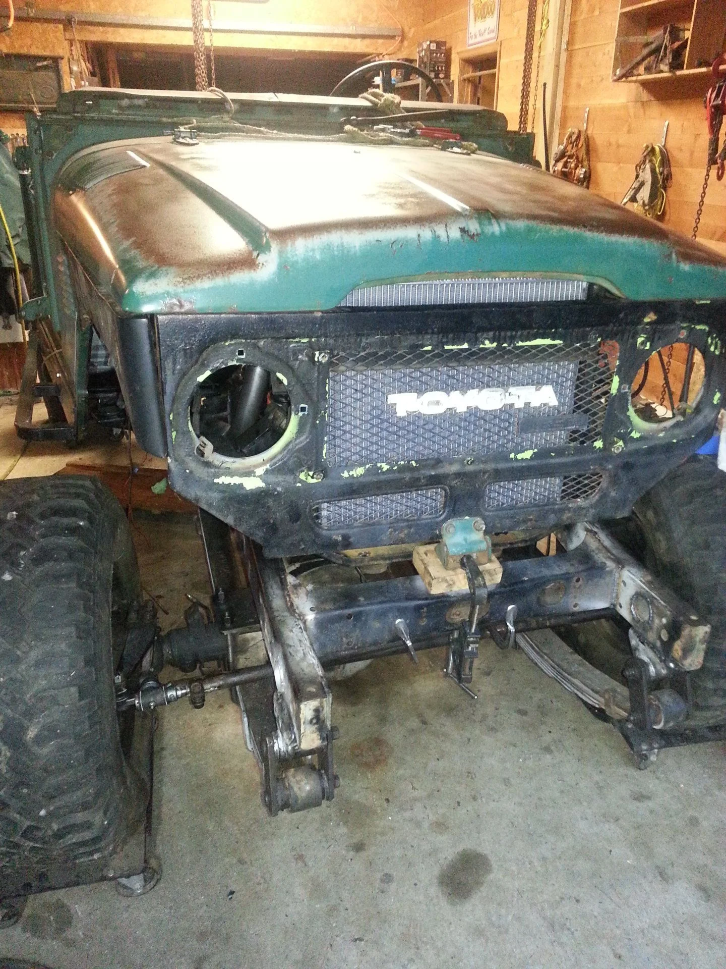

Then I started getting paranoid it was all too high so I did a test fit of the hood and the easy parts of the clip. Forgot how much room there is under a 40 hood.
I'll need to space the bib up about 1.5", but I knew that already . Just the way a 70's body fits on a 90's frame.
Think I'll weld a bit of square tube to bottom of the bib to close up the gap, but I can probably reduce it by messing with body mounts too.

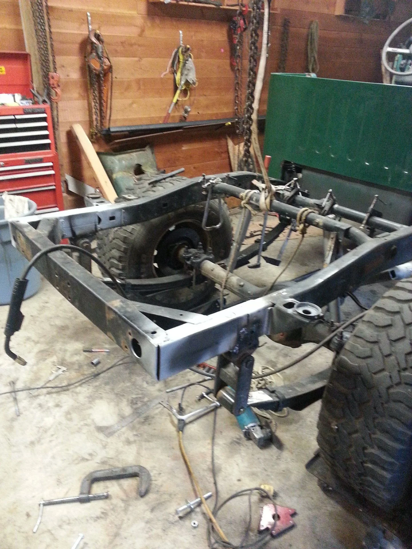

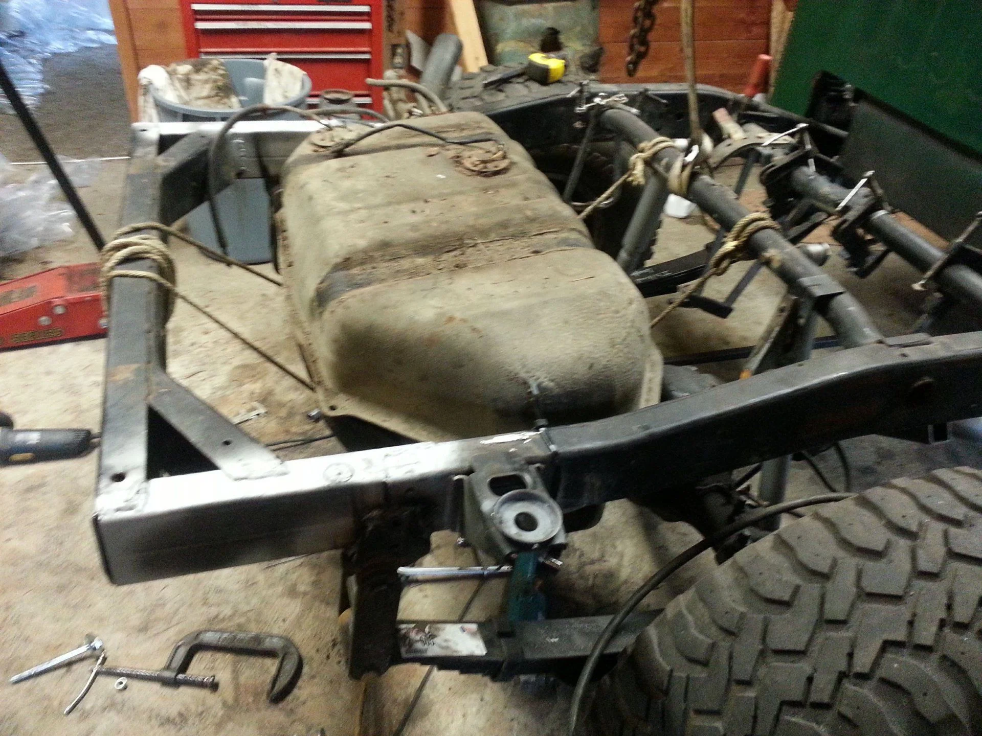

Did some staring at the arse end. This plywood bit is 5'6", which is how long I'm hoping to make the deck. Obviously it'll have more shape at the back when finished. I can live with that amount behind the axle.

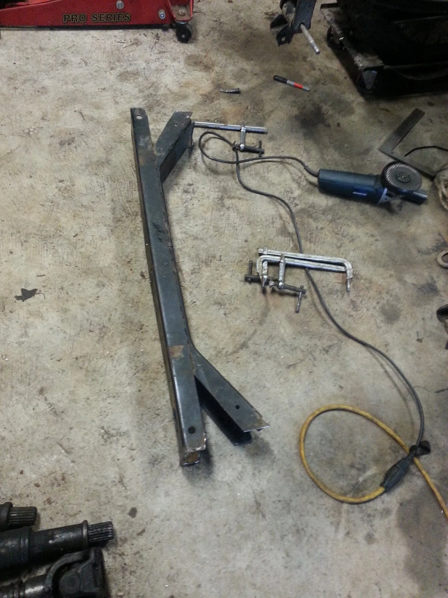

Rear crossmember fell off. :lol:
Extra foot. Need the frame close to back of the box for hitches etc.
And a bit more room for fuel tank, with the axle moved back it was a bit toight...
I'll plate the inside of the joint obviously, might be part of tank mount.

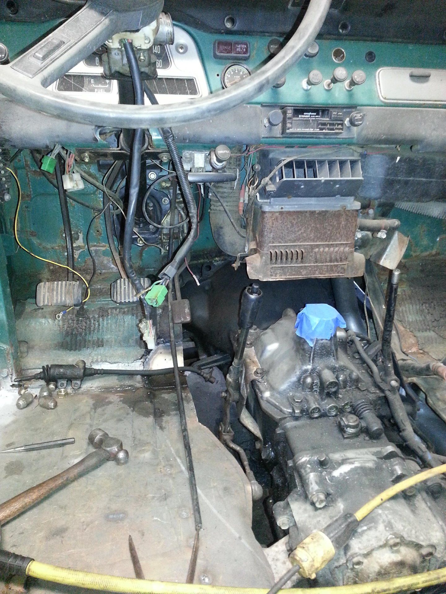

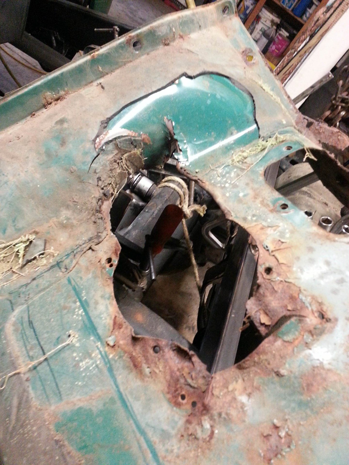

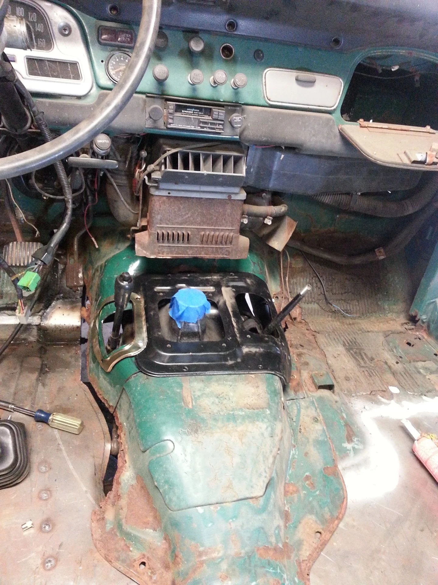

So today if I get motivated to go outside, it's to turn a tranny hump that looks like a can of smashed assholes into something useful.
"Skunk, killed with an axe" Seriously, I think the shifter hole was made with a freaking axe. :lol:
I suspect left hand drive pto shifters were different? I moved this over a bit. Looks tight on the gas foot .
Figger I'll use the 60 cover plate and have the hump in 2 pieces. It'll pretty much be cut in half by all these shifter boots anyways. Plus they're a bitch to get out when they're in one piece. Having to remove the seats first is nuts.
I say it all looks fine, lots of throttle leg room. I once made a shifter boot from canvas.... it sucked. Having those oem parts to play with must be helpful.
Yeah it's good now. Don't think it would have fit inside the hump had I not moved it over.
Tranny humps are just that one part of a cruiser I absolutely hate...colossal pains in the ass to work on...one starts to get a wee bit hostile :lol:
