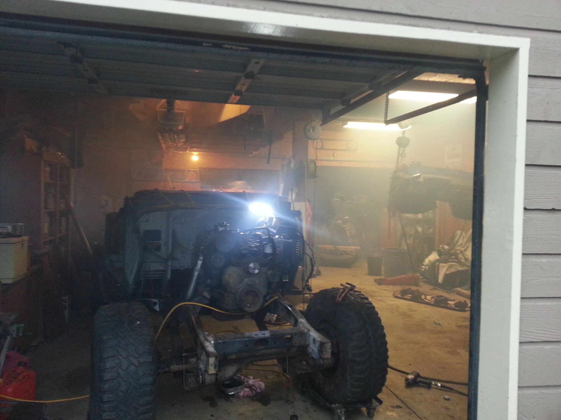

Decided to fumigate the shop...:grinpimp:
Old lump sounds ok. Was a bit concerned because some water got in the intake ( wasn't in there for too long), but I put some oil down the holes and let it sit. Then blew it back out again with the starter.
It's first sip after a dry spell...:hillbilly:
It's first sip after a dry spell...:hillbilly:View attachment 1868625
