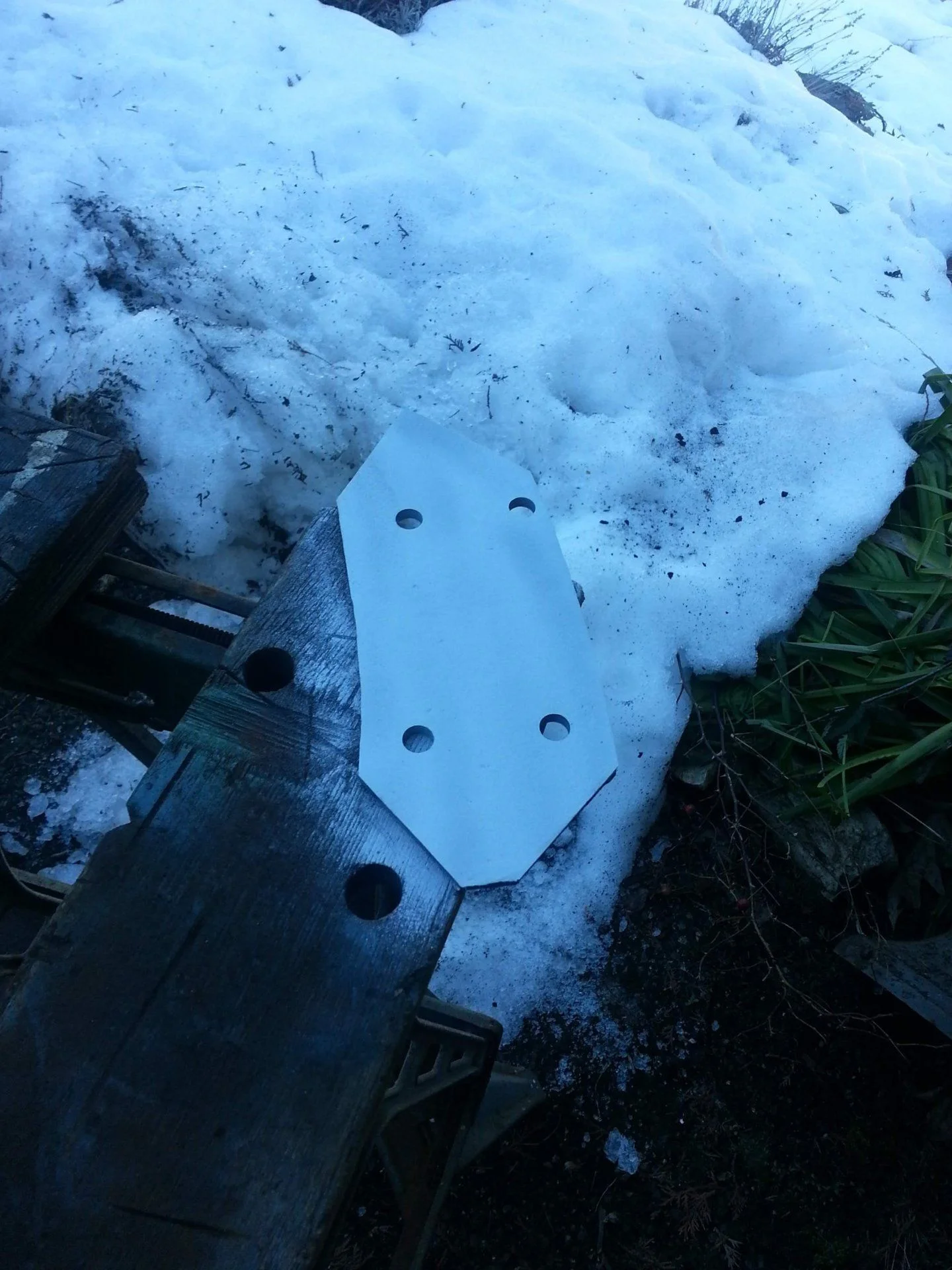

I got this hateful fawking thing mostly done. It's in two pieces, so the hope is that'll make my life easier in the future.
I'm sure I'll still be bleeding and angry if I have to mess with it again...:bang:

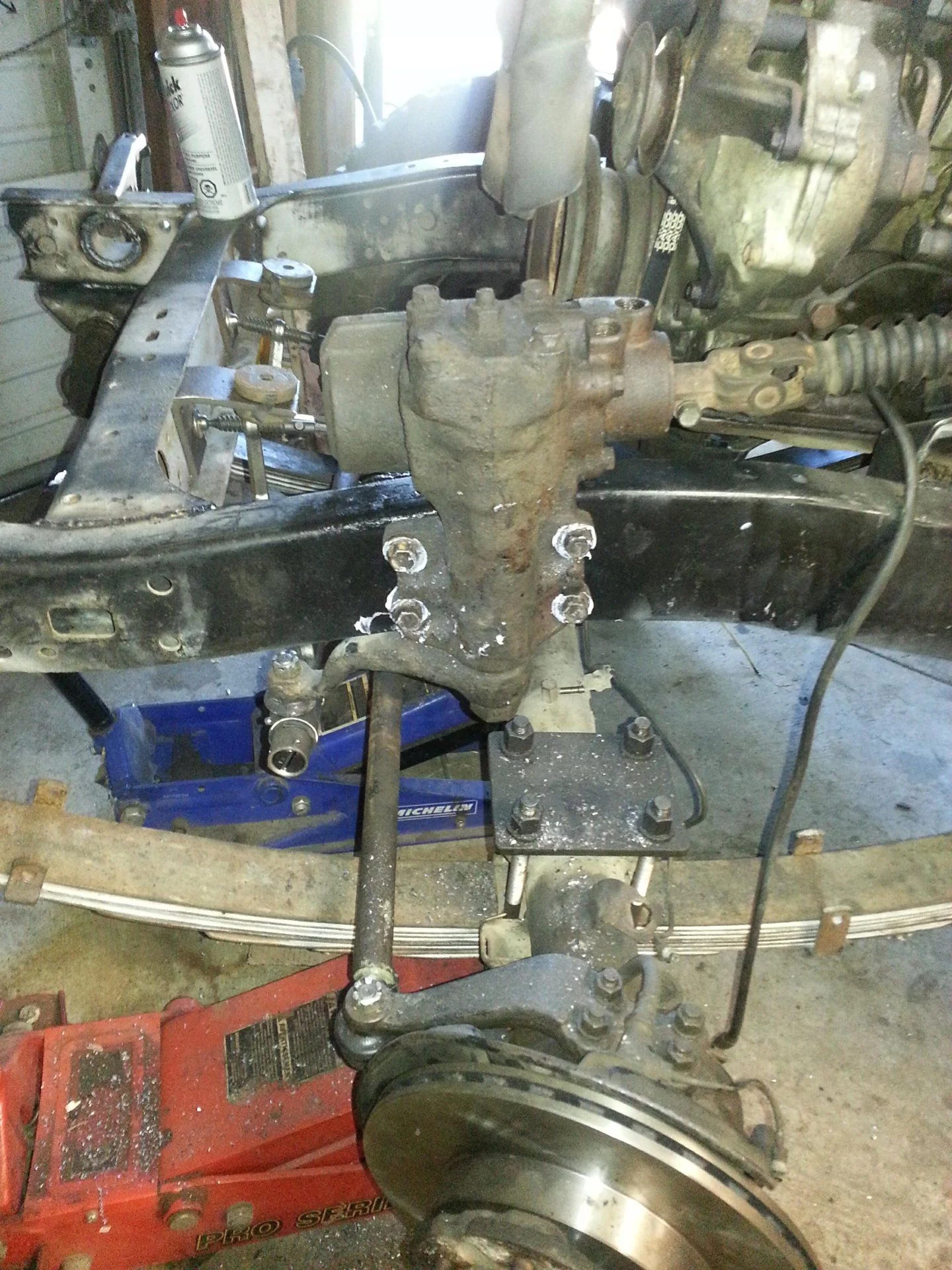

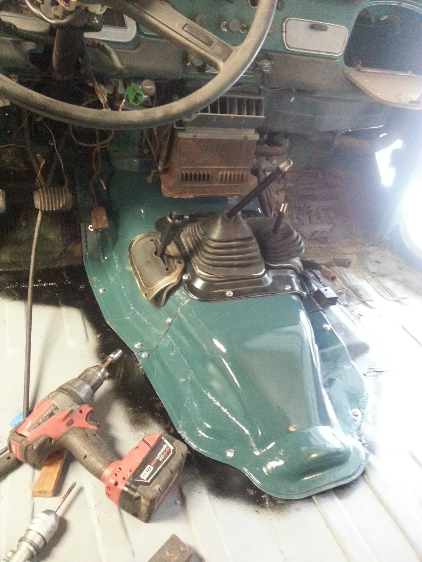

I also got the column finished off and bolted in, and then got the box mounted. Because between it and the rad I wanted some of my damn clamps back...:lol:
I did the fishy plate thing on the back, and sleeved the bolt holes, so it should be pretty solid.
1914754
There was a lot of farting about to get it in the right spot, but it ain't getting moved now. The white snot is food grade never sneeze I have.

Is the plate you made behind the steering box to add strength and keep the frame from cracking? Lots of the HDJ81's have cracked frames by the steering box.... I really should look at my LJ's frame in that area...sort of procrastinating as I don't want more on the list of s*** to fix.
Thanks, and that old clown did ham it up for the cameras once or twice...:lol:
And that's the idea with the plate. Spread the load out a bit. Probably overkill but easy enough to do now. It's more than they do from factory, I doubt it's likely to crack, but may as well do it when it's easy.
The never sneeze is pretty cool, temperature range on it is insane. Idea being you can use it on restaurant equipment and not poison the clientele :lol:
I drilled the 4 holes out and welded short sections of DOM between the rails on my BJ74
when I realized that the steering box had quite literally pulled the bolt heads through the
frame from the far side. I also welded a scab plate on the far side under the new bolt heads.
You can't overkill this.
On my FJ40, that plate was 1/2" thick under the Saginaw box, but I was running 38.5"x14.5" wide tires.
Yep, if you read the above posts, that's what I did. Backing plate and sleeved. Sleeves aren't optional, backing plates don't hurt, but this isn't the same as a Saginaw conversion where the plate is tapped for threads. Basically just factory 60 setup.
Your 74 is a lhd convert isn't it? Both sides of the frames are drilled for steering boxes, but only the one side is sleeved. Whoever did the conversion probably crushed it on initial install when tightening the bolts. Without the sleeves the frame would start to crush long before the bolts got anywhere near the torque settings, after that it'd only get worse.
Those big fine thread bolts have some pretty intense clamping force.
Yup, I don't even think they thought about it. My suspicion is the kid actually honestly
lost control, cause the steering mount was that bad. His loss, my gain. HeHe!

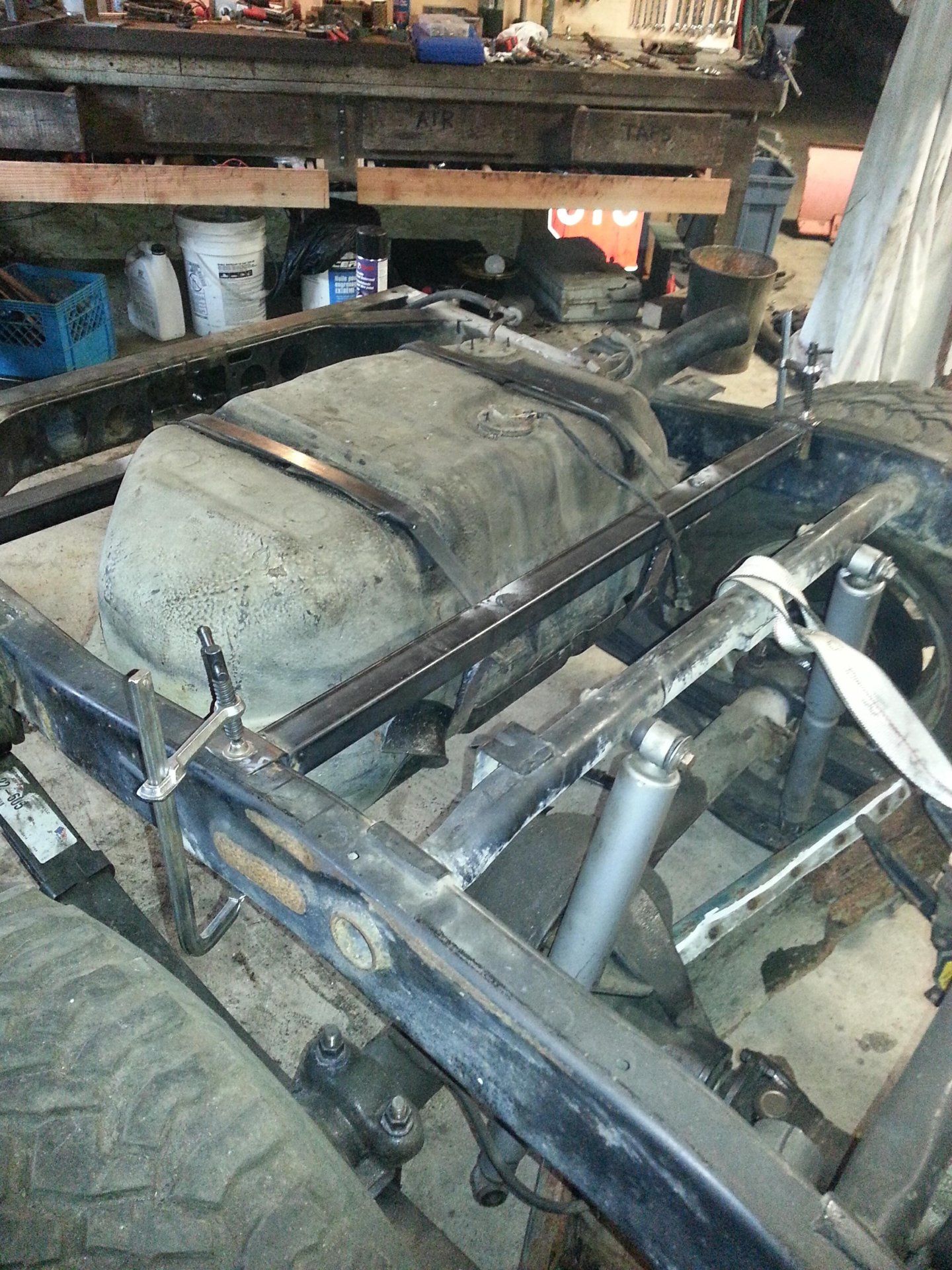

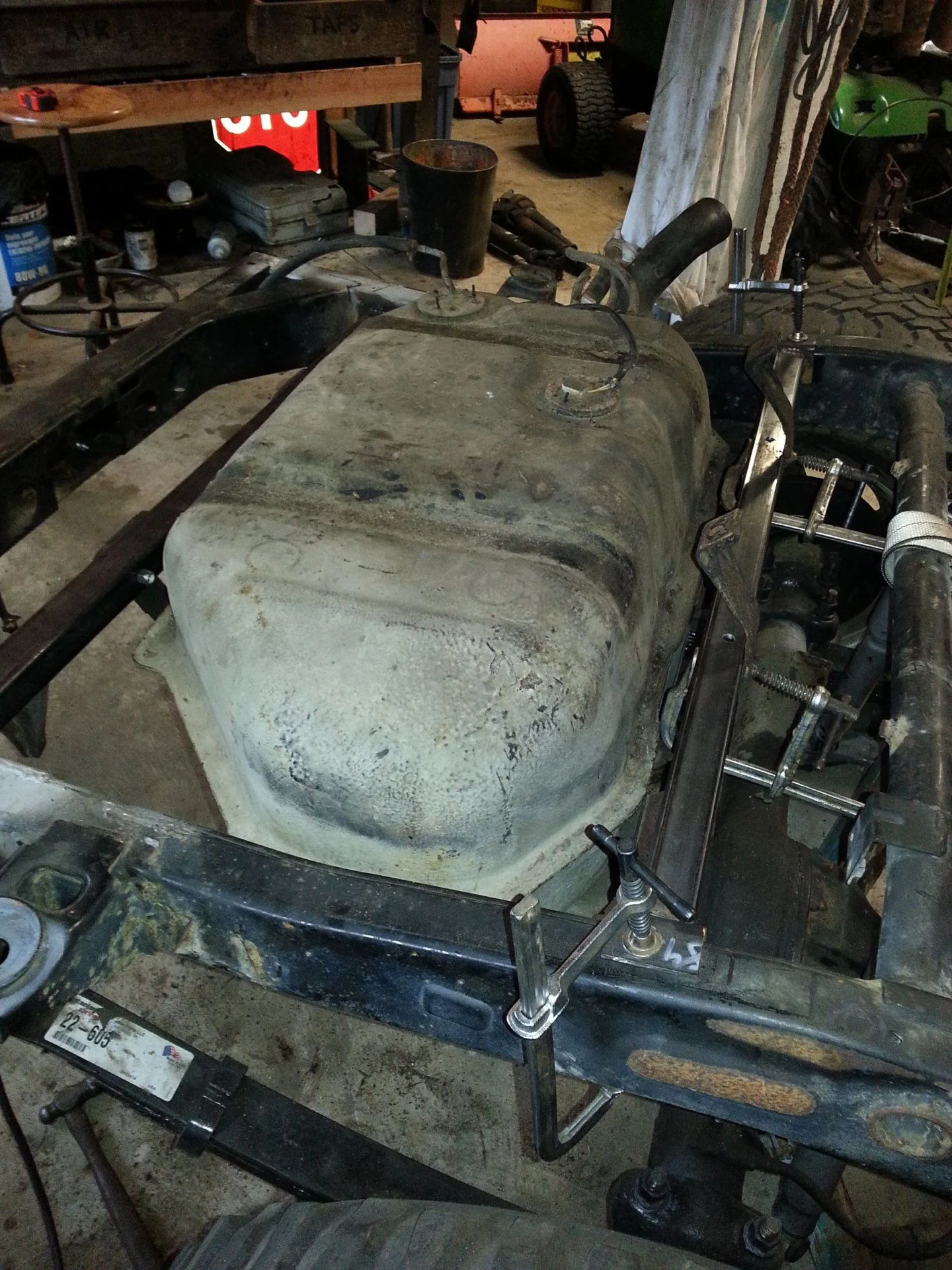

Did some fuel tank stuff today. Between this and hopefully getting the rad in this week, I want to fire up the lump and let it run for a half hour or so.
See if any of it's oil stays on the inside. :lol:
1915678
Again, me wanting my clamps back.
1915679

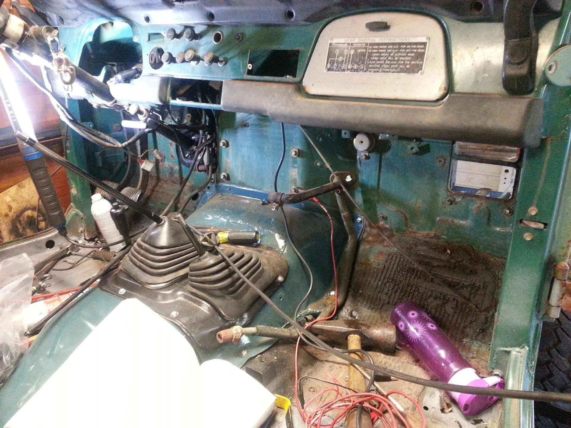

Finally got the axles in. As usual it took getting swmbo involved when anything requires organization..:lol:
1919488
Pulled all the crap out of the dash to get room.
1919489

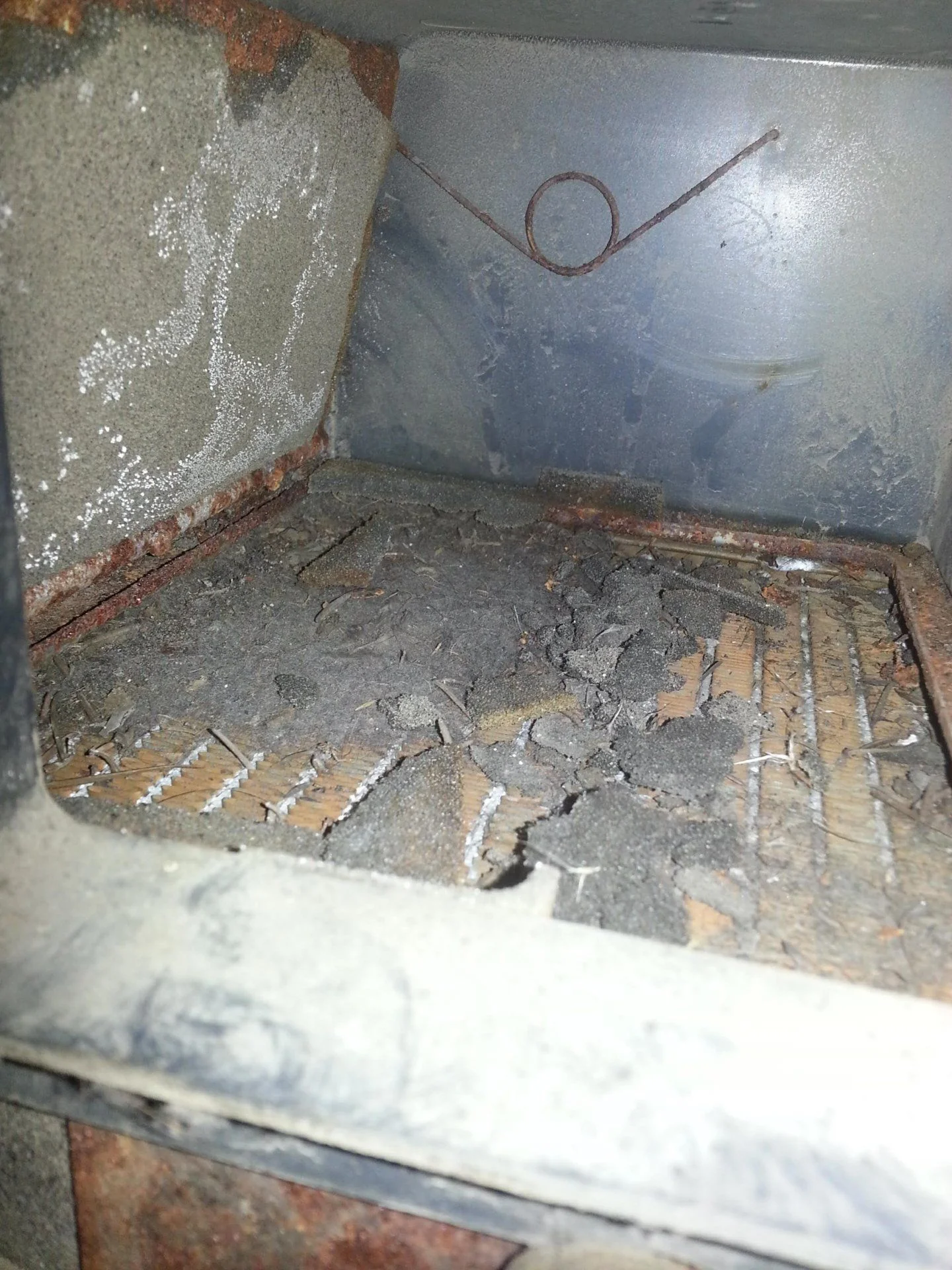

I have a few heater cores. Think I'll find a better one...:hillbilly:
1919490

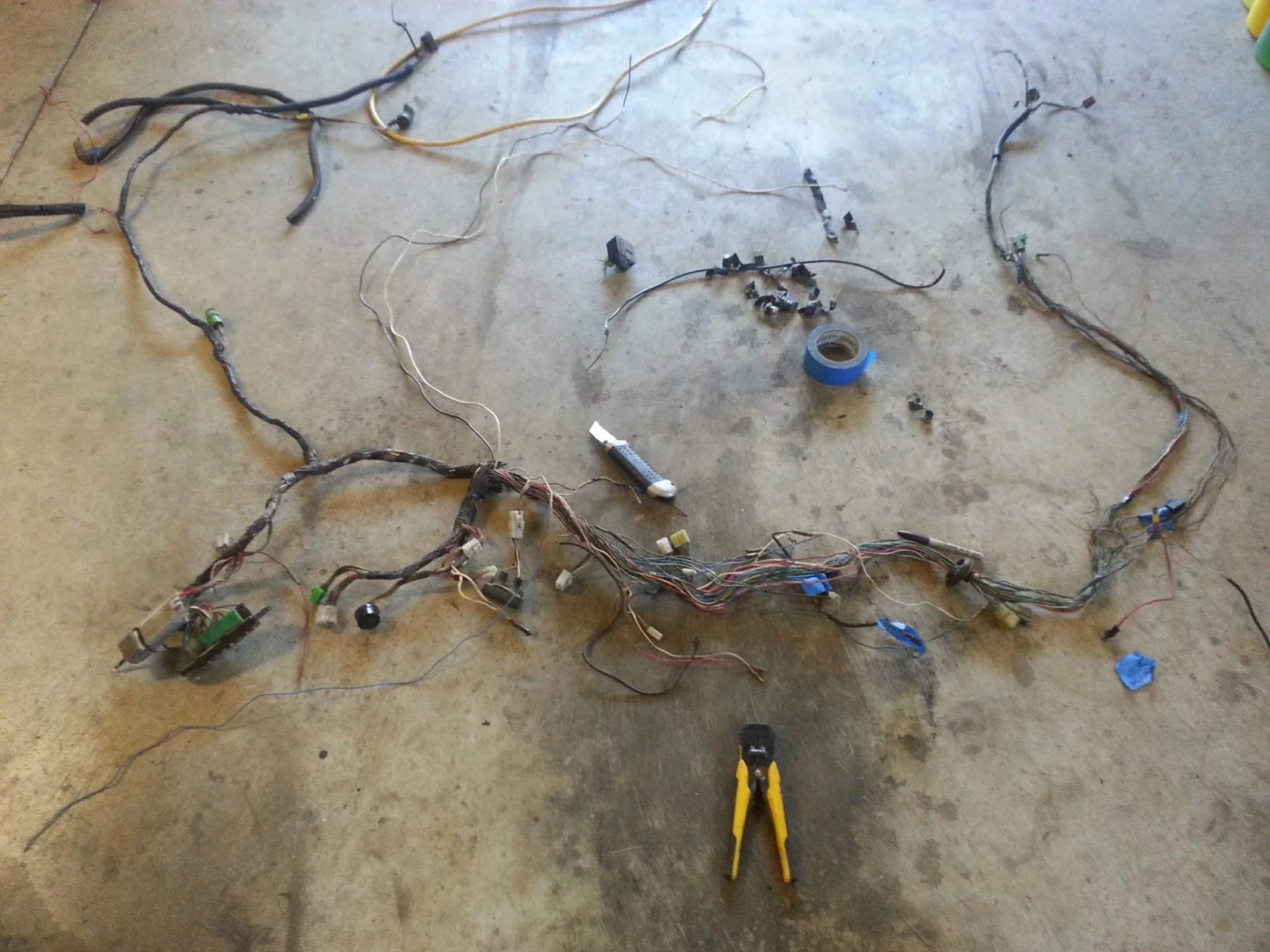

And here is where I'm at today. I have a 42 harness, but I think I'm going to stick with 12v. I like 24 but I'm missing too many things, so modifying the 40 harness. Some s*** is backwards which is why I pulled it apart. Starter, alt, batteries etc.
Also a fair bit of crap I dont want in there. Going full minimalist in the wiring department.
It's beer break time, just looking at this pic makes my brain hurt...:lol:
1919491
That wiring harness looks as if it has only 6 wires in it. Piece of cake! And I hate electrical.
Haha, yeah it doesn't get much simpler. I actually kindof enjoy it, even been looking forward to getting into it. It's all a really a logic problem, you can think your way through most issues, good for when you wake up at 2am and need something to think about while staring at the ceiling.
Fortunately this harness was mostly in good shape, something to do with not seeing a volt in almost 30 years...just had to disassemble all the switches and polish up the contacts.
Still have a few things to sort out but, it'd start with the key now, exept i got a wee bit sidetracked by an utterly hateful clutch master removal s***show. :rolleyes:
Did some stuff. I'm in caffeine absorbtion phase at the moment. Things would have gone quicker if I hadn't had to bundle up like Edmund Fawking Hillary every time I wanted to work in shop over the last month, but it was nice to see the sun instead of the usual grey sky that looks like its 10' above the roof of your house.
But, wiring is mostly sorted, despite it being a simple harness, still pretty much disappeared down a rabbit hole for a week. Squinting at a tiny s***ty chiltons wiring diagram didn't help.
Fortunately I was able to steal lots of bits and pieces from the 60 firewall sitting nearby. I've connected the gauges to the senders, but we'll see how they work, might have to take the oil pressure sender apart to lower its range. I have a feeling it's going to spike the gauge when I start it...or maybe a 24v one would drop the needle. :hmm:
I think I'll do a quick test to see if the ammeter works tomorrow before I go through the hassle of hooking it up... Different era cluster, so its shunt style, unlike the earlier version the harness came with which took full load. Thankfully everything else seems the same, the only thing that doesn't work on it at the moment is the highbeam indicator, which might come back to life as I improve the grounding.

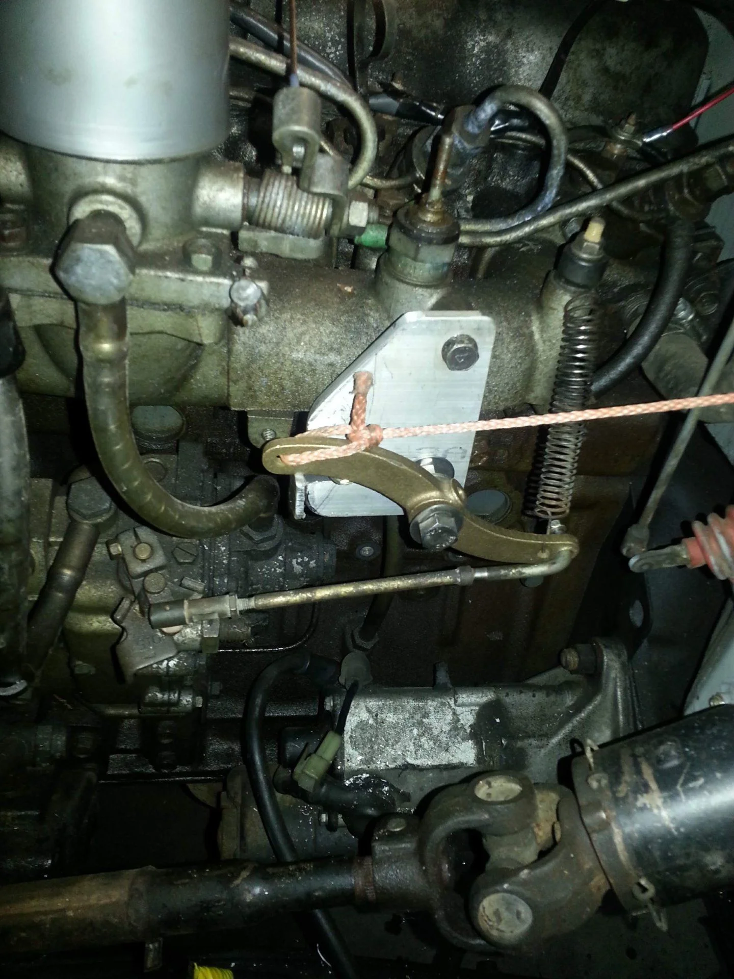

Some monkeyfuckery to get the 60 throttle setup to work.
The throttle pivot mounts line up with the ebrake lever mounting bolts with some minor tweaking. Just had to shorten the push rod a couple inches. The gas to diesel throttle thing can be a huge pain in the ass, because the 42 pedal is totally different to the 40, but this actually made it fairly easy.
1927114
Rube Goldberg nods approvingly...:hillbilly: it'd be a lot simpler if the stop lever moved back not forward, hence the need for a pivot.
F'd if I was going to use an edic motor. (Despite having 3 or 4 of the damn things)
I have something else in mind than the rope and halyard ball for the pull, but I doubt it'll work any better than this. Has a spring and stop so it doesn't shake the lever around when not in use.

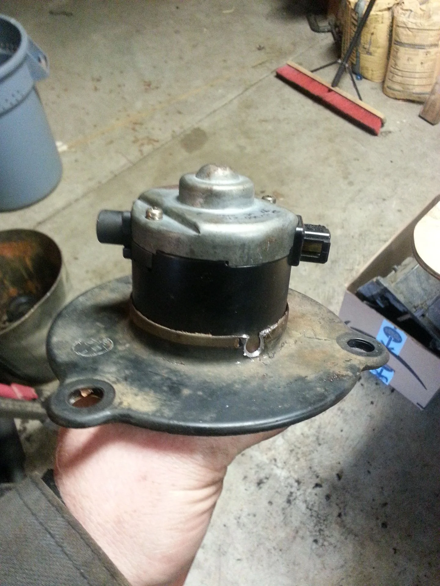

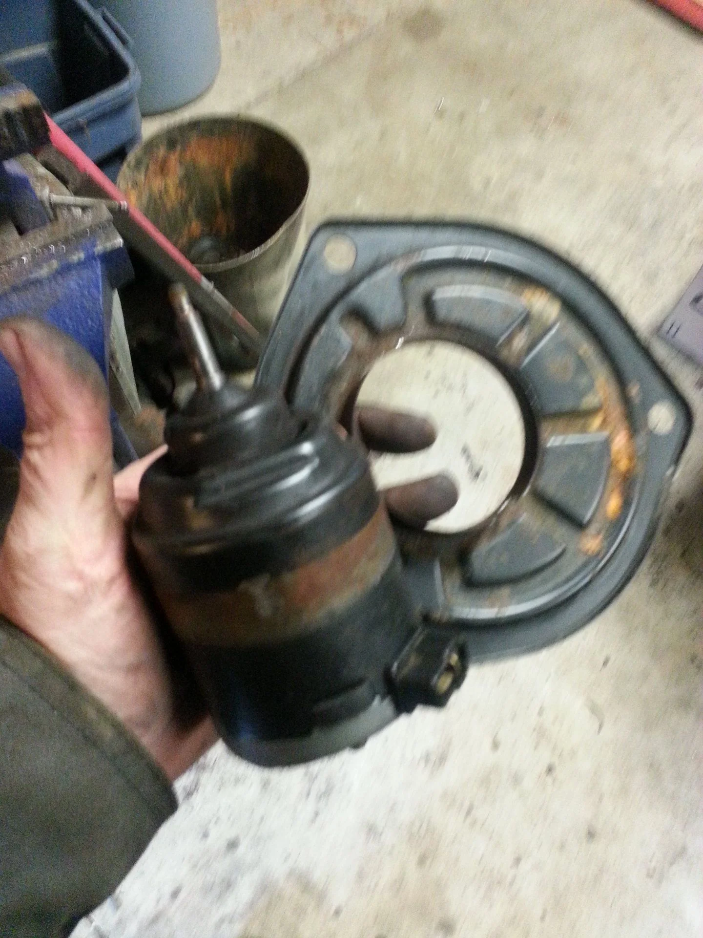

Had to get the blue 60 involved, the old 40 one howled like a bastard. I probably could have heard it over the road and engine noise...:lol:
60 motor is identical, just have to swap flanges. Scary tacking it back on, you don't want to melt the glue holding the magnets in.
Smooth as a gravy sammich now.
First pic is the 60 flange cut off. Its off center, you could probably get away with cutting it round and redrilling. :meh:
