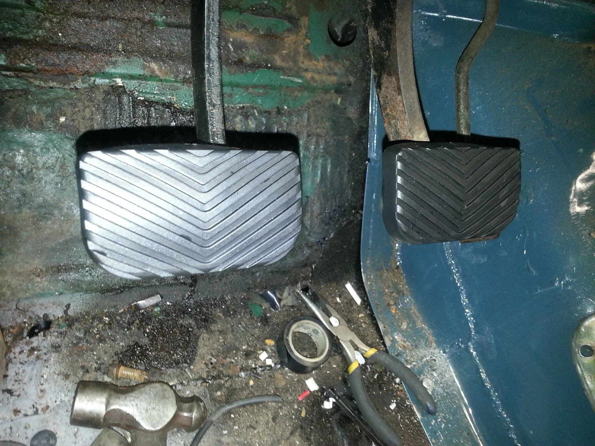

Pedal pads from a stretcher...fit just about perfectly :lol:
1940084
1940087

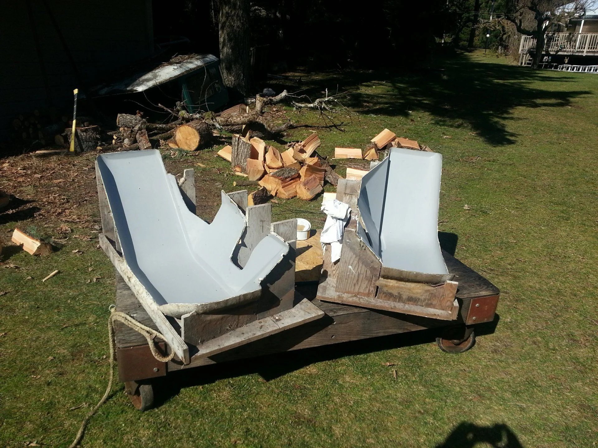

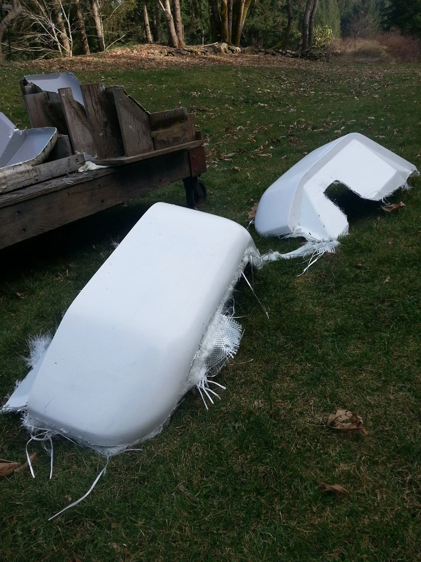

As my mom would say looking at her offspring, not my finest work, but I'm not going through that bull**** again. Might be the last time for the molds, getting a little beat up, but other than some cosmetics the fenders turned out not too bad.
1940090
1940098

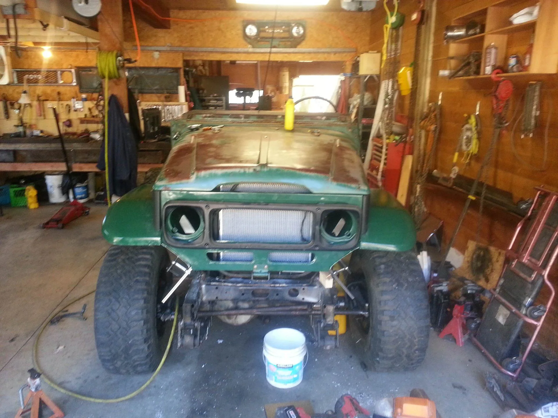

Been a while since I had to align a 40 clip. Still a pain in the snapper. the fender supports aren't in yet so it's all a bit wobbly, but getting there.
1940091
