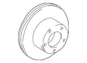

ROTOR
Part Number: 42431-60281

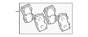

BRAKE PADS
Part Number: 04466-60070
ROTOR
Part Number: 43512-60171
FRONT PADS
Part Number: 04465-60220

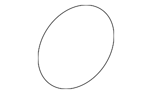

WASHER GASKET
Part Number: 43422-60070

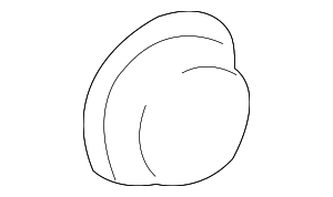

DUST CAP
Part Number: 43423-35010

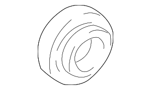

INNER BEARING WASHER
Part Number: 90214-42030

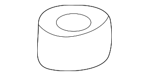

STABILIZER LINK UPPER BUSHING
Part Number: 90948-01003
