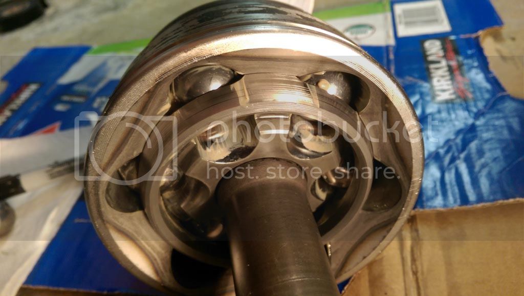

Does this look ok?
People recommend using brake cleaner to clean out the CV grease. Only issue is it doesn't work very well dissolving the grease. It just seems to blow it around. I cleaned out the outer side the best I could (used three cans of brake cleaner) but there is still grease. Is this good enough? Any harm in having a bit of brake cleaner / CV grease residue in there?

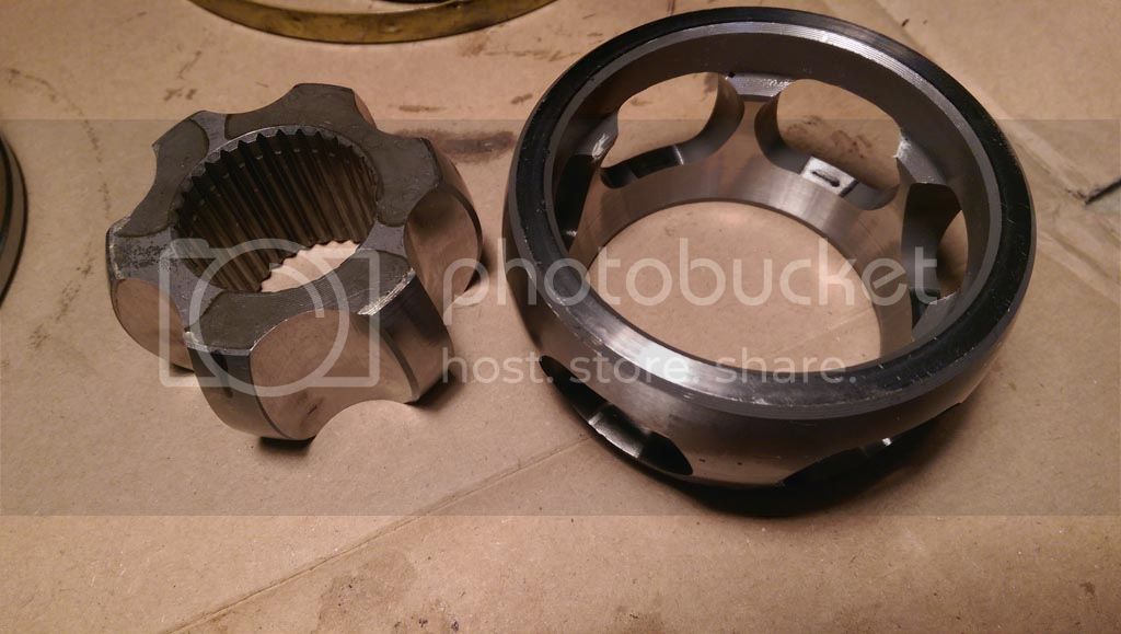

And in the process of cleaning, I lost the match mark I made on the star race. I remarked where I thought it was, but am not 100% sure. Is there a way to tell how the parts should be aligned? How critical is it that they go back in the same location?

FWIW, I used about three cans of brake cleaner on my passenger side and still had a little grease in there.
From what I've heard, it is important to line it all back up...but unsure if it is absolutely imperative. For future reference, I typically scribe with a dremel to mark things. Good luck, sorry not much help from me
My first CV joints job, I also used Brake Cleaner and had same issue you're seeing. I've now put 100K miles on that front axle, without issue. The Brake Cleaner will evaporate in minutes. So as long as no grit entered while cleaning you'll be fine.
These days, I always use a degreaser from NAPA ($$), rinse with high pressure water then blow dry with high pressure air all bearings. With the needle bearings, I repeat two or three times. Most shops' don't even clean bearings, as it saves a great deal of time. They justify this by saying re-calcification. I don't subscribe to this technique, as I can't inspect clearly. Additional I've seen heavy scoring on bearing & bushing with missing seals, where bearings became contaminated.
I too, have had ink marks wash away, so I now scribe (with center punch) parts. Look really close under different lighting, you may find your mark. If not, then nothing you can do but assemble CV bearings the best you can. You'll know by excessive vibration if any issue, but I'll bet it will be fine.
