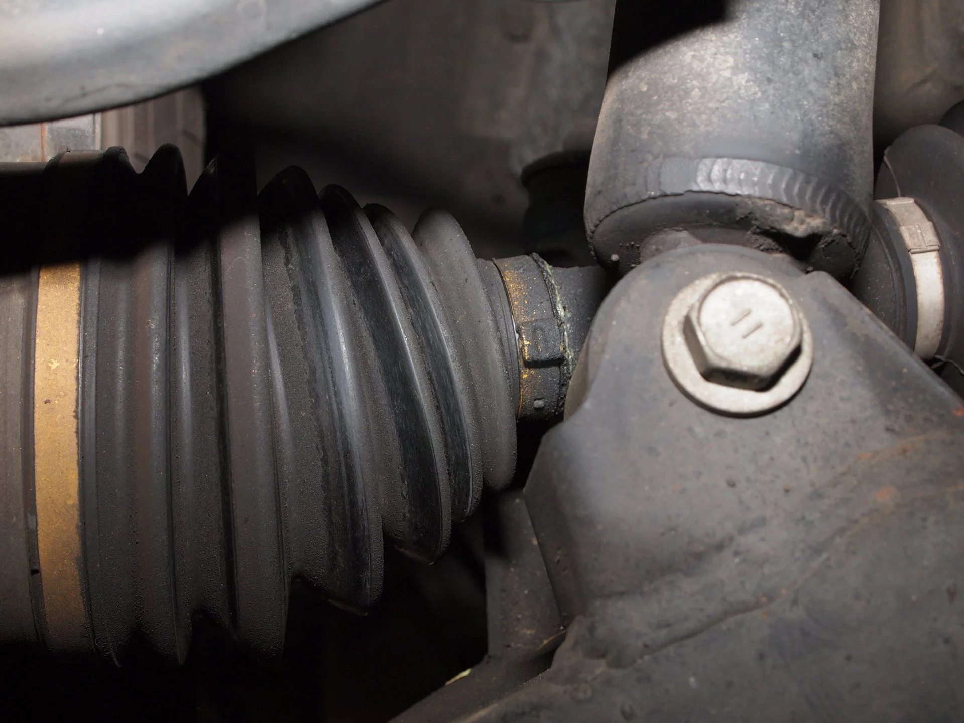

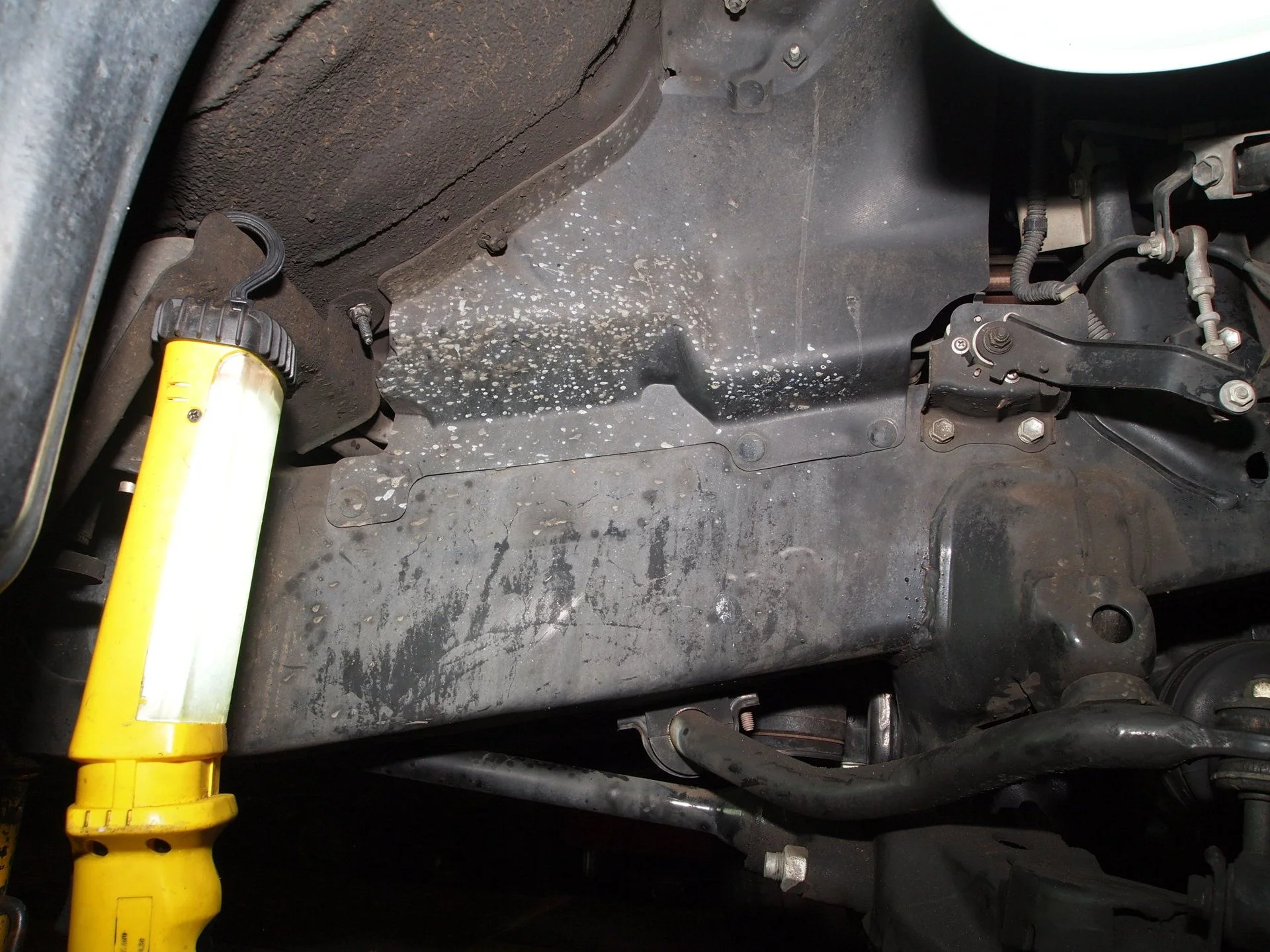

If the amount of grease seen slung around fender well is minimal, which is normally the case when seepage from loose clamp.
See white spots CV lube in fender well. You can have about 4 times this before rebooting or adding grease.
Seepage from under clamp.

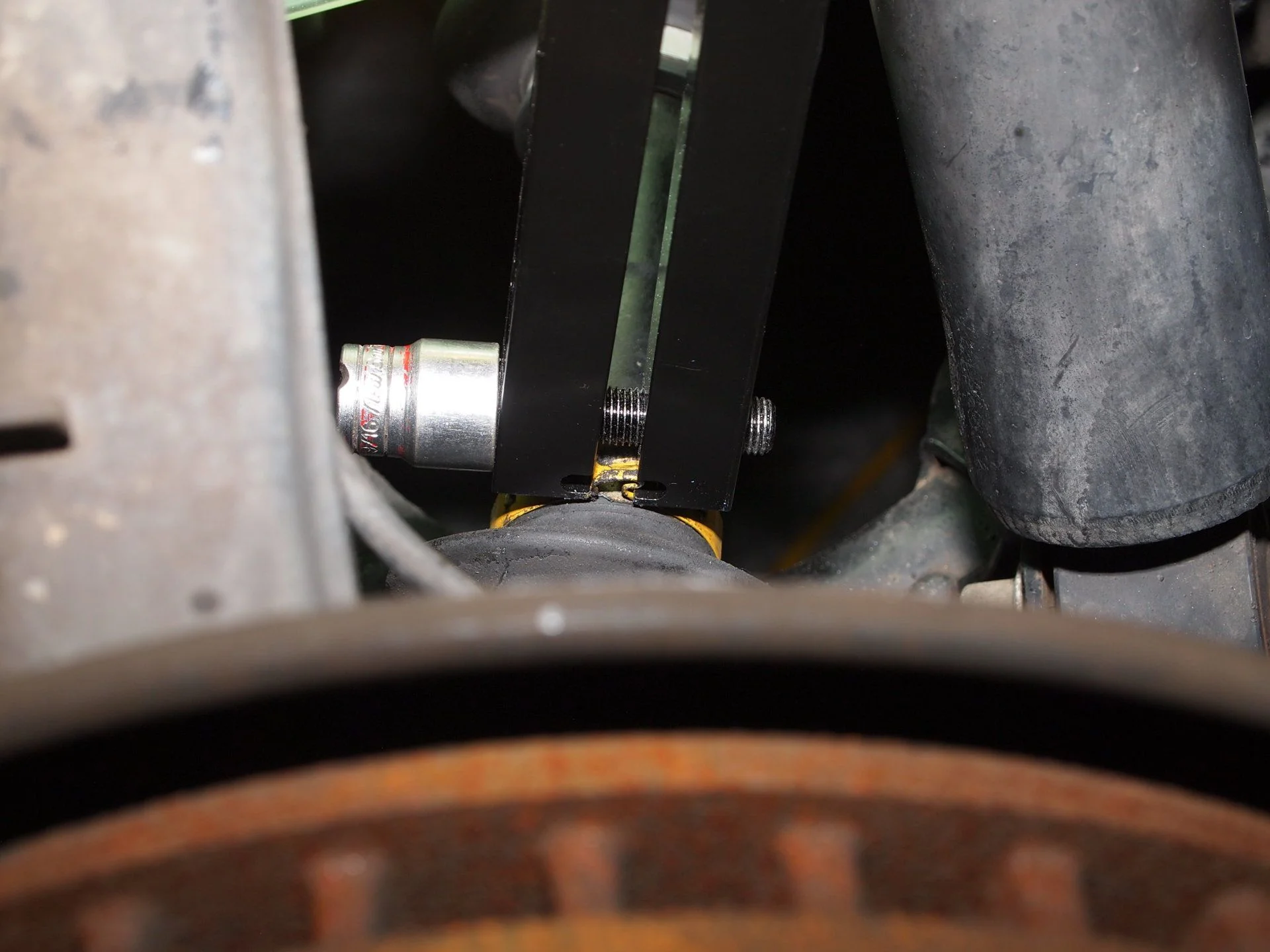

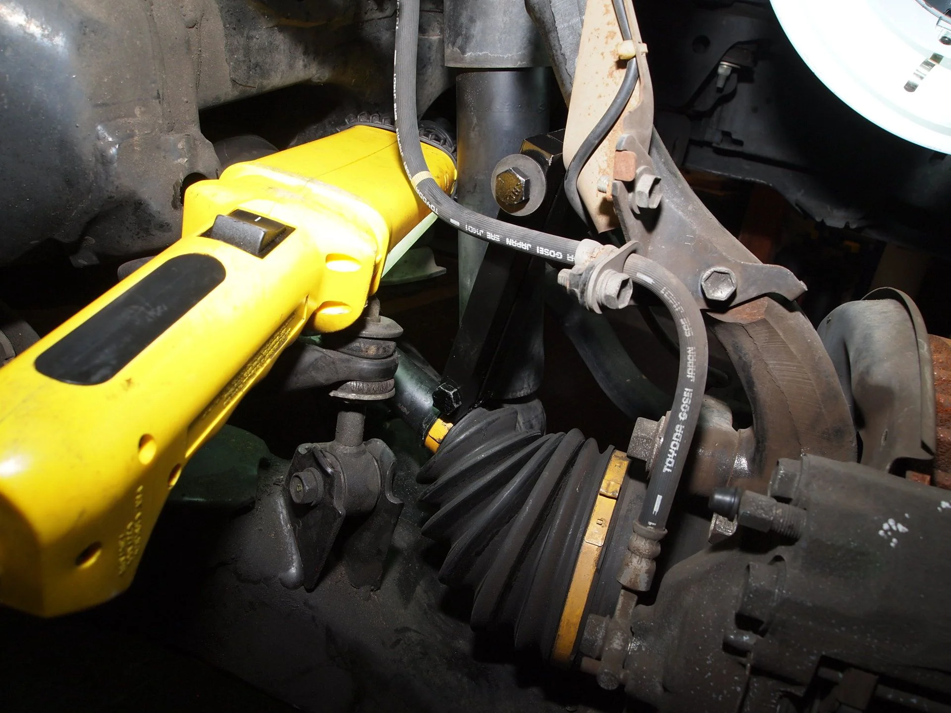

Just re tighten the clamp
