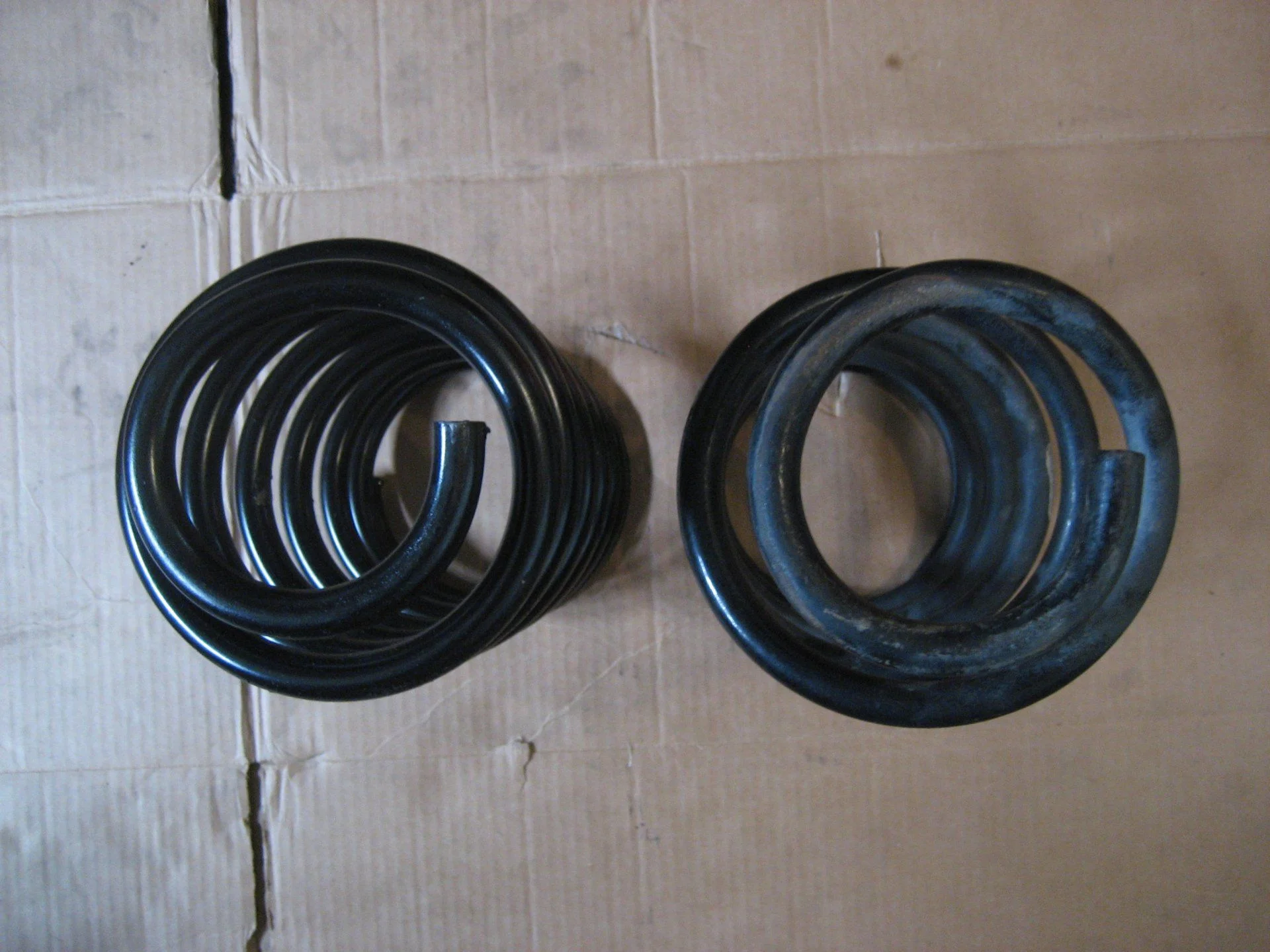

When I pulled one of the 2010 FJC TT rear coils and laid it next to the new coil, I thought - o crap. The new coil is slighly shorter, but has more wraps and appears to use slightly larger diameter steel. I don't (yet) have a caliper to measure, but will pick one up tomorrow to verify this.

Obligatory pics:

Obligatory pics:
