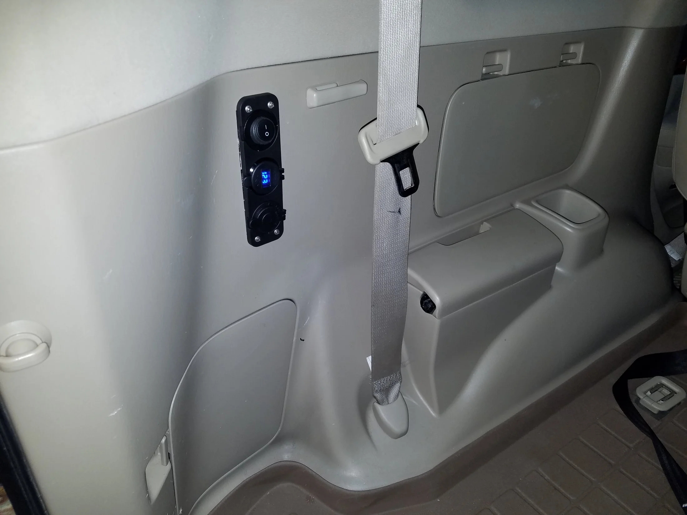

For my rig, I have a always-hot wire ran to the rear cargo area (tied into the power seat fuse with a fuse tap), and a Amazon power panel that has a 12V cigarette lighter plug and two QC USB plugs. It's switched on/off, which is pretty nice if you need to charge a phone/flashlight/radios/etc when the rig is parked and not running. I have it switched off except for when I'm charging something. I cut into the side panel plastic with a Dremel and then screwed the plate into the plastic. It's grounded to a bolt in the jack storage area. This was actually one of the first "mods" I did to the rig.
