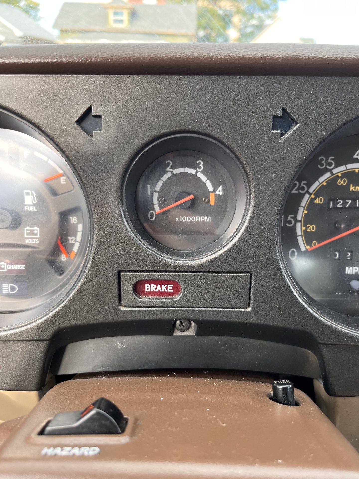

Just looked at my 60s gauge cluster, and there is a spot that would work.
It‘s the insert piece under the RPM gauge.
You could pop that piece out and fit a similar display assembly to it‘s place. The only difference would be that only two display would fit in there. The two indicators on the OEM piece could be wired into the displays along with any other sensors you would want.

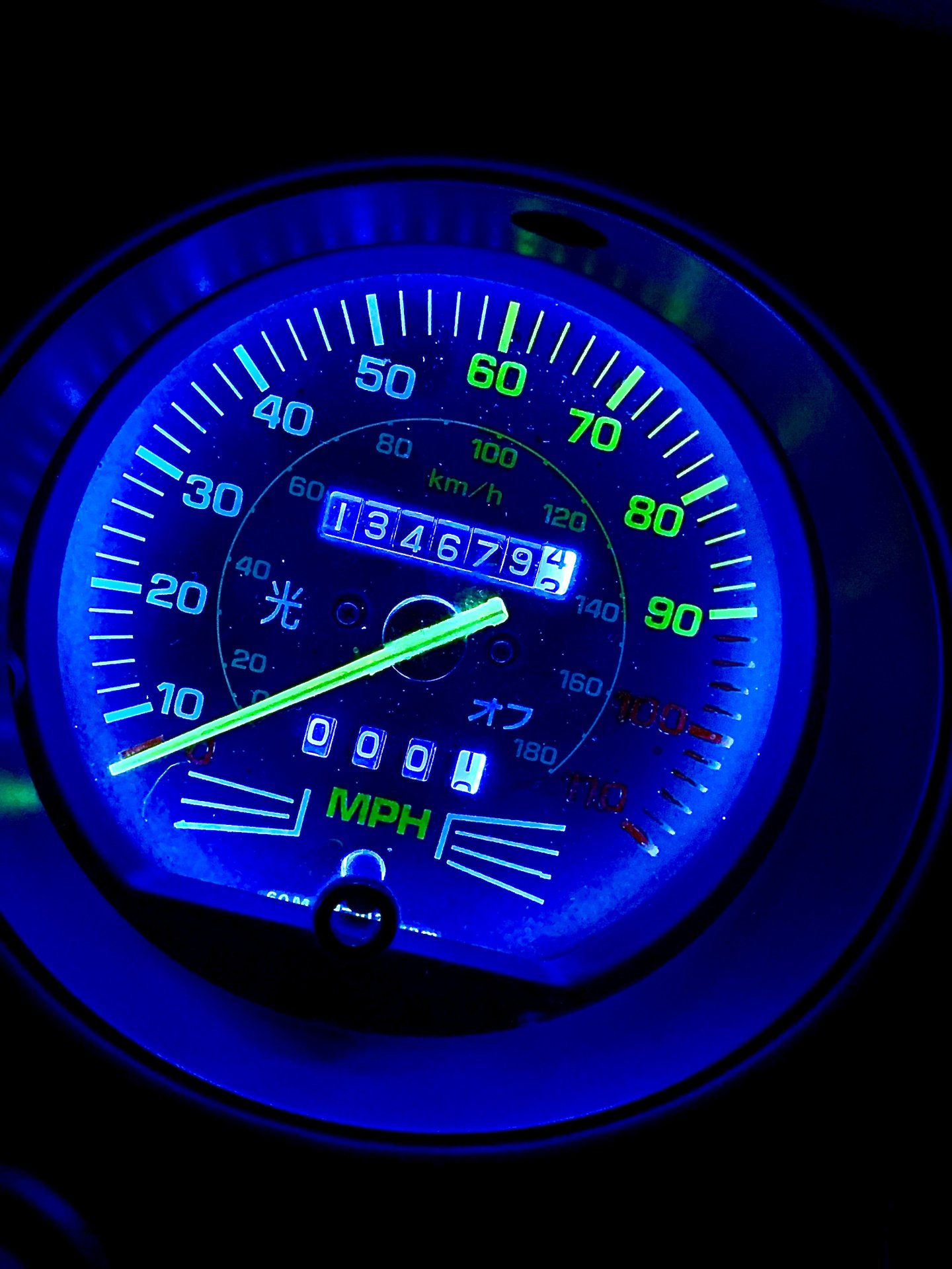

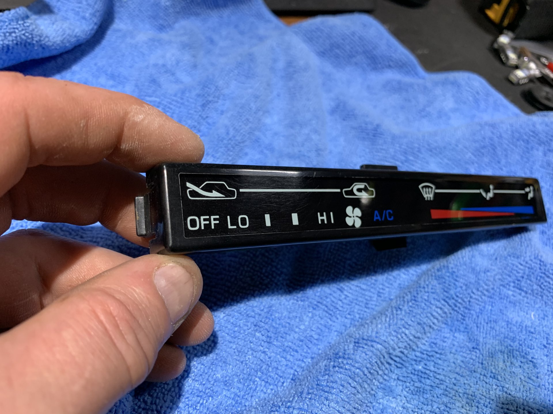

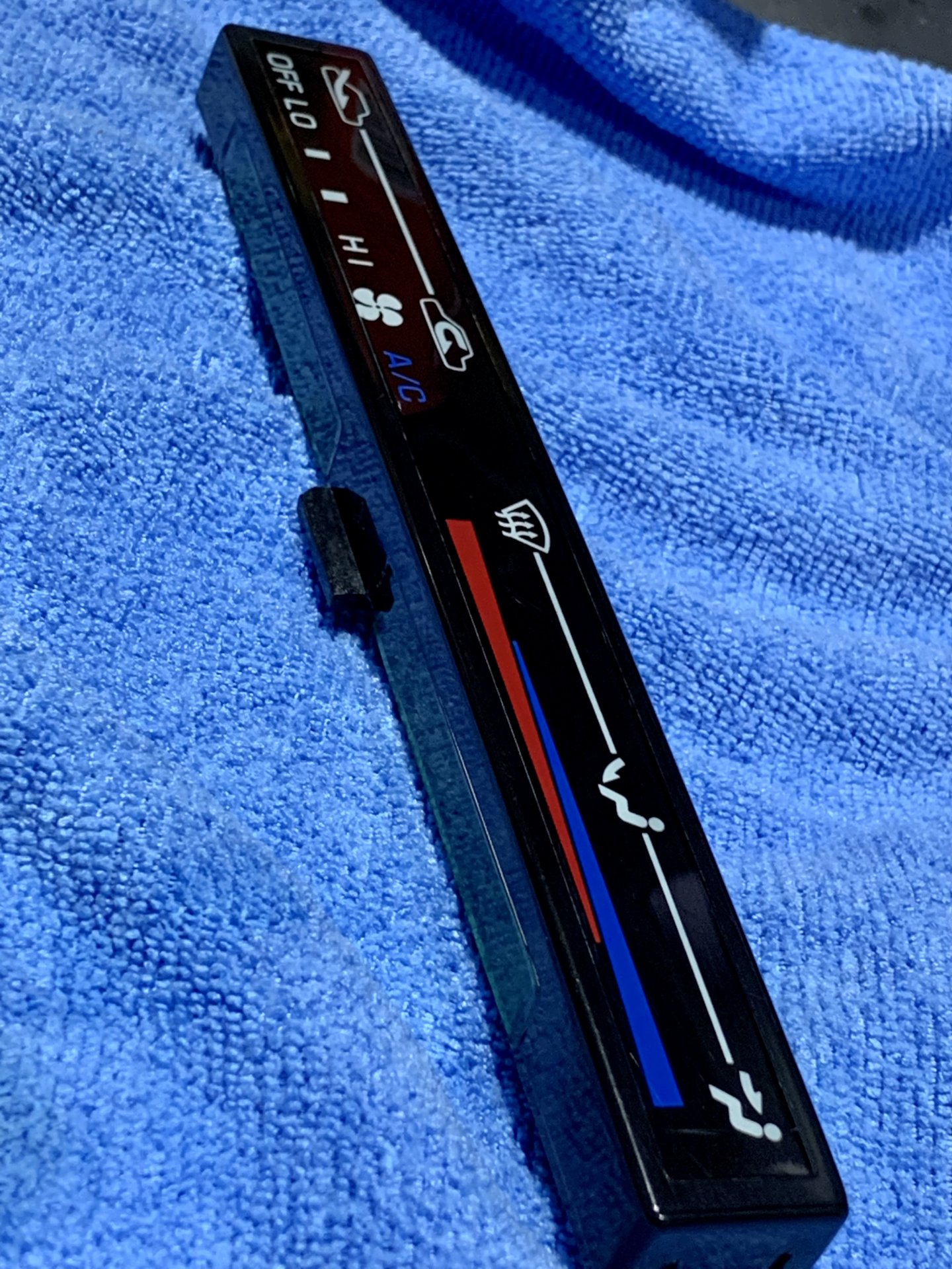

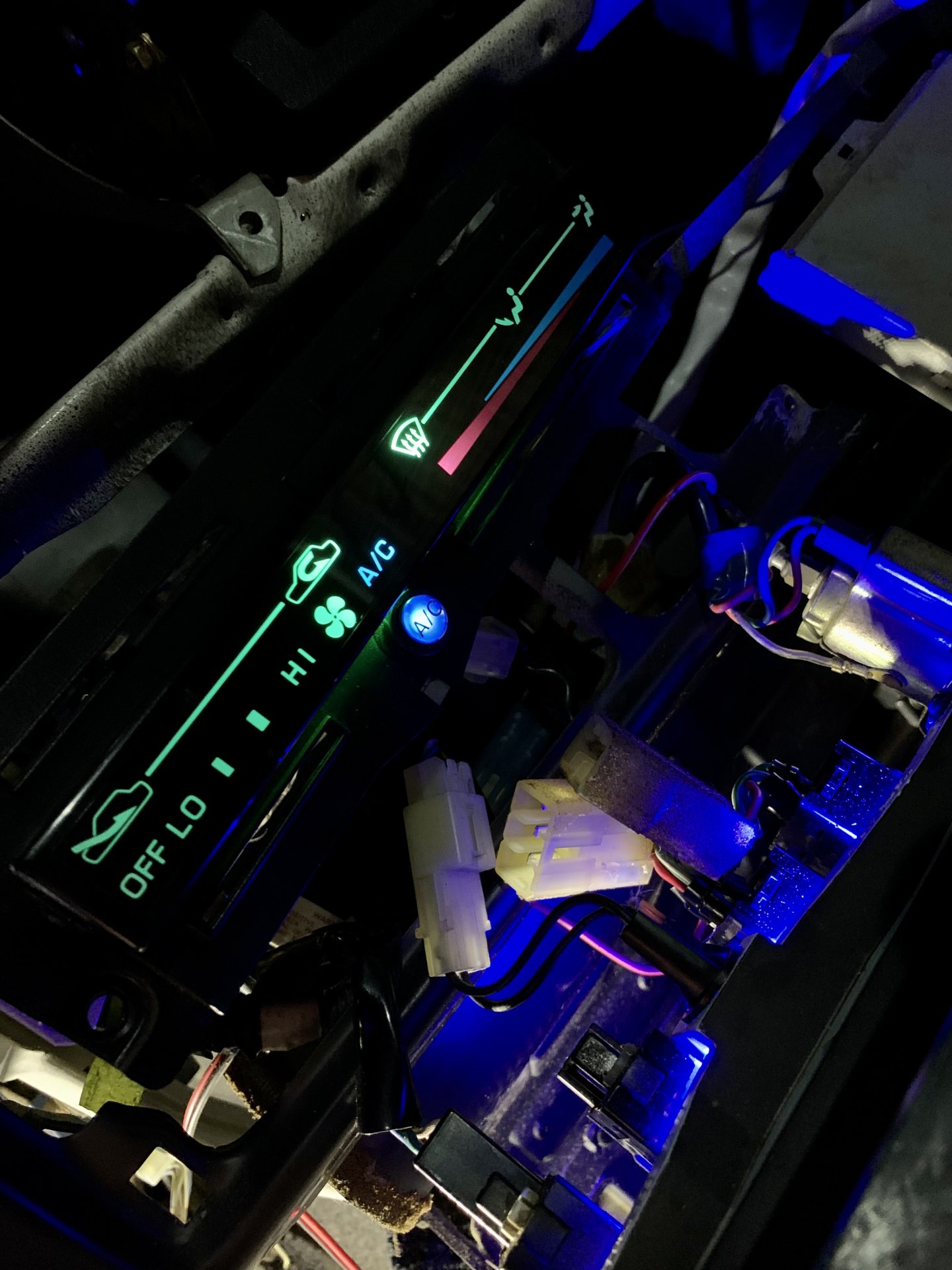

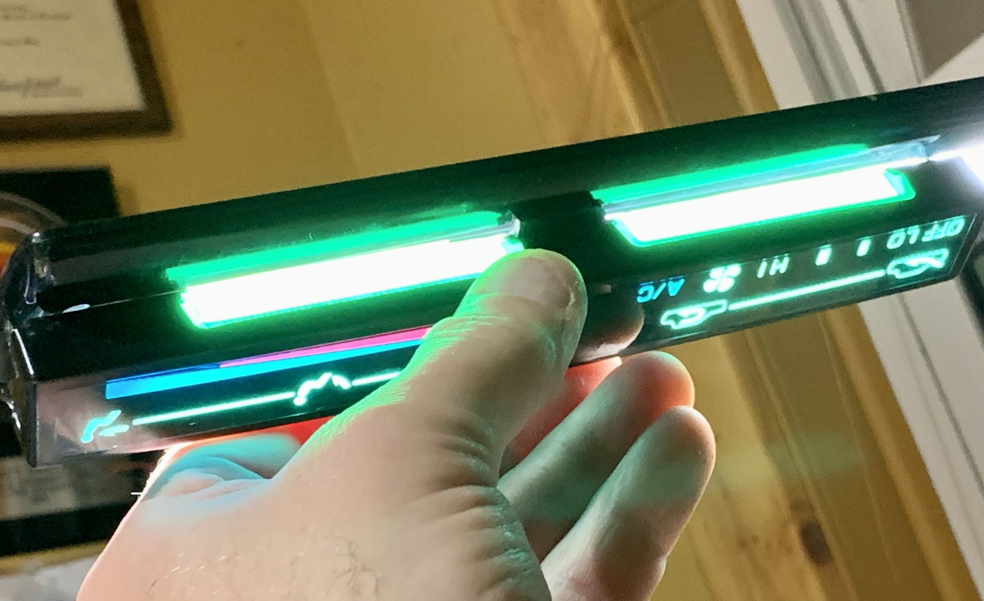

Since we’re on topic here :
I really like this new concept vision idea above :

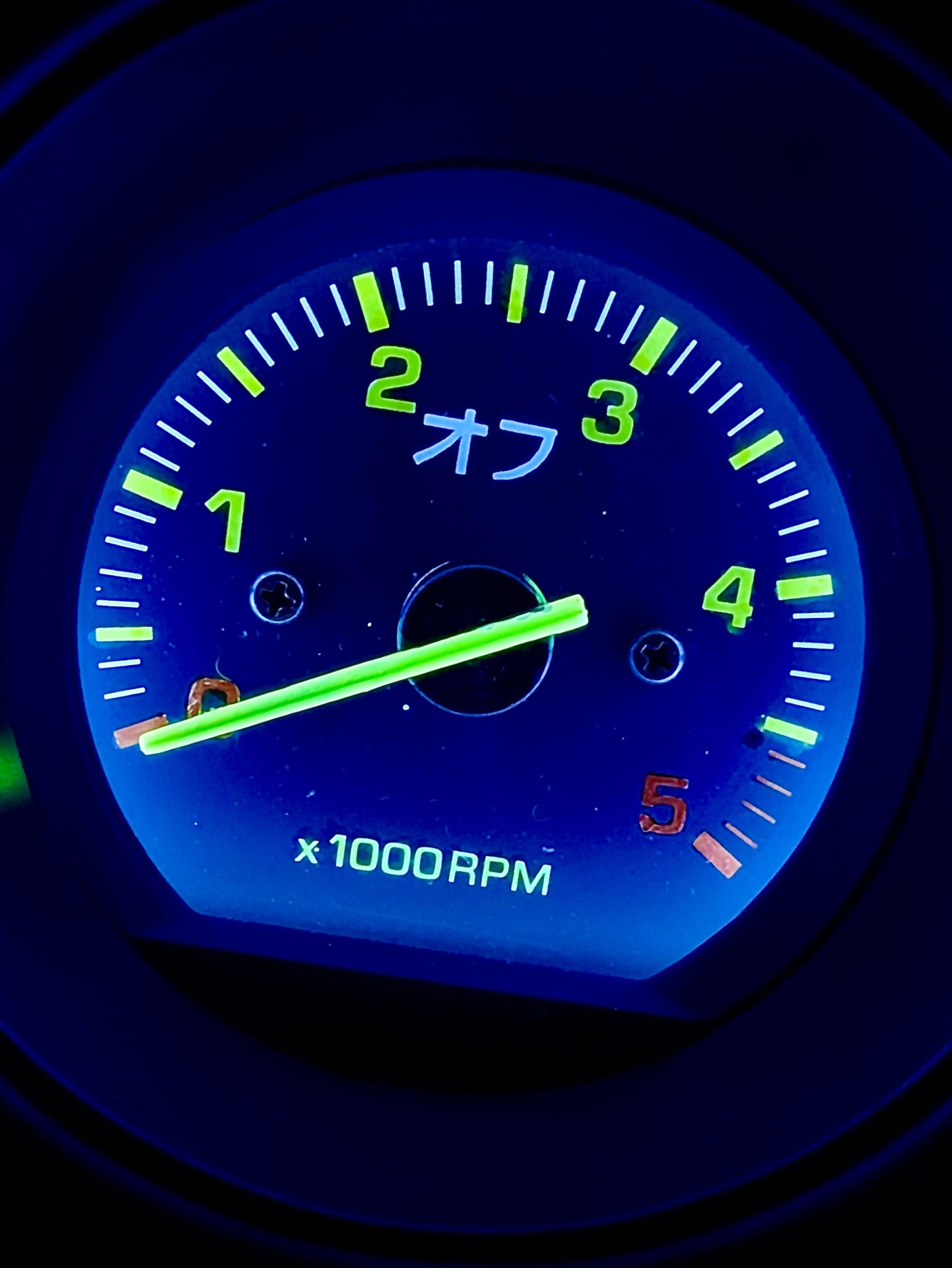

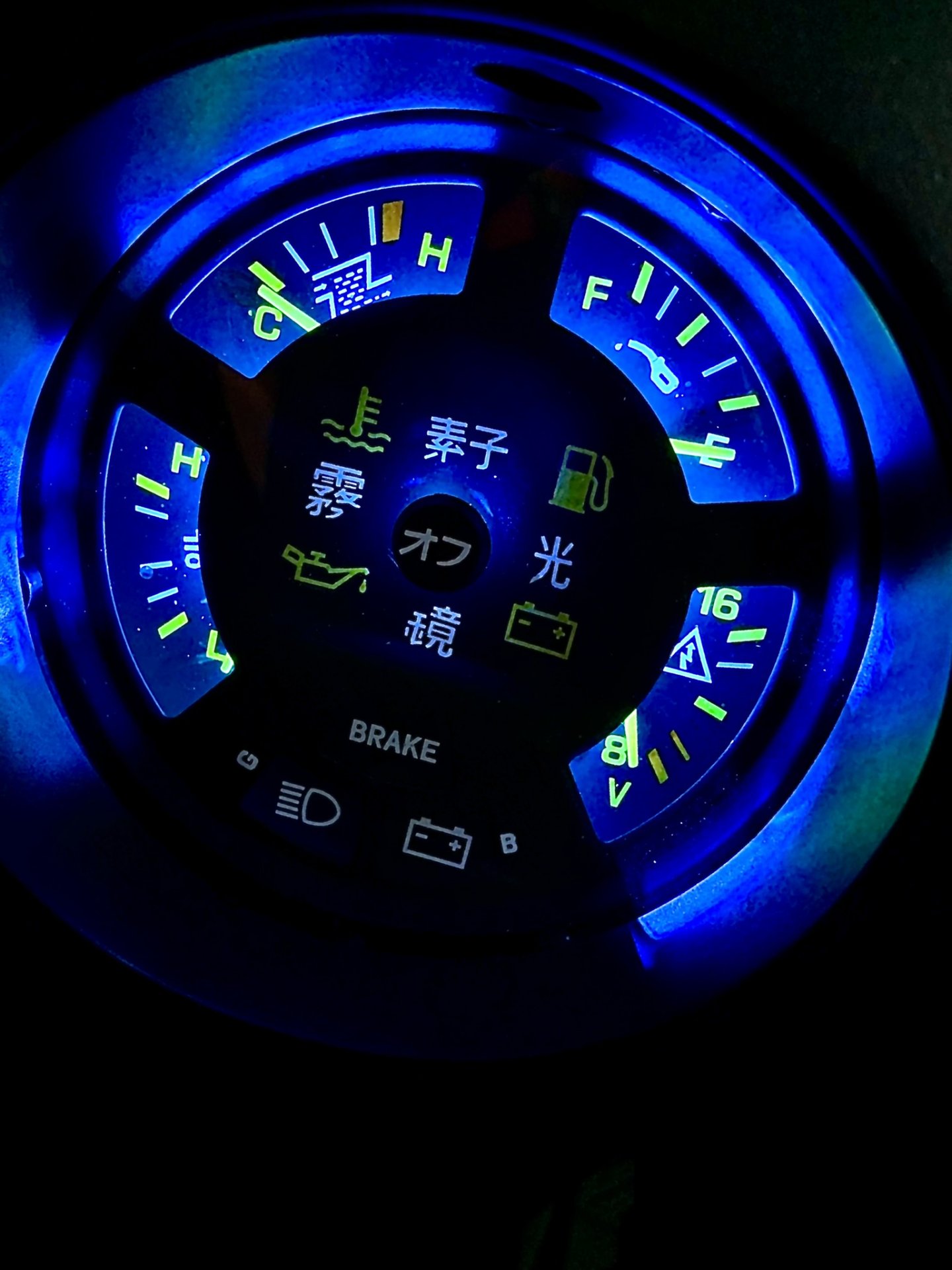

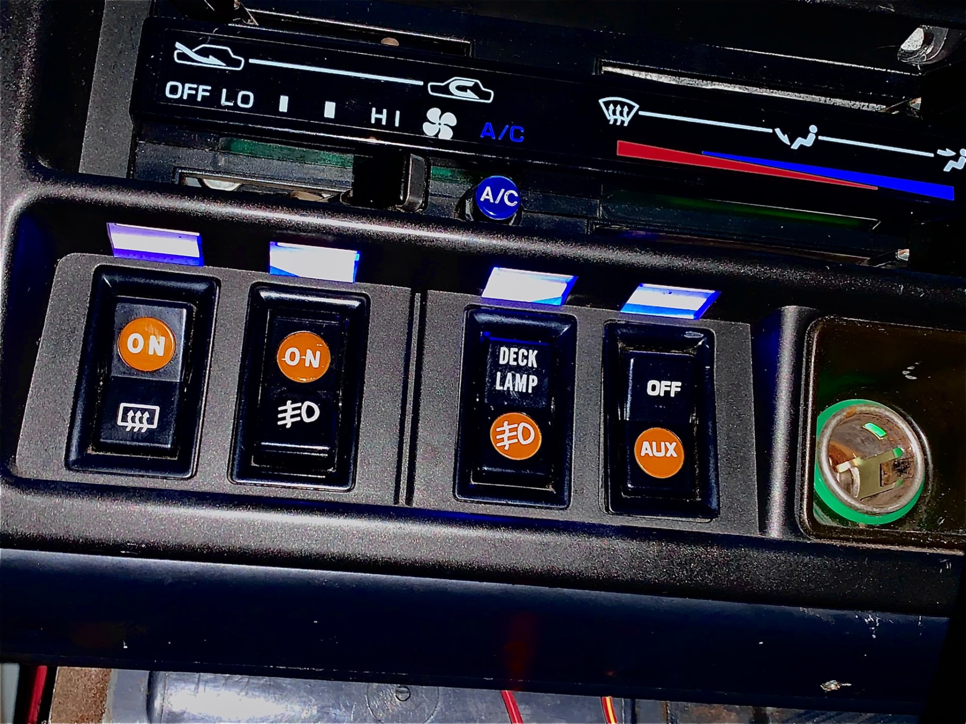

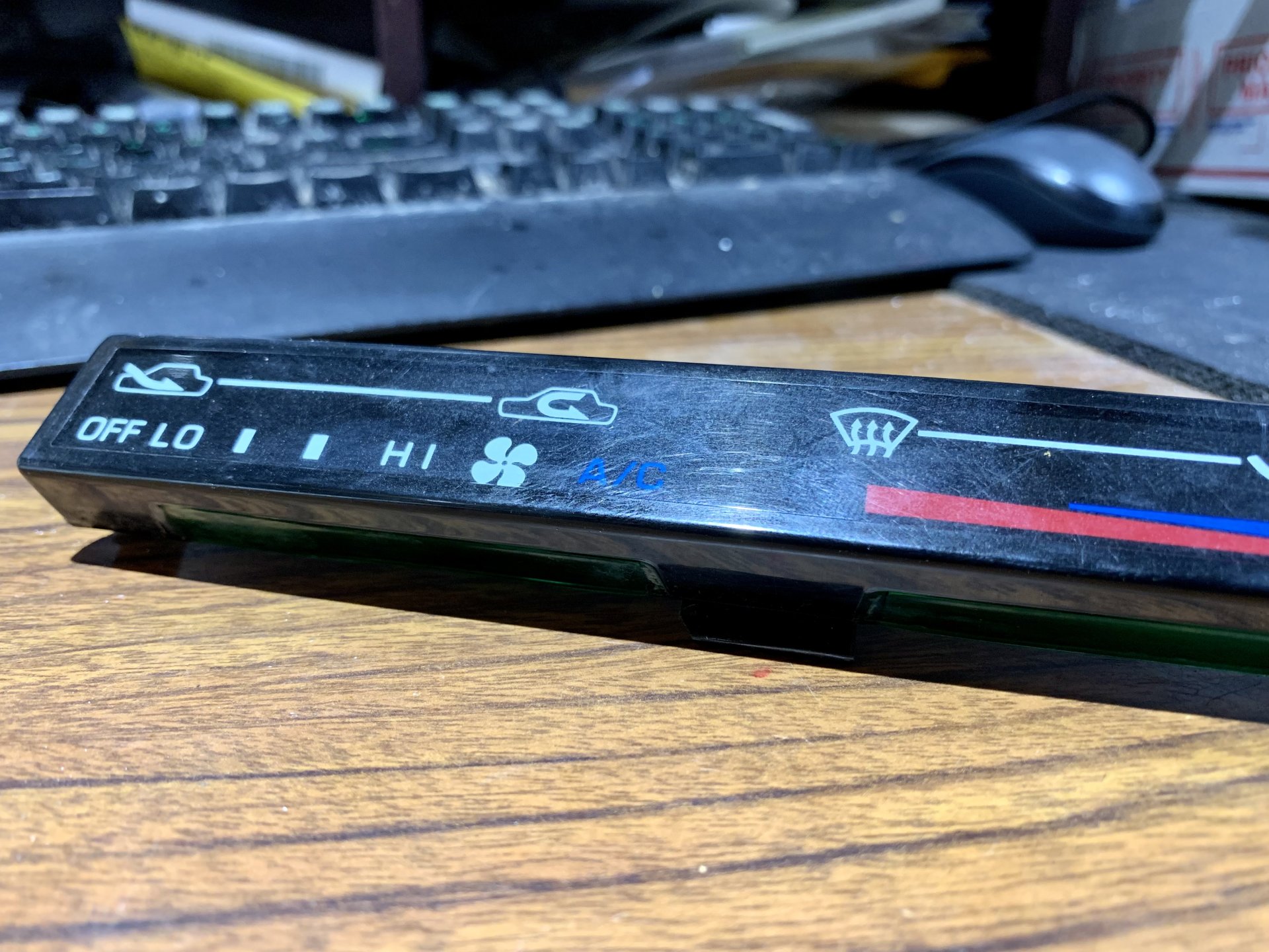

I have explored some un-charted territory here recently in my 62 gauges cluster and HVAC panel w/ LED updates and some HJ61 japan spec sema-spec concept visionary free form ideas …
I spruced up my HVAC panel and switch panel illuminated shades also updating ALL old filiment bulbs to FULL on LED including the A/C blue push button switch itself
The Cement Ghost is now 💯 % LED inside and out ….
Some before and after tech pics ..

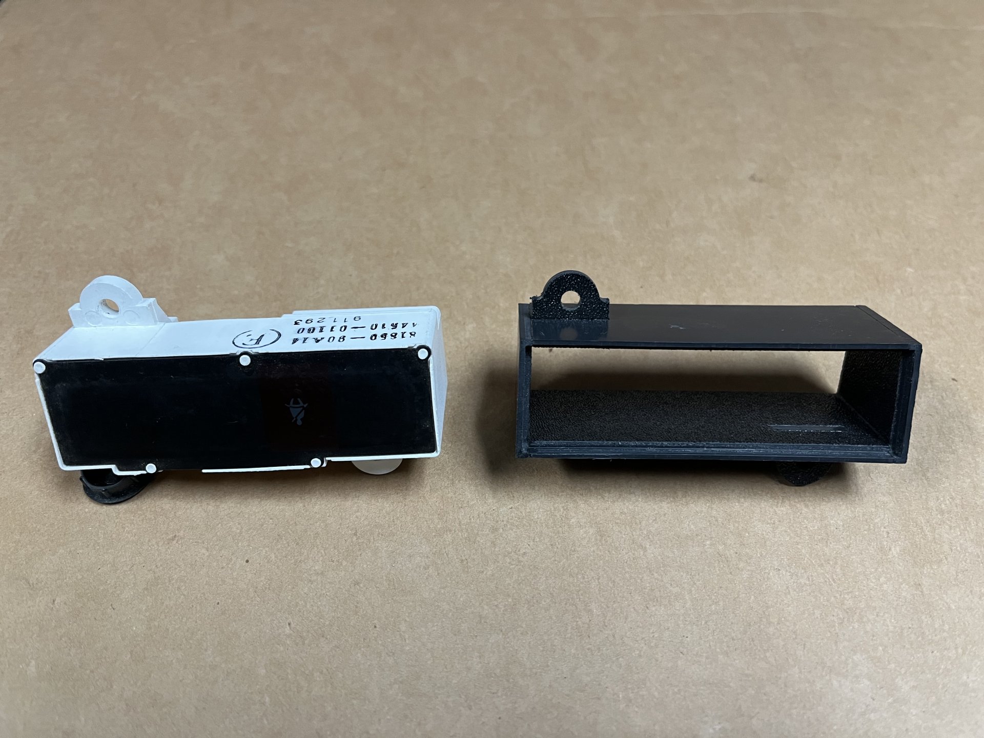

This is what goes into the housing on the gauge cluster.
Three .96“ display and some other parts to make it work.
The cable on the right is that one that runs between the display and the hideaway unit.
The gauge cluster installation is straight forward, just plug and play.
All the sensor wires will go to the hideaway unit, it will be a small around 4”x4”x1“ box.

Additionally, here’s the dash slot in question in my 1982 60:
This looks less wide than what you have. I have a spare gauge cluster I can send you if you get serious about making this a kit. That way you can template and design from it.
No need to send me a cluster, I took one of mine out so I can take a better look at it. ( Appreciate your offer )
It looks the same as yours other than the second indicator.
