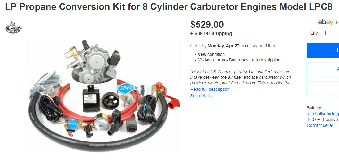

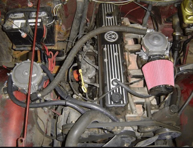

Propane is probably an easier route. The 2F motors are used in forklifts with gas/propane options. My Dad's Toyota Forklift is setup this way.
Propane has 27% less energy as compared to gasoline and it has an octane equivalent to like 110 or so. Hence @F226continental 's reference to needing the high comp engine. However your 2F will surely run on propane and it won't be knocking any time soon. It will likely have cleaner emmissions and could be a good way to go if propane prices are low. Propane used to be a lot cheaper than gas and thats when all the propane conversion kits became popular...there was a woman in the next town over with a red inernational Scout who worked at a local propane supplier and her truck was converted to run on propane....the mpg drop was easily offset by the difference in fuel cost.
high compression somewhat offsets the 27% loss in energy Seth refers to. Propane and e85 have less carbon, which is less energy and less pollution
