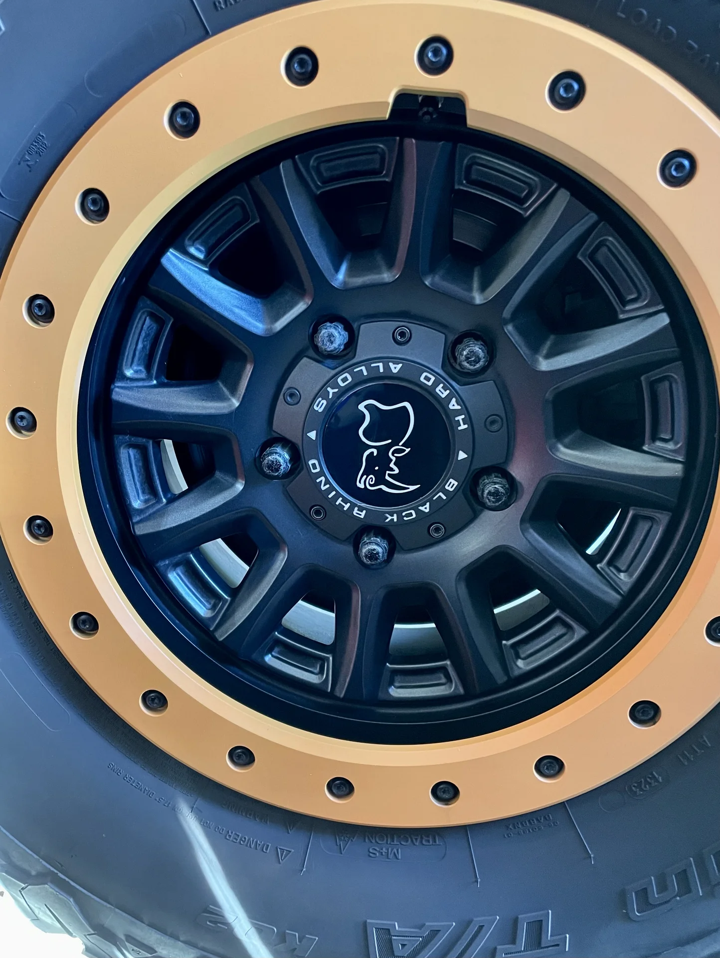

Has anyone tried putting Land Cruiser wheels (specifically LC200) on this trailer? I have ordered 7 of these special wheels and of course I want everything to match. The reason I am stoked for this wheel is because it's the only one I've found in a LC200 bolt pattern that has a removable "rash ring". With the ring removable, I can easily sand and paint it every time it kisses rock.

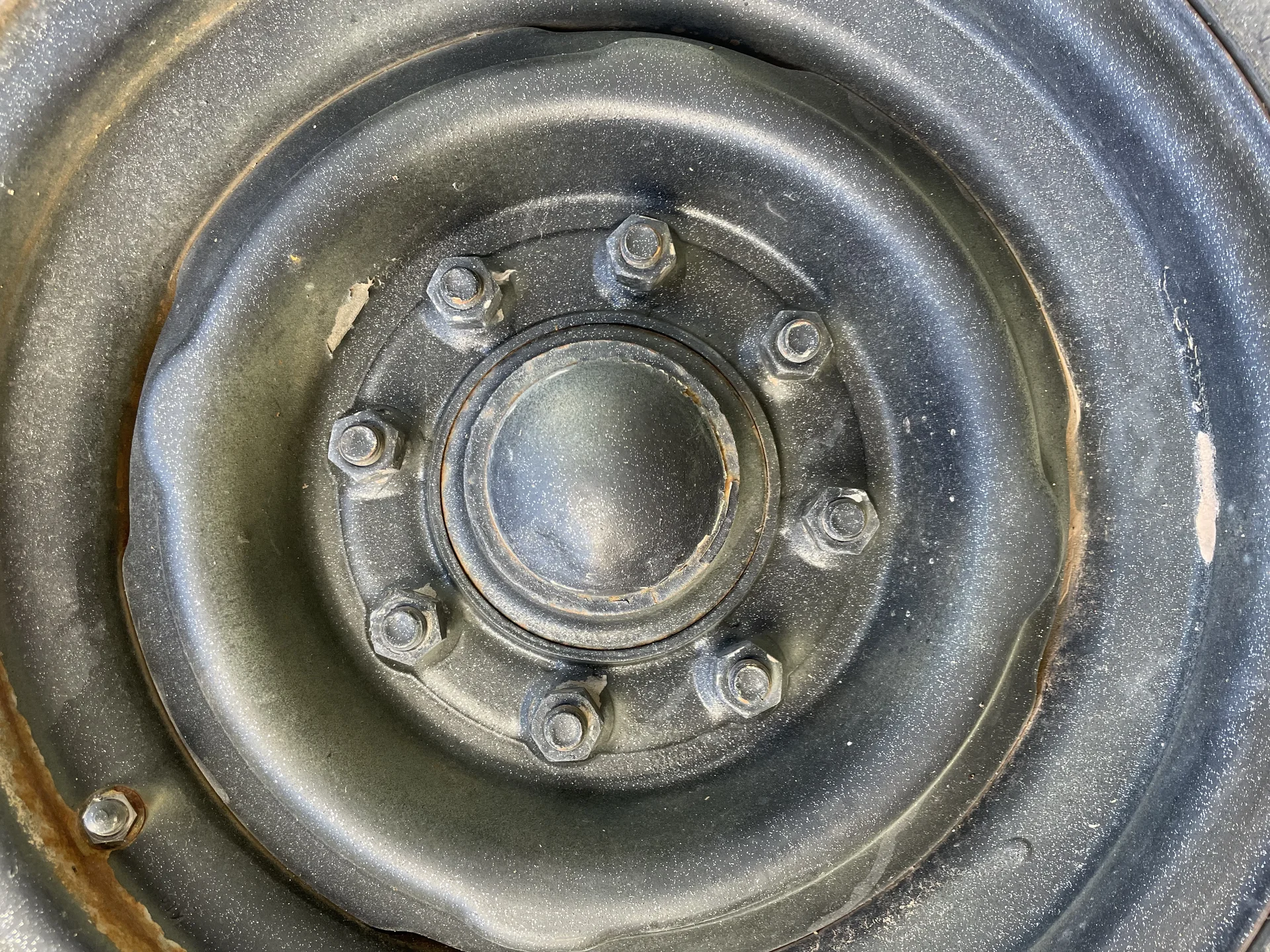

I wanted to refresh this just in case there's any new ideas. I have worked at it a bit, but not much. I have two 35" tires now mounted to these wheels and they've been living in the garage taking up room. My goal is to step up my efforts and maybe drive to a few trailer/axle shops with the trailer next week if I have to. (I did it once previously, but only to a single shop that wasn't much help)
I am trying to go from 8x6.5 to 5x150. Preferably keeping the hand brakes that come on these military trailers.

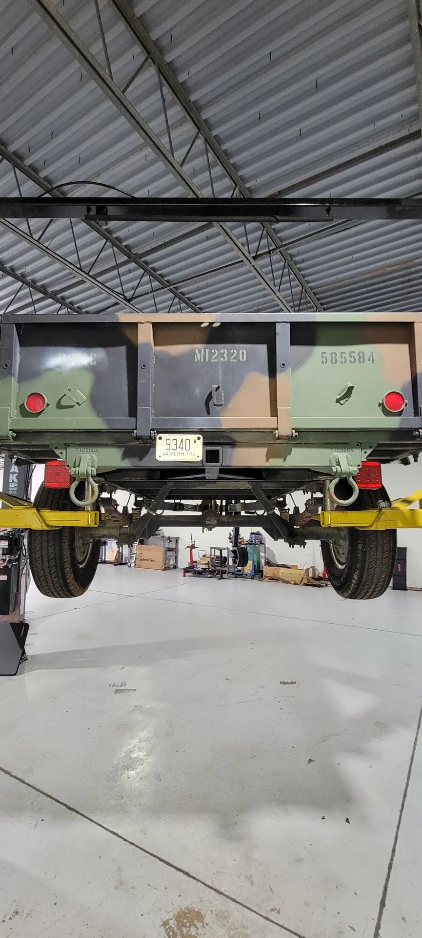

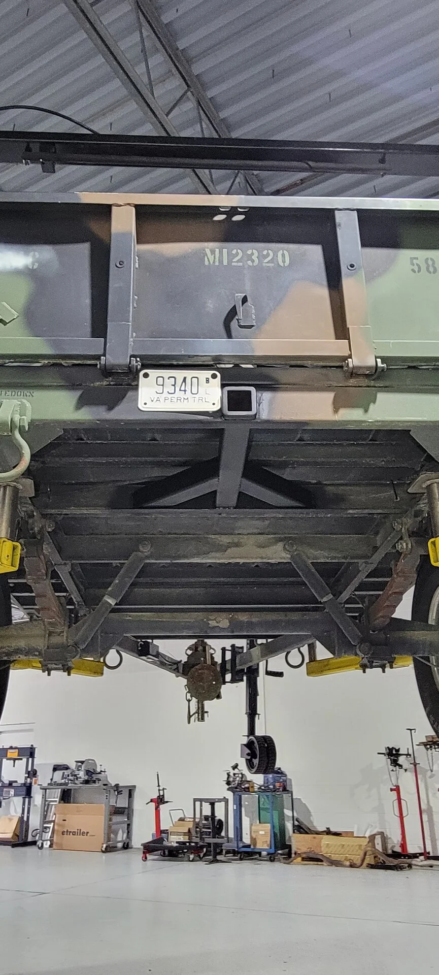

that 2" receiver is clean. Have any further details on that mod? I have considered this many times and just never did
Just ordered a 48" receiver tube from etrailer, measured from outside of the rear rail to the next one in and cut the tube. Used the leftover for the angle peices. The hitch pin hole is on the inside but is actually easy to get to. I wanted to be able to still completely open the tailgate without any interference with the tube, I think I ended up with like an 1/8" gap!
awesome man. that is exactly what I need

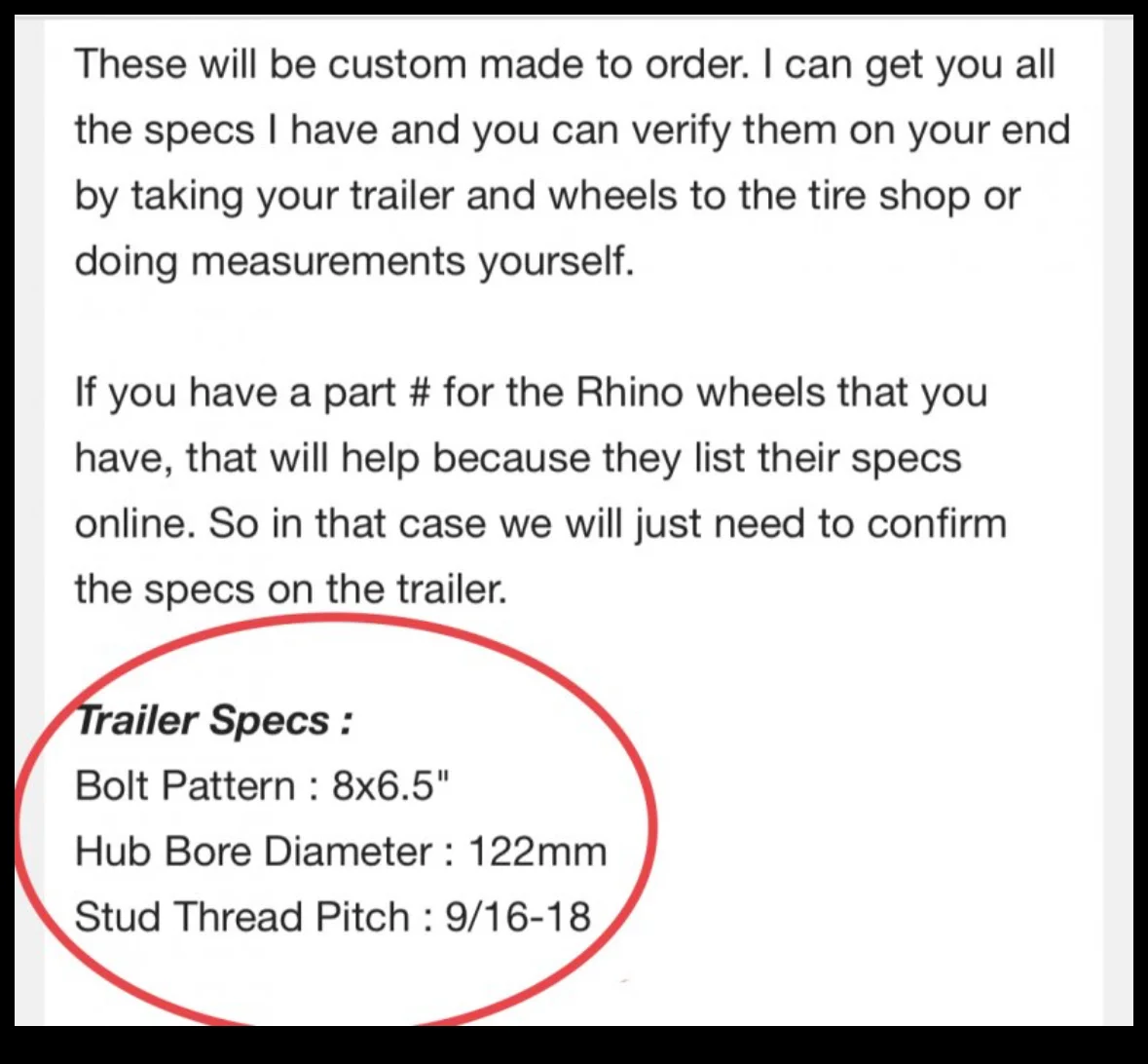

I’m closer. Can you guys help me confirm these trailer specs? It looks like I finally found a company willing and able to build an adapter.

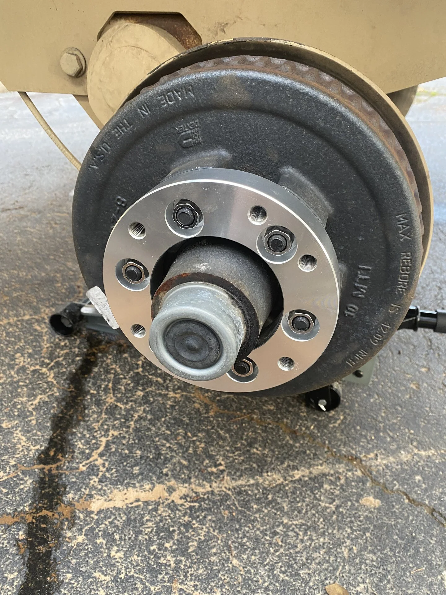

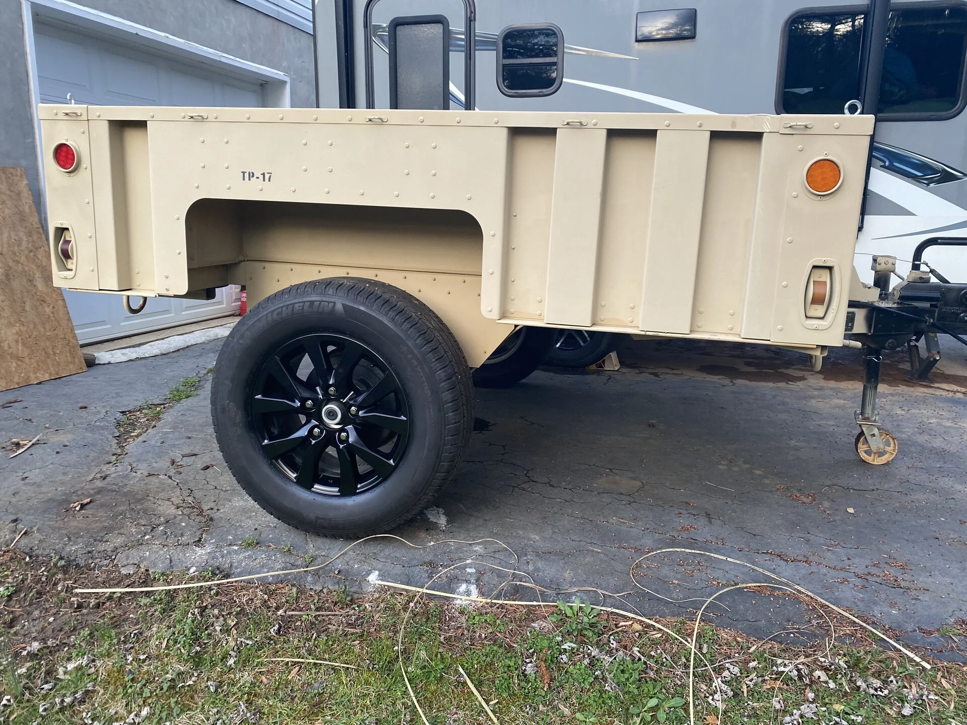

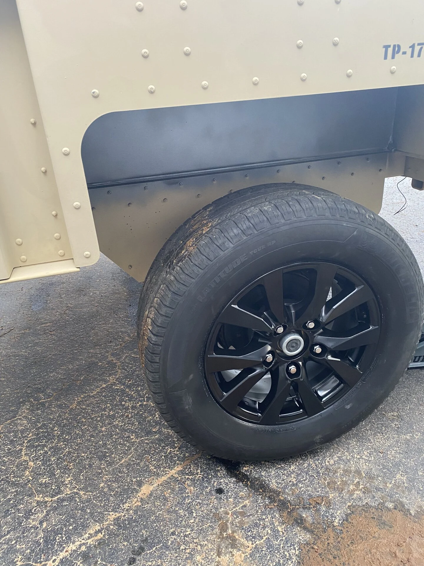

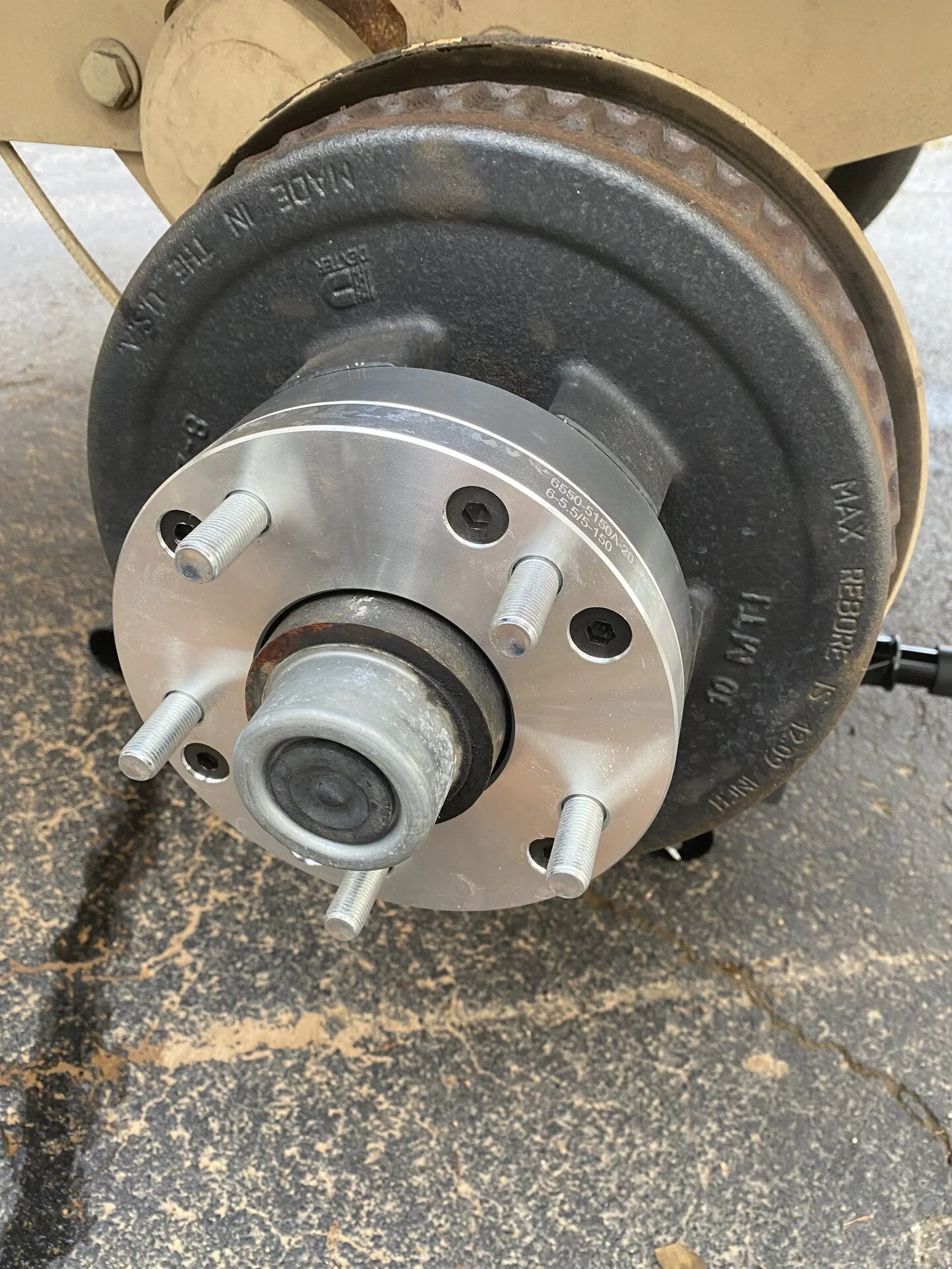

I just bought an M1101 and it already had the 6-lug hubs so I bought the wheel adapters in the thread below and they worked. The adapters say they come with open-ended lug nuts, but they DO NOT. I’ll post what I ordered below. The hubs you will need are listed in the Expedition Portal link. This worked well for my M1101 and Land Cruiser wheels from a 2018.
Open-ended lugs for adapters
OMT 1/2"-20 Open End Lug Nuts... https://www.amazon.com/dp/B083WFT7JQ?ref=ppx_pop_mob_ap_share
Lug Nuts for wheels
20PCS M14x1.5 Lug Nut - 7/8" 22mm... https://www.amazon.com/dp/B0C5QNJNSD?ref=ppx_pop_mob_ap_share
Wheel adapters: 6 lug to 5 (these will be scratched bc they are shipped very dumb with no protection. Torque specs are in the ad for the open-ended lugs. I used OEM torque specs for the actual wheel lugs)
EZAccessory 2 Wheel Adapter 6x5.5... https://www.amazon.com/dp/B009N3JTQQ?ref=ppx_pop_mob_ap_share
Lug Nuts for wheels
