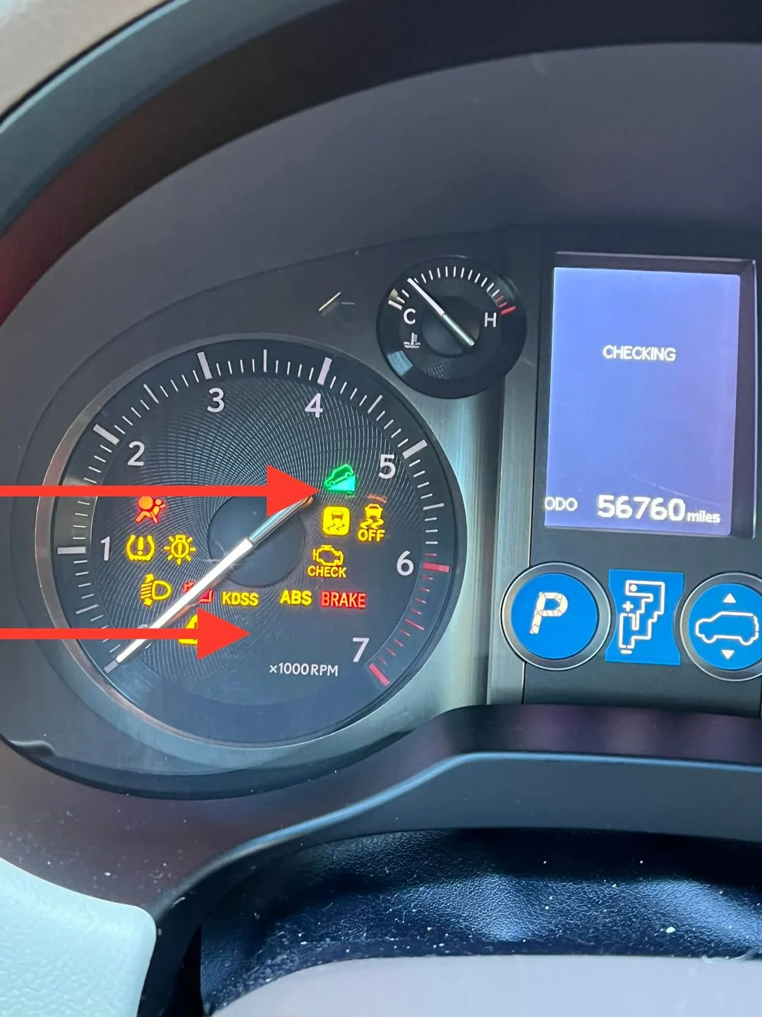

I installed Crawl Control on the wives 2016 GX460, suspension settings and 4wd work, however CC light does not come on. I had zero calibration done via techstream. I noticed the hill descent light comes on but not the CC. Is that mean I need to redo the calibration to recognize it? Does the CC light replace the DAC light when setup?
Thanks
Did you press the ON/OFF Crawl button before exiting Techstream?
Yes.. on the light question
My friend ran the techstream, I wasn't watching, my guess is no. Should I just do the paperclip trick to resolve it?
Just follow Sami's video and that should get it working for you with paper clip method. Pay attention to orientation of OBD to ensure you are using the correct pins.

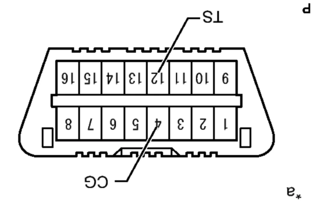

Looks like the paperclips go on the #5 and #13 pins on the video, I've seen documention for #4 and #12. This is for a 2016, can you verify what pins to use?
I'm good with techstream, and the paperclip method is way easier.
