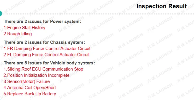

I know Techstream can be a little hard for some people to set up. I hated having to have a laptop for it so I grabbed one of these and it will pull the all the codes that a regular OBDII reader misses. Mine has reprogrammed my TPMS for my new wheels and helped me test my sunroof motor after it wouldn't close. It also emails you a report with all the errors so it's easy to look them up.

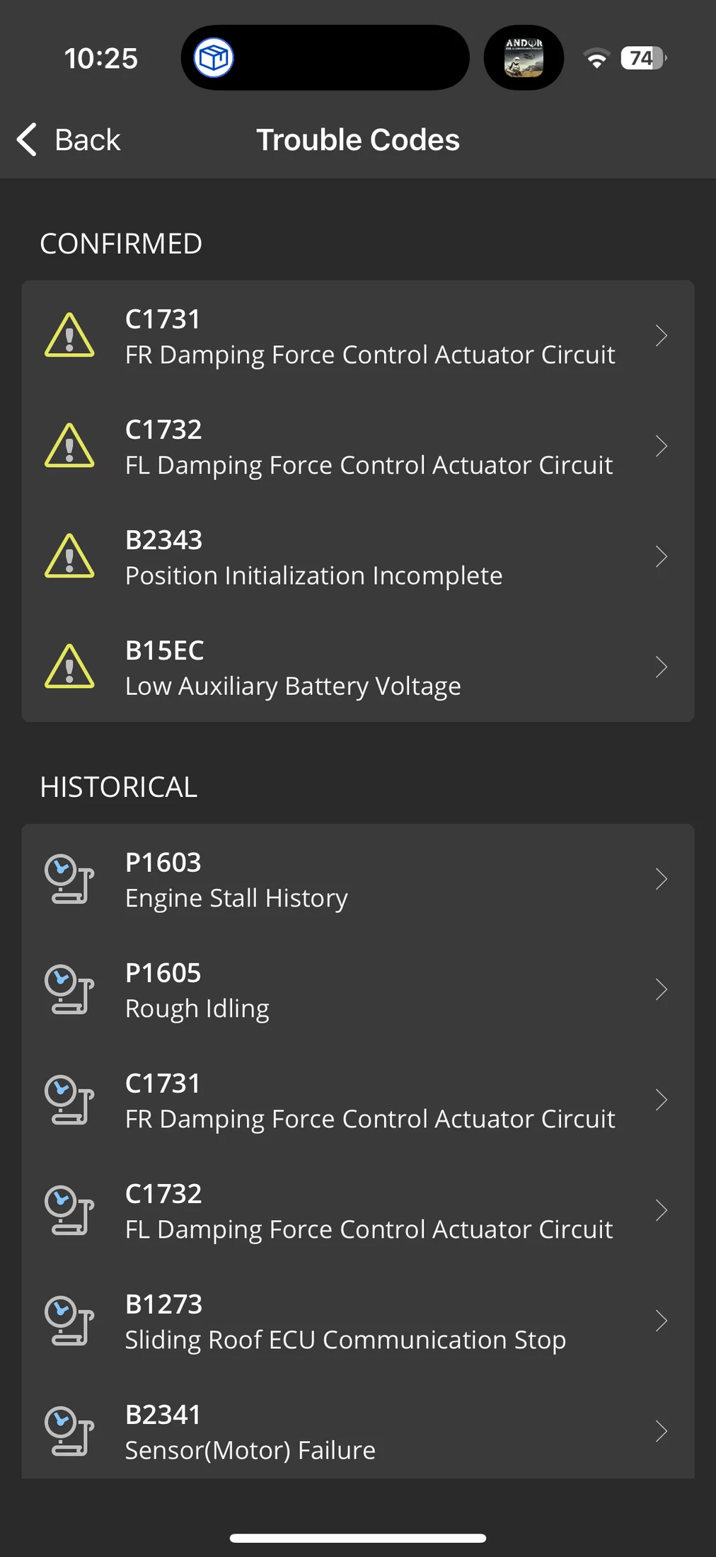

A much better option is to get a OBDLink OBD2 dongle and the free app for your phone.
It will tell you everything, along with real-time information on all your systems, e.g.: temps for: engine, trans; tire pressures and temps, every code your GX could possibly throw and an explanation of what the code is.

I have that too. I love it but I hadn't ever tried to pull codes beyond engine stuff. Just went out to see if I got the same codes and it looks like it has them. Nice. The Launch tool has more function in that it can actuate motors, program TPMS/Keys and run diagnostics that I had only seen in techstream but for this, usage the OBDlink would be perfect. Plus I love being able to watch AT temps with it.
