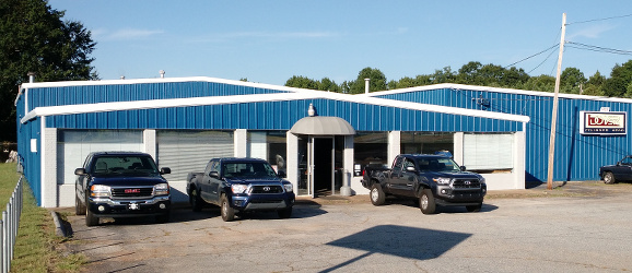

Not in CLT but I've had good experience with these guys in Greeneville, SC.
