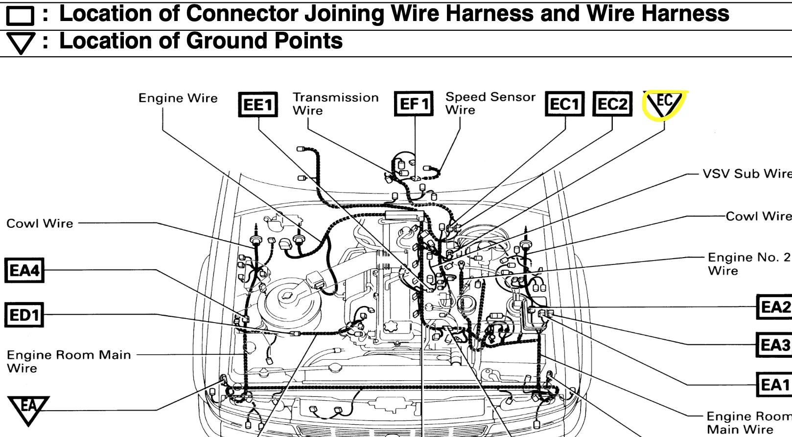

- Anyone have a pic of this EC ground point, seemingly under the intake?
