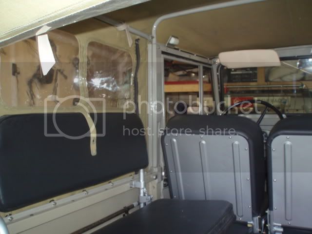

That kid in the picture is my Son now 26 'Yes that was my 66 before picture in the 80s
I used the CCOT Silver on my 66 project,Its Ok but no Cigar !
but have found a better paint closer to OEM is Rattle can, Dupli-Color T 408 Pewter is a dead match IMHO.
