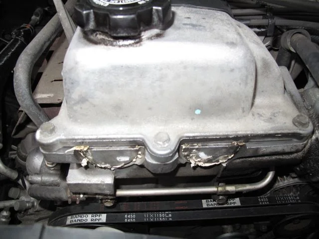

Hi all, I'm a newbie here and could use some more experienced eyes to help identify and advise on some possible issues. I appreciate any assistance :)
It's pretty much a game of what is this, and should it bother me?
I'm not sure how to get the correct comment next to each picture..
There is a white silicone type stuff in one pic, grease seems to be seeping in another... and the 3rd is of a soft rubbery substance on and around the sunroof. I assume it was put on due to a leak, but it was applied very unevenly and I can't find evidence of a leak soo.. just thought I'd ask!

pic 1. The half moons... Those are the places where (tmk) they drilled the cam journals... They need to be re sillyconed after a while...

pic 1. Looks like Sensor Safe RTV on the half moons?

pic 1: Sounds like nothing to be concerned about?

1. No worry
