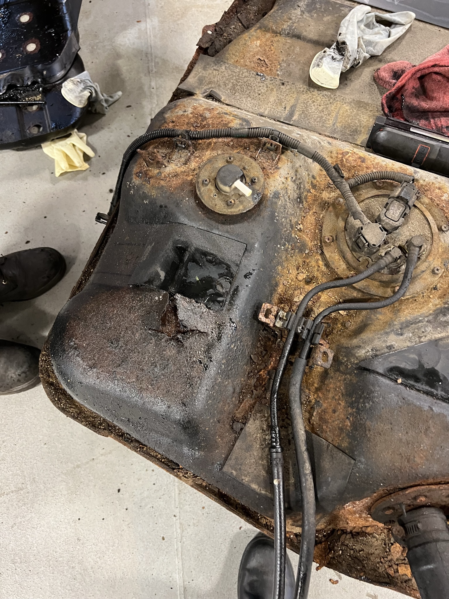

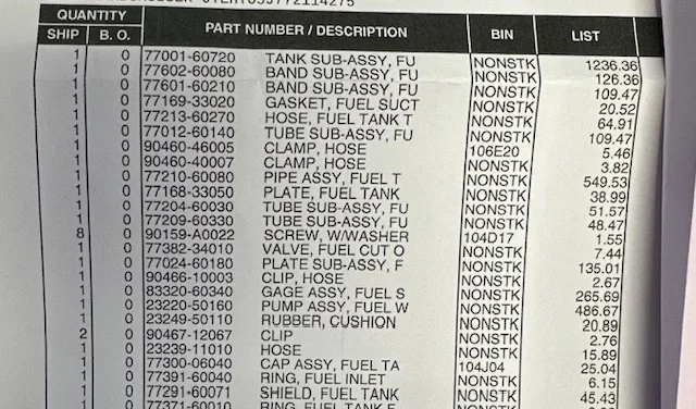

Hey guys, back in August 2023 I wrote in I was throwing code P0456 (small leak in evap system) on my 2007. The code had now gotten more frequent. Gas cap has been replaced, smoke test shows no leaks, vapor canister was replaced, mass airflow sensor replaced and O2 sensors are in good shape. I started throwing a few more codes and turns out I have a corroding gas tank. Shop is quoting me about $4K in parts and $1300-1500 in labor. Does this seem about right? Thoughts on what I should do? Fix and keep, Fix and sell, Sell w/o fixing? Ive been hunting for a 200 series 13-15 or 17-19 to upgrade to either way. $5K goes a long way towards a newer ride. Its been in NJ is whole life so there is rust and Im torn. Any thoughts?

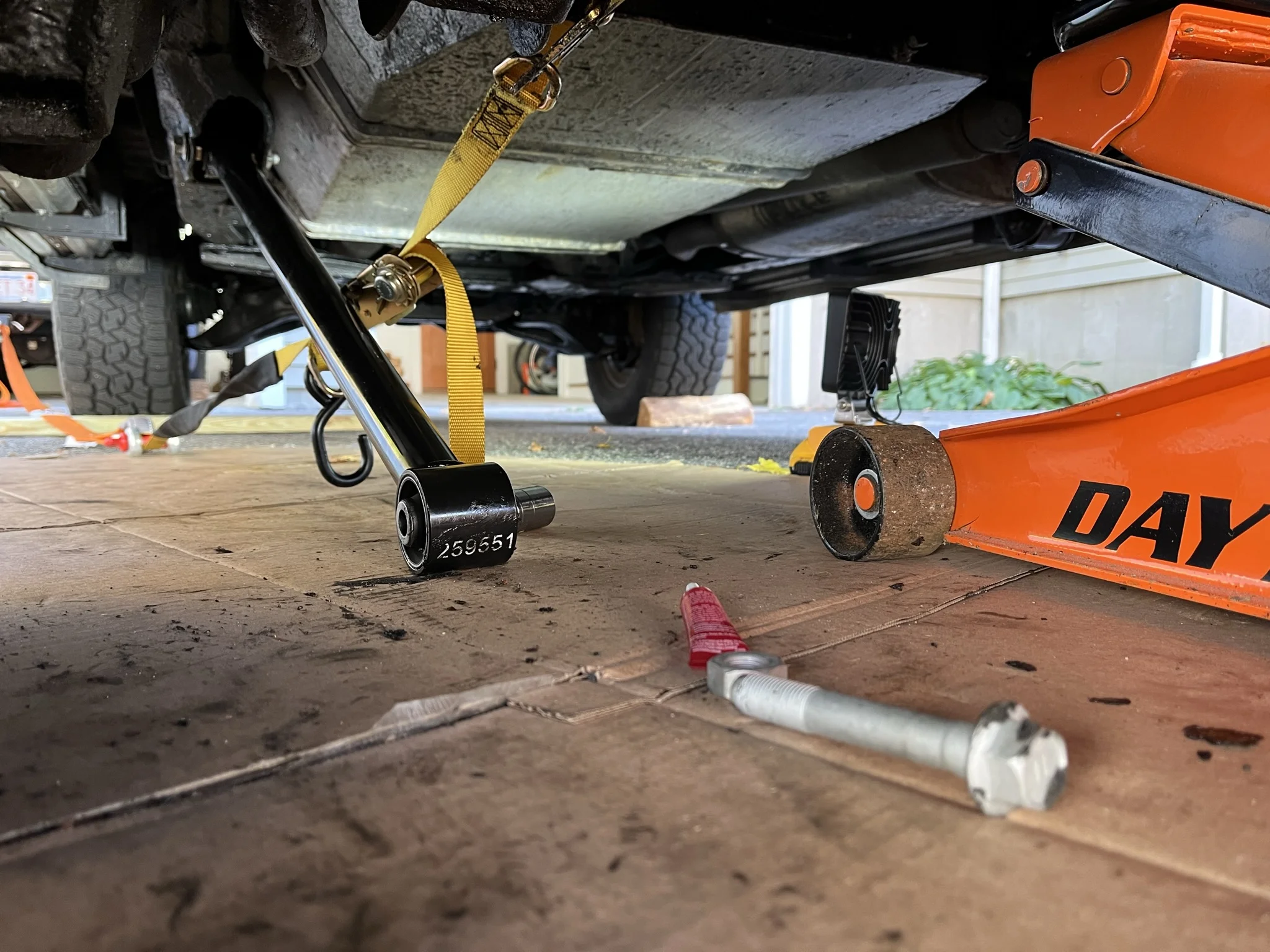

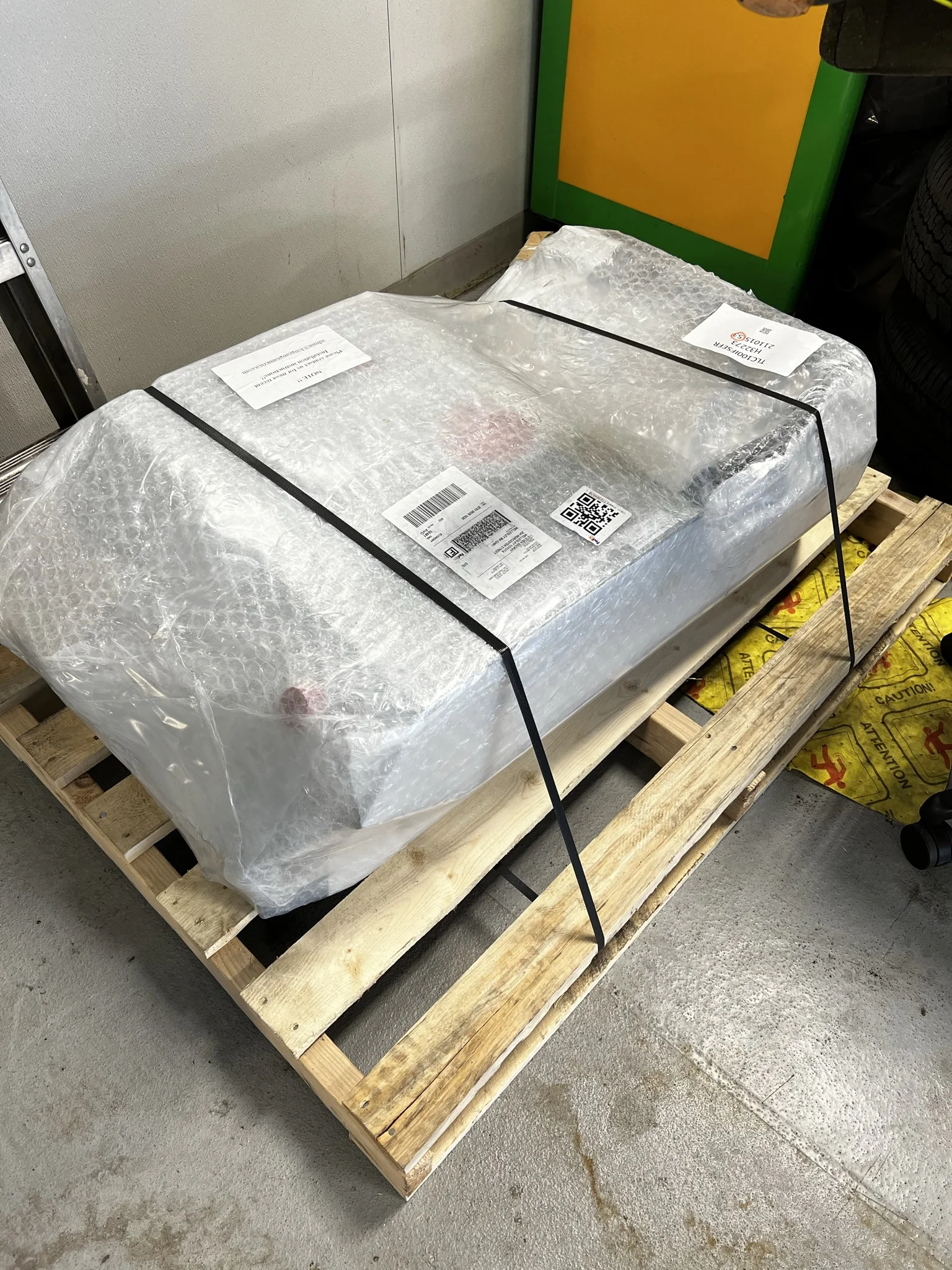

I had the same issues and can't stop throwing money at my rust bucket. 😕 I decided to replace the tank but upgrade to the Long Range America 40 gallon tank. The 40 gal tank was just over a thousand dollars more than the OEM one so it made the upgrade much more palatable. All of the other OEM parts are used in both situations. I'm really happy with it because it provides a lot more flexibility with when to refuel.
