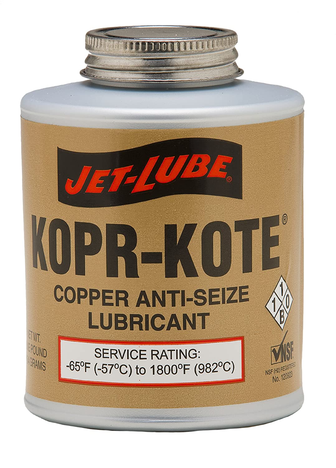

I like Jet-Lube Kopr-Kote. The 1/4 pound can is a great value.

I find Kopr-Kote to be way less messy. It has honey-like consistency and wipes off neatly. The silver stuff gets everywhere; the Tin Man is spot-on.
