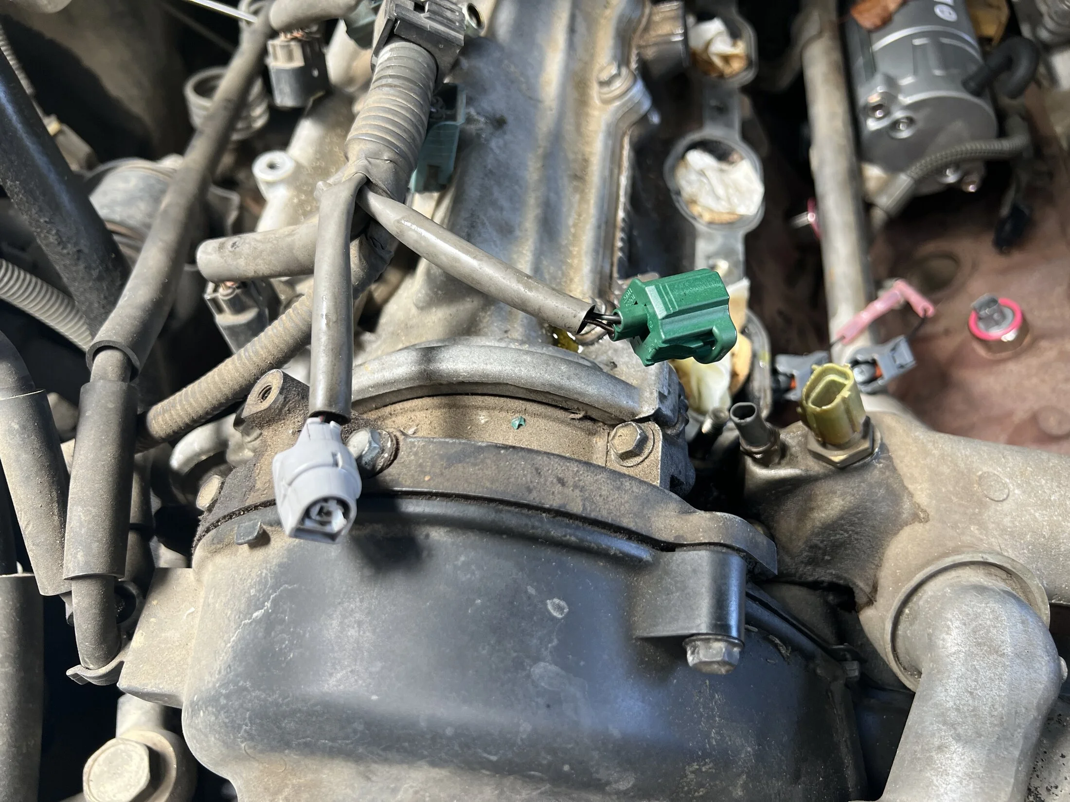

So as previously stated in my previous post someone prior to myself decided it would be real cool to tamper with and remove the temperature sensor plug so you couldn’t see that it was running hot. So I have finnaly gotten time to repair it and I have had the hardest time finding the connector for the sensor. It looks like it is a single wire connector but I can not for the life of me find one online. The only one I can find is the one for the ECM but none for the gauge. If someone could be kind enough to point me in the right direction it would be much appreciated. Thank you.

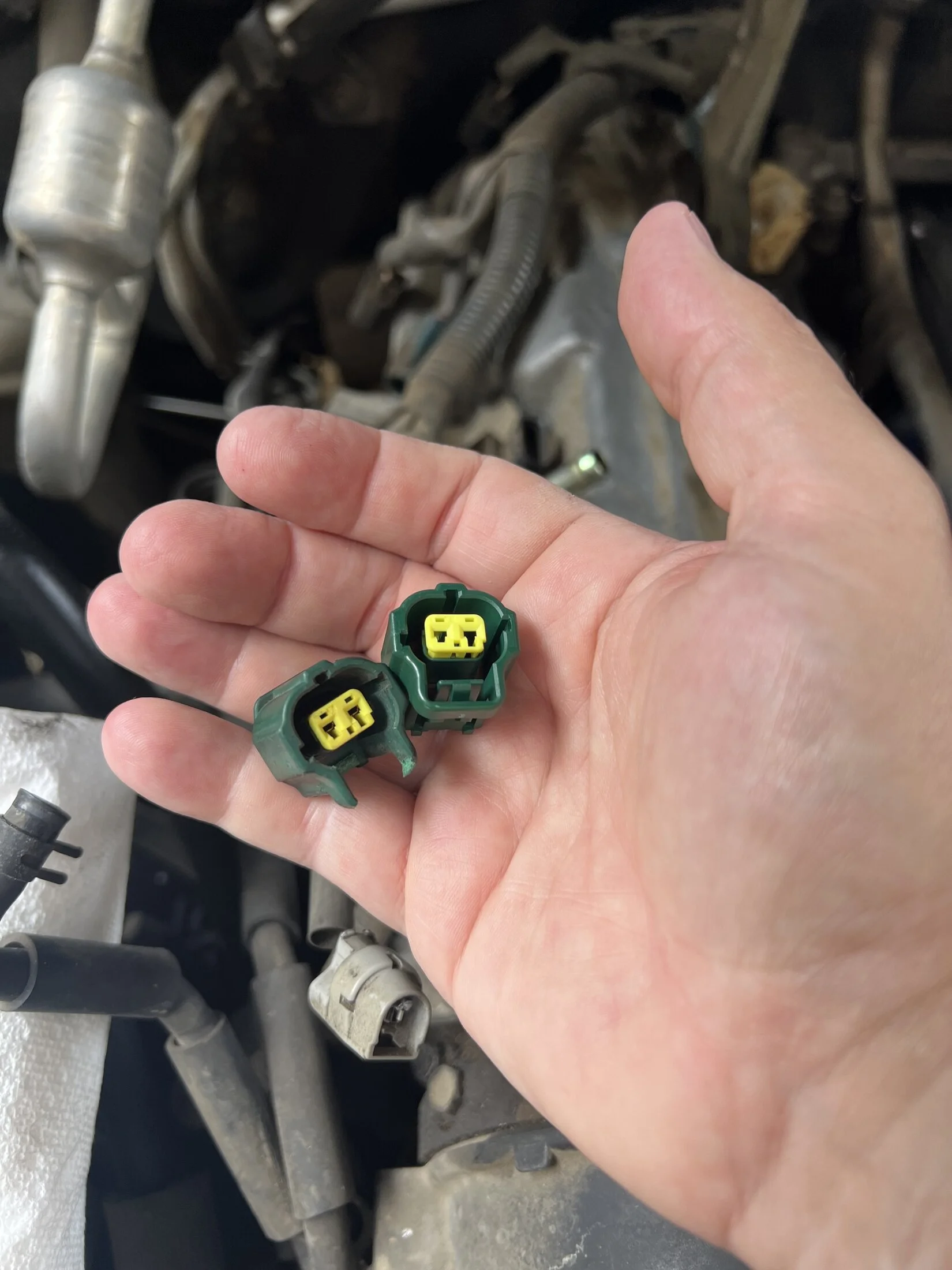

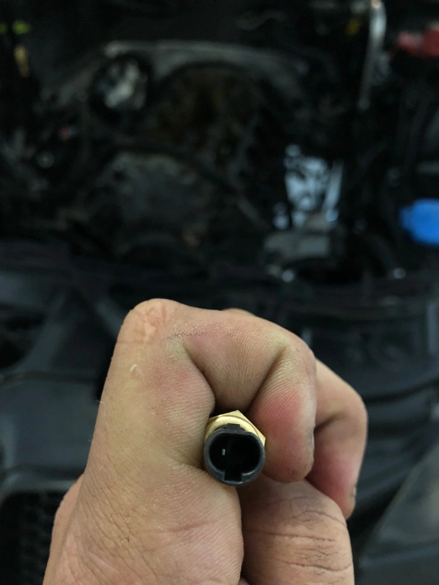

Ballenger part number for the single wire sensor that goes to the dash gauge. Mine was damaged so I was not getting a temp reading.
Wire and plug are located at the left front side of the intake underneath the plastic intake assembly
Description
CostQtyTotal
CONN-1008491 Way Coolant / Knock Sensor Connector Plug (Toyota # 90980-11428)$4.991 x$4.99
