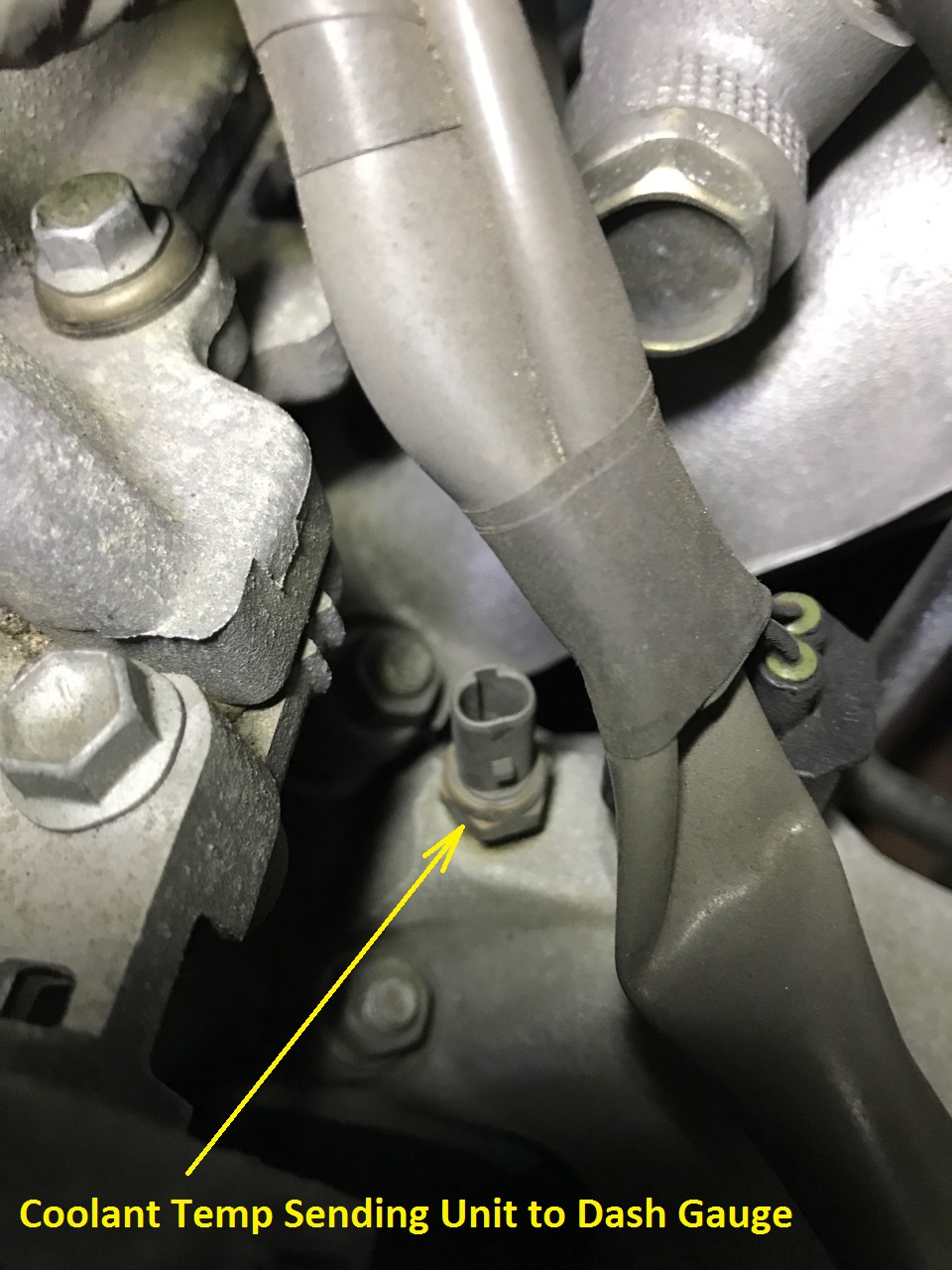

Question for the group: Does 2004 UZF100 have a connector for this coolant temperature sensor? I am almost done rebuilding my 2UZFE and can't find a clip for it anywhere on the engine harness. I started unwrapping the loom to see if I can find a broken wire, no luck. I know that only earlier models had this sensor. Thank you all in advance!
picture credit: flintknapper

I don’t know yet, have yet to start the motor. Wanted to track this down first. The two wire sensor has a clip, it’s the single wire sensor that I am not even sure ever existed.

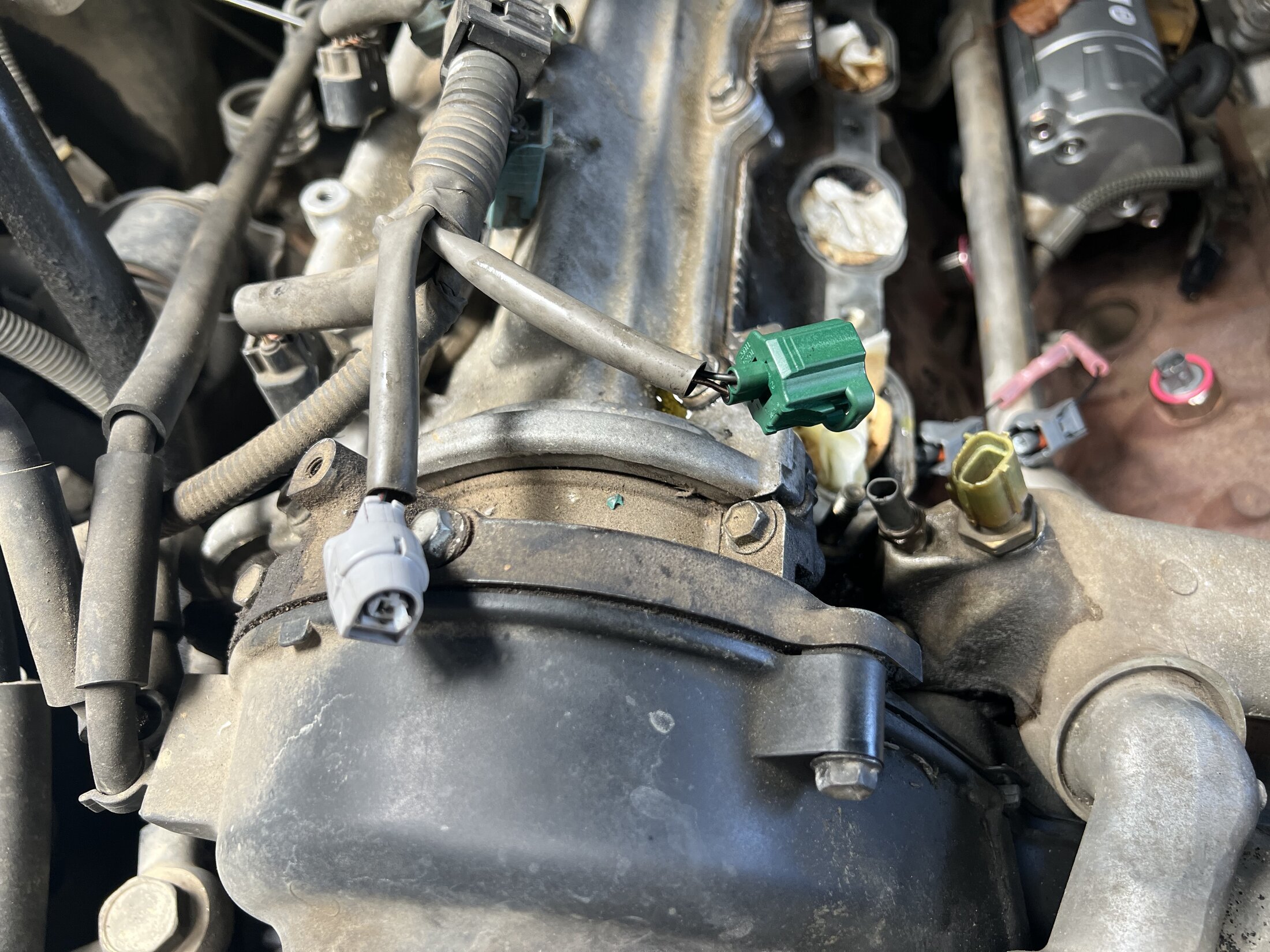

This is the clip that I am looking for. DuckLN what year is your cruiser? I wonder if certain years had this sensor but didn’t utilise it. Thank you for quick response btw!
98-02 have two sensors. One is for gauge and the other used by ECM.
03-05 No wire is attached to the lower water sensor. Top water sensors is used by ECM & dash water temp gauge.
06-07 One water temp sensor, for ECM & water temp gauge. Has redesigned front water bypass joint with only one sensor hole.
04-05 No wire is attached to the lower water sensor. Top water sensors is used by ECM & dash water temp gauge.
Exactly the info I was looking for, thank you very very much!
