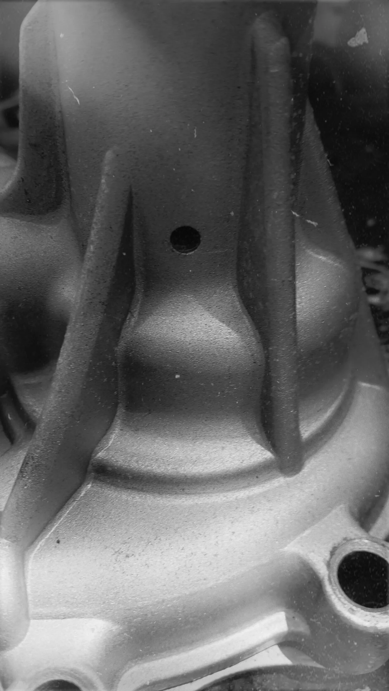

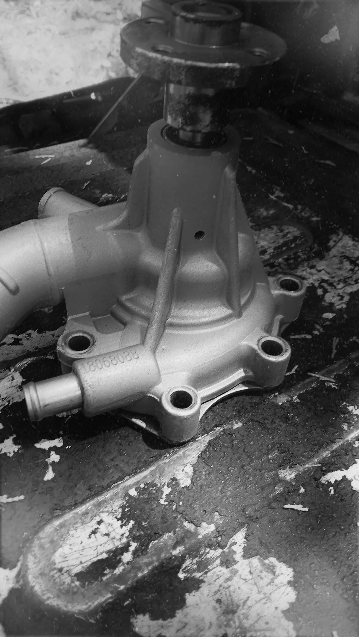

The weep hole is really, really hard to see and really hard to get even a pic of. Here's a pic of my spare, slightly earlier 2F, with the weep hole.
Naturally, I would exhaust every other possibility for a leak before I decided to change the waterpump. But you might want to start shopping for one.

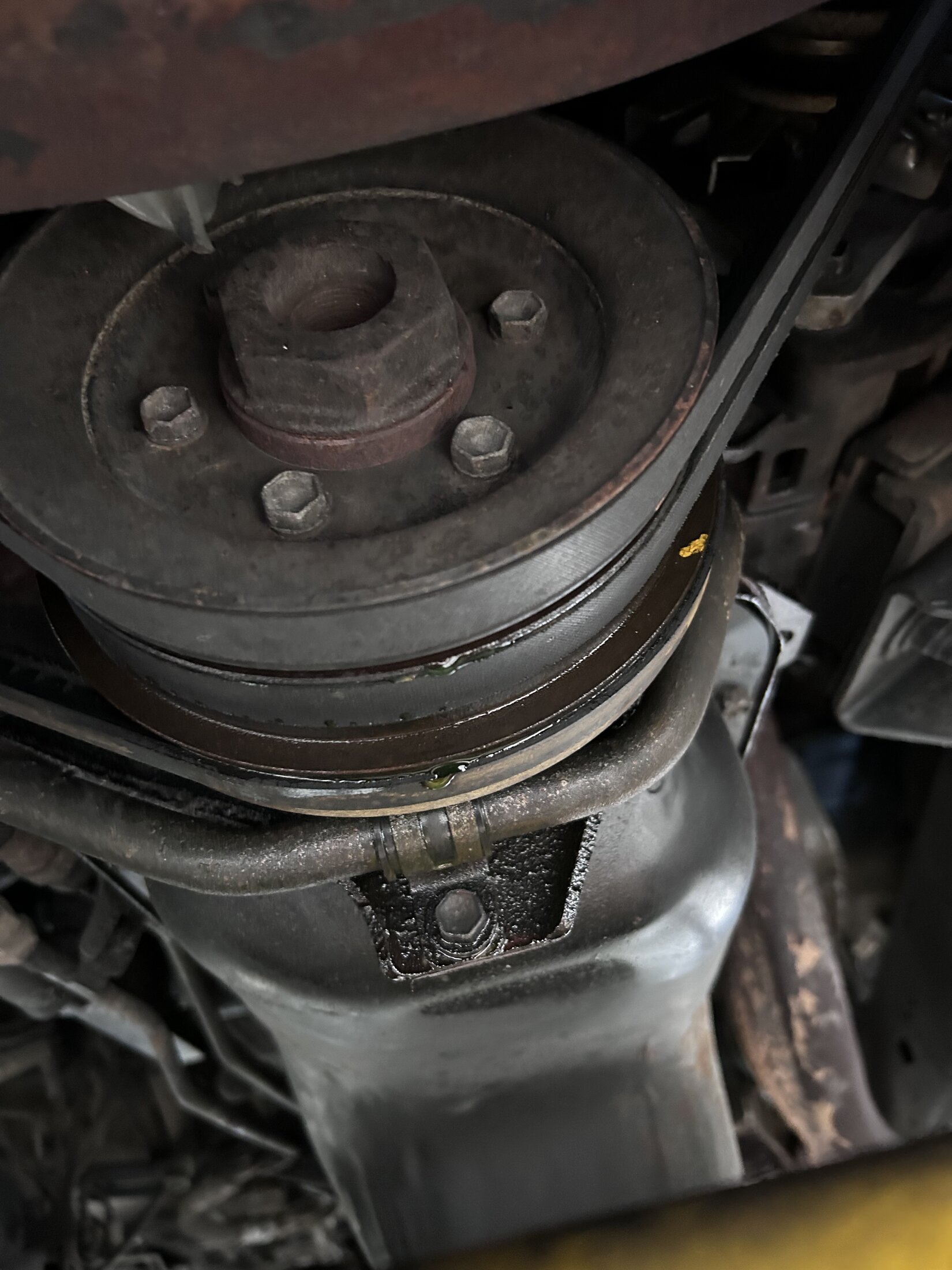

Yeah, just a oil change. I did check and everything look's good there. The coolant level was low, but it just started leaking to the point where i noticed it and diagnosed it as coolant. Picture below shows small drip where it comes off. I have a video but can’t get it uploaded.

Dripping down onto the pulleys. Not much help. I’d get some degreaser and spray the entire
front of the engine and clean it til it’s dry. Then take it for a run to get it hot and find out
the exact source location. All you can do is keep wiping it with a rag and looking for the
first leak point. Nice thing about smartphones is I can get mine into areas I can’t see and take pics
of somewhere I can’t actually see. So just stick it up there and all around until you see something.
Basic troubleshooting.

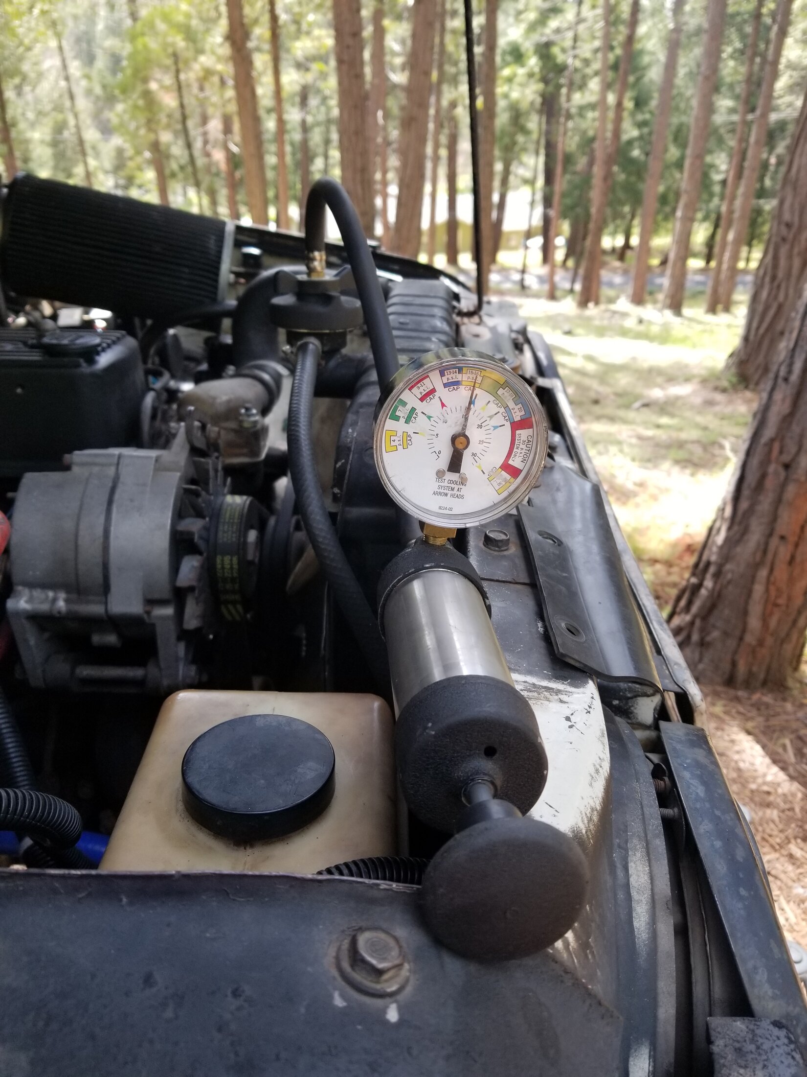

I might buy one of those coolant system pressure checkers. The one you stick in your radiator fill port and pressurize with the pump. Easier to find the leak without the engine running...
Cool! So that pressurizes the system, does it have capability to create vacuum too?

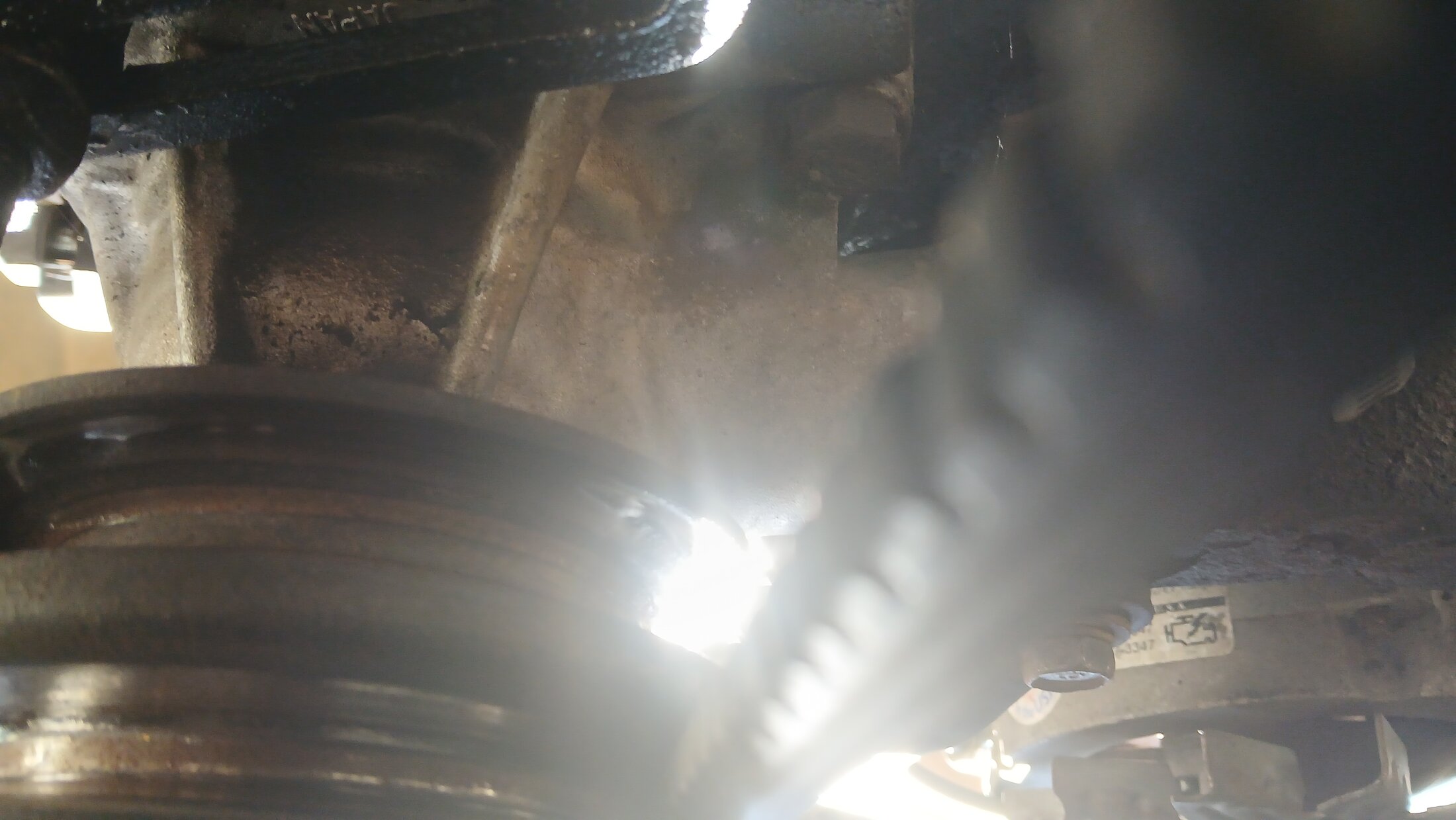

Yeah hard to photograph. Tonight I filled it up with coolant and started it. I couldn’t see exactly where the leak was. But it looked like the noise was coming from the movement of the water pump pulley. So guessing new pump it is.

No. It is a simple tool and only pressurizes radiators. I have another gizmo that makes vacuum. If your FLAPS doesn't have them, harbor freight will.
