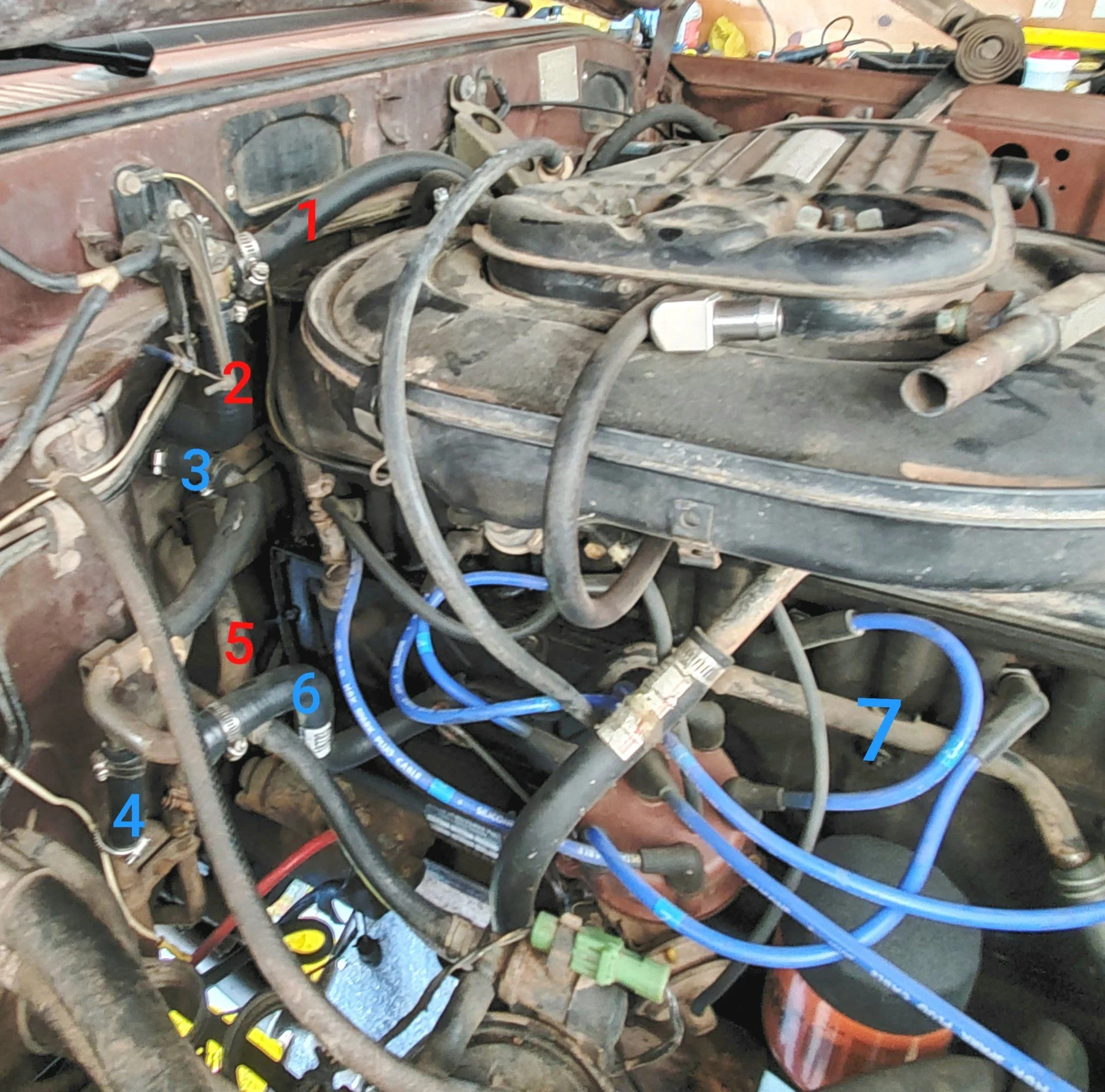

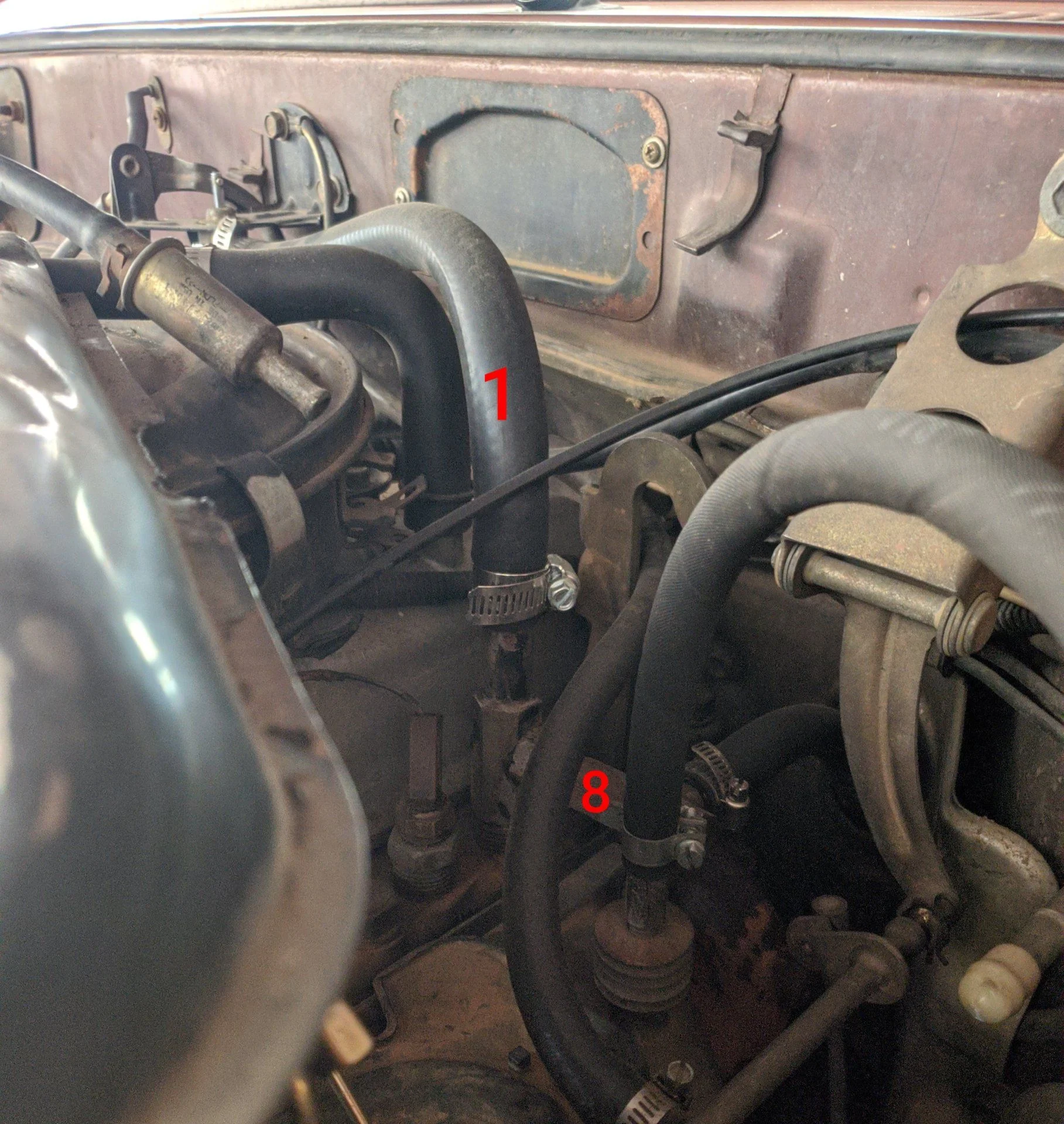

Hey there. How does the coolant flow? Trying to delete all my heat because leaks.
I attached some pics and I'm wondering if I can route hose #1 to the #7 pipe?
Ill plug the T on the driver's side at #8.
If I understand the coolant flow, which Im not sure I do, would introducing hot coolant from #1 to where it should be cooled at #7 cause my truck to run hot?

You need to plug hose 6, 7 and 8.

Thanks! You saying to plug 8 and the 6/7 rubber hose to pipe
Wouldn't this still allow coolant to the heater core thru #1. Trying to avoid this.
You could plug the 8, run 1 with a longer hose down to 7 hardline.
Your photo numbers are correct:
Coolant enters the dash core through 1 and 2, then returns through 3,6, and 7.
Coolant enters the rear heater through 8 and 5, then returns through 4 and 6.
You might see a minimal temp increase, but when the heater valve is closed coolant isn't flowing through the dash core loop anyway. I think it's safe to say many of us have deleted the rear heater and haven't had issues with it, at least that's evident here on mud!

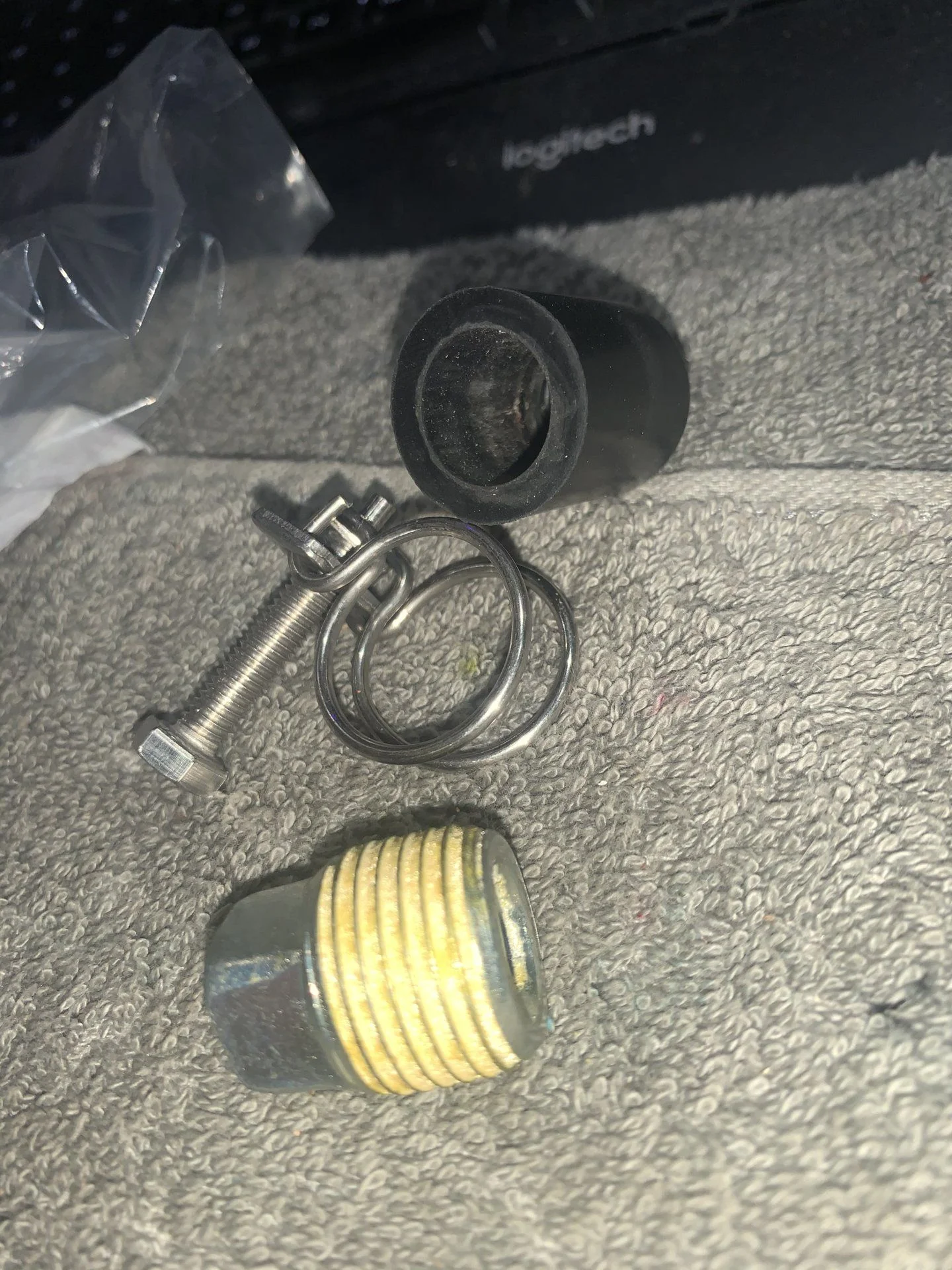

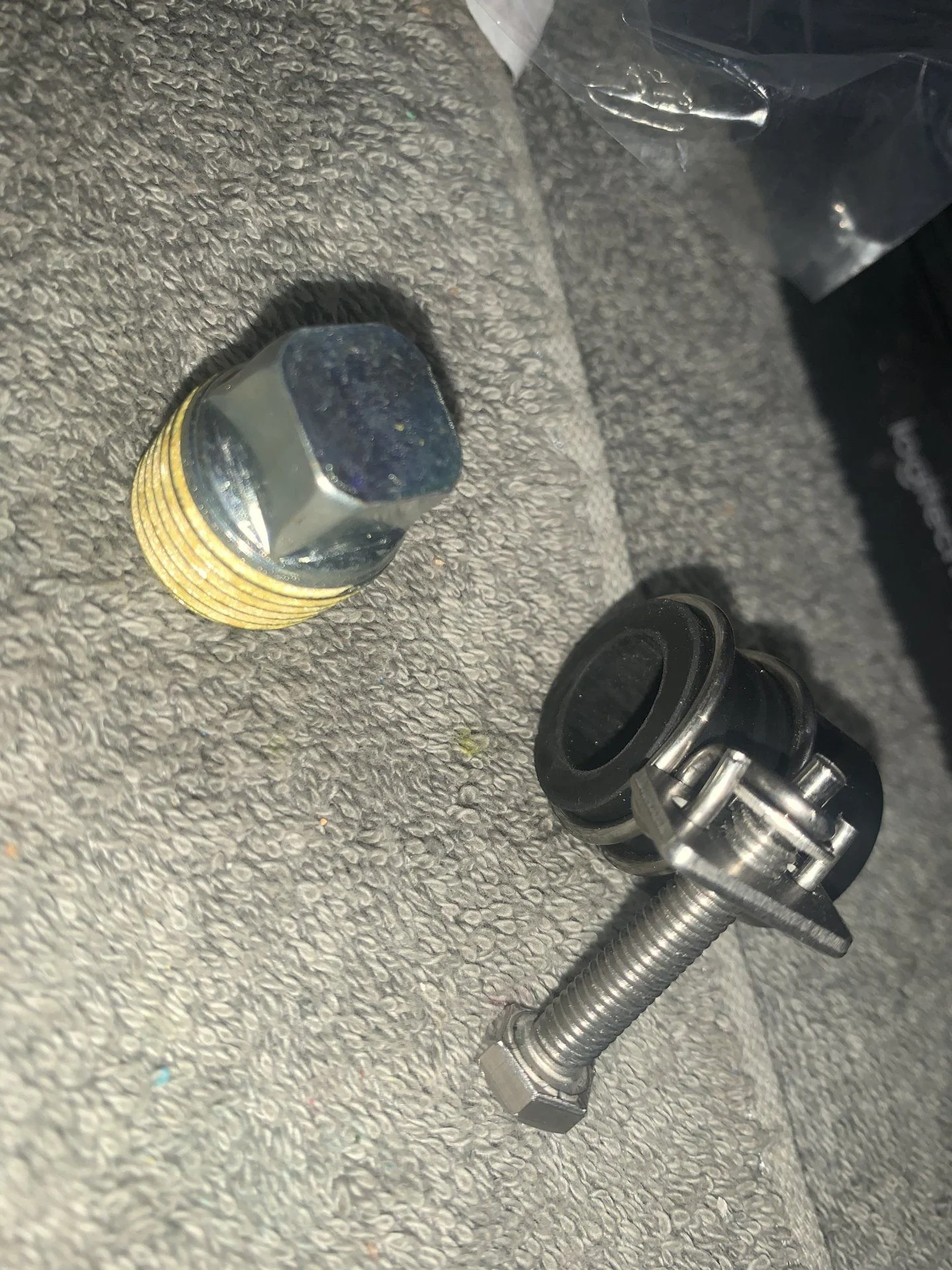

Here’s a common plug that works for #8:
My man! Great point. Gonna run it. Thanks much
