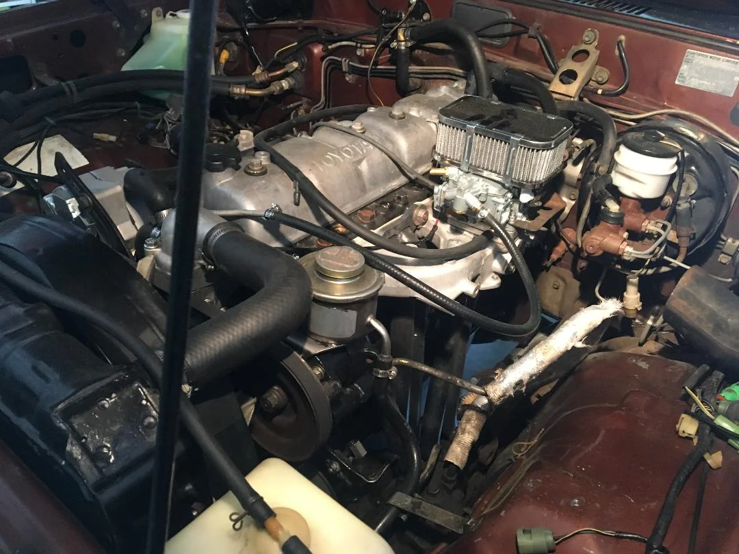

My Engine bay:
Hey, you're missing a LOT of very important components under that hood!!!
Need to do the heater removal as well, and when I move to Texas, Im leaving my smog crap here!
If you want to do it quick & simple, just remove the hose ends at the pipe ends that are under the car that lead up through the floor and clamp a small length of 5/8" heater hose to both ends of the pipes— then kink it at the bend & wrap it with twine to keep the kink pressure tight. I had mine like that for 25 years. The kinked hose was fine.
Ha, hell, I still have more s*** I could pull out of there. This truck is not going to end up in California, that is for sure. Was so nice to get to pull all of that out, add headers and a new carb. Was like I got a race car compared to what I had before.

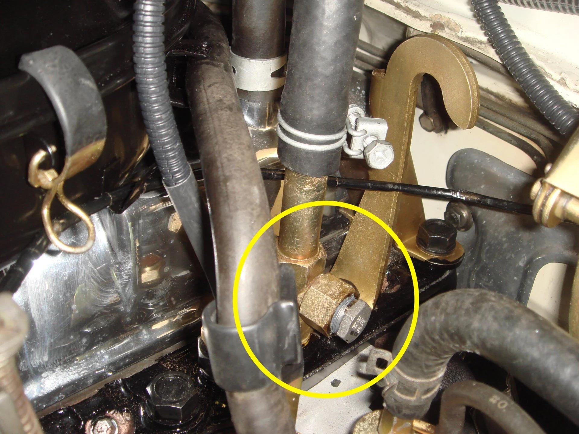

Well if you really wanted to get rid of the rear heater (like I did since my new seats needed that space) SOR has a rear heater bypass hose with the right preformed bends. I couldn't find it anywhere else. It works great. Then you can cap off the Tee fitting rear heater outlet with a plug.
The entire rear heater plumbing under the car is then unused.

I ordered that plug, but could not find the hose on SOR...I sent your pic and asked them if they could get me a part number. I see a part number on the hose but have had no luck with it. Any chance you know a good part number for it. Looks like there is more writing that I cannot see on it.
Hmmm
I'll snoop around on their website and see if I can find it again. I originally found it on their website. Bought it in 2014. I have since sold my 60 so I can't check the PN.
It's a Gates hose that does have a number stamped on it, but when I tried to find that hose (4 years ago) after I bought the pricey one from SOR. I couldn't find that part number anywhere on the internet. I think I even downloaded a Gates. catalog and couldn't find it back then.
I'll know by today if SOR still has it on their site. I'll post back here to confirm or deny. @John Staton

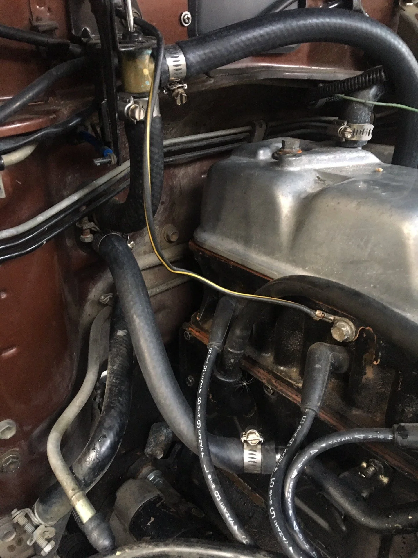

Ok, done....thanks for all the comments and advice. I had a hard time getting that bypass part off to put the plug in. Was too close to another part and could not turn it so ended up cutting off the hose nipple. Once I got it out the plug would not fit. Went to napa and got a different one and still no luck. Ends up the threads seemed to be an oval shape and would not accept the plug. May have been easier if it would have been a tapered plug, but I could not get it to screw in.
Took out the connector all together and went with one with a barb connector....deletes another possible leak point so I am happy. The other side I just cut off the part that siphons off coolant to the back heater and went with about a 13" section of hose. Started it up, topped it off and no leaks. Back heater deleted. Will keep it all together in case someone wants to add it back in the future. Now time to finish that carpet kit.
Is that the temp sensor behind my connection with the green wire going to it??? All rusty and dirty....maybe order a new one.
Looks great. Make double sure that the new heater hose arrangement coming out of the head can not possibly touch the valve cover when there's a lot of offroad vibration. The valve cover gets really hot and maybe could melt the hose? Dunno if it's possible, but better safe than sorry

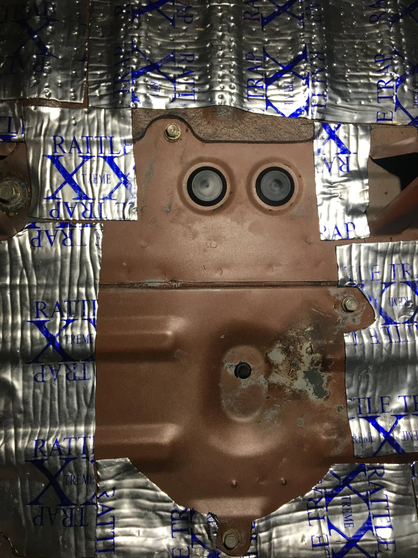

small thing, but I ordered plastic plugs from Amazon. The pack I ordered came with 50 with 4 of each size. Since the place where the hoses come into the cabin travels through a channel you actually need 4 plugs. The first two you will have to bend to get into the top holes and then push them until they snap into the holes. Then you do the same up top. Makes for a very tidy way to seal it all up. Finished my butyl layer last night in this spot and the front....now on to the new carpet set. I did cut the butyl out around the plugs so the holes can be located in the future in case anyone wants to add the heater back.
