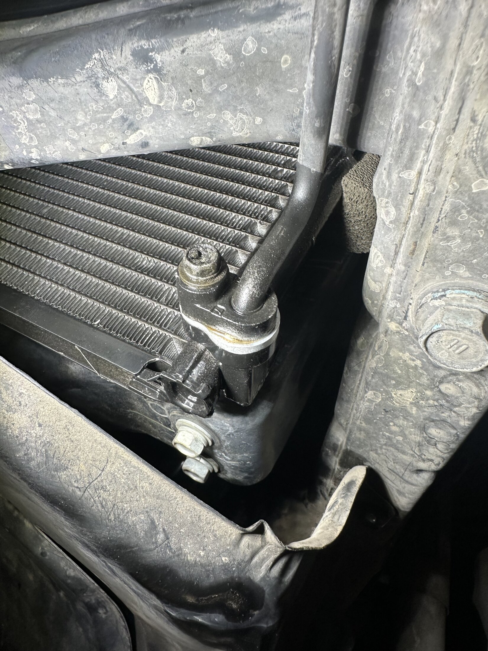

I just had a very reputable cruiser shop in Mesa Az put in a new condenser (and compressor and replaced a line).
They told me the condenser was the last one available in the country (OEM I suppose?). 05LX
On side note, the fitting to the line on the bottom of condenser is leaking oil and there’s bubble/ air boiling in the sight glass.
I assume I should take it back to the shop ?
Yes, I would.
I dropped it off this morning .. he said it wasn’t leaking but replaced the o ring anyways ? Said it was residual from disconnecting . Idk.. I wiped it off really good and saw it puddle right under the fitting.
Maybe I’m being neurotic .. We’ll see how it does after this go round I keep an eye on it
