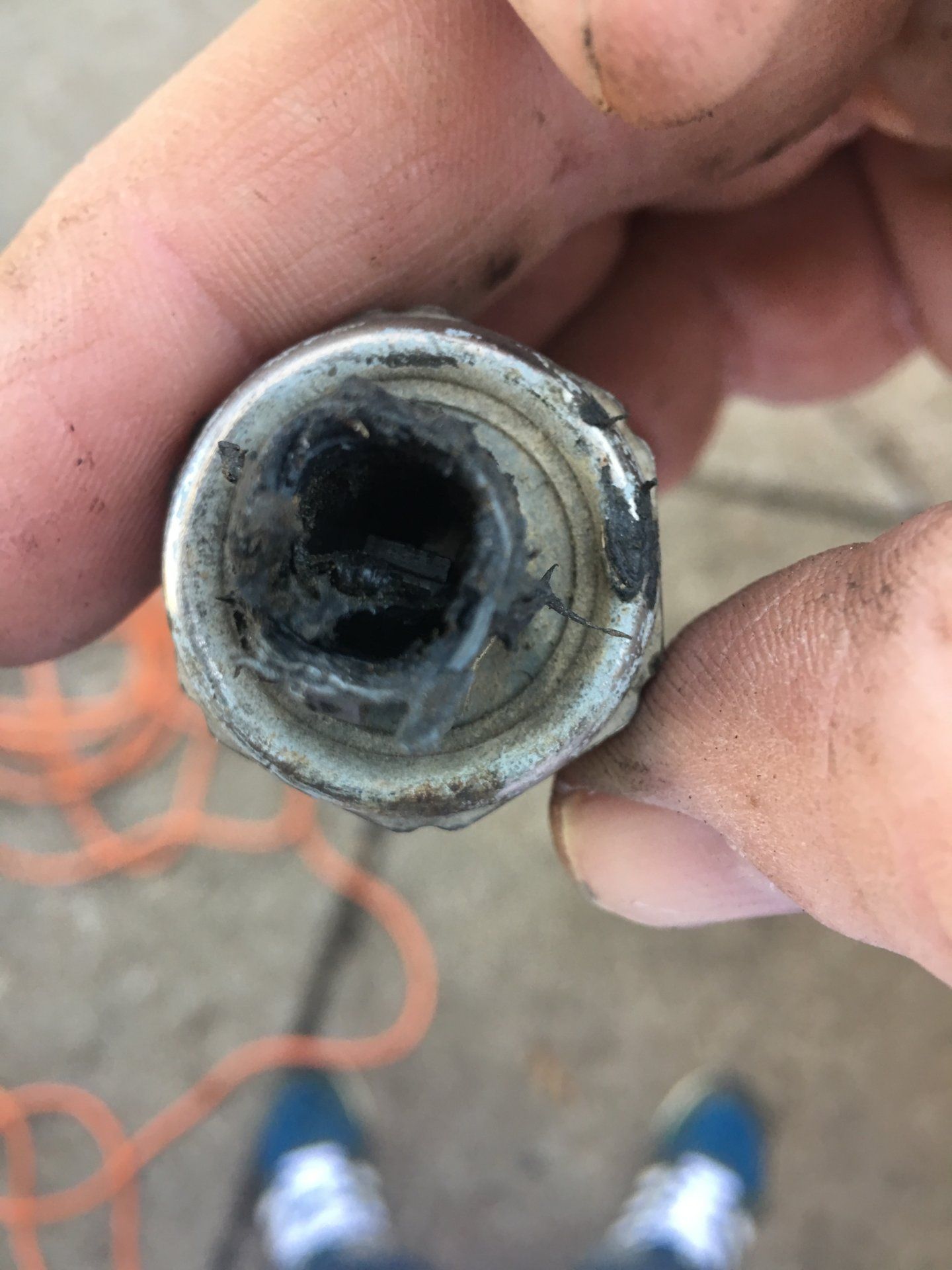

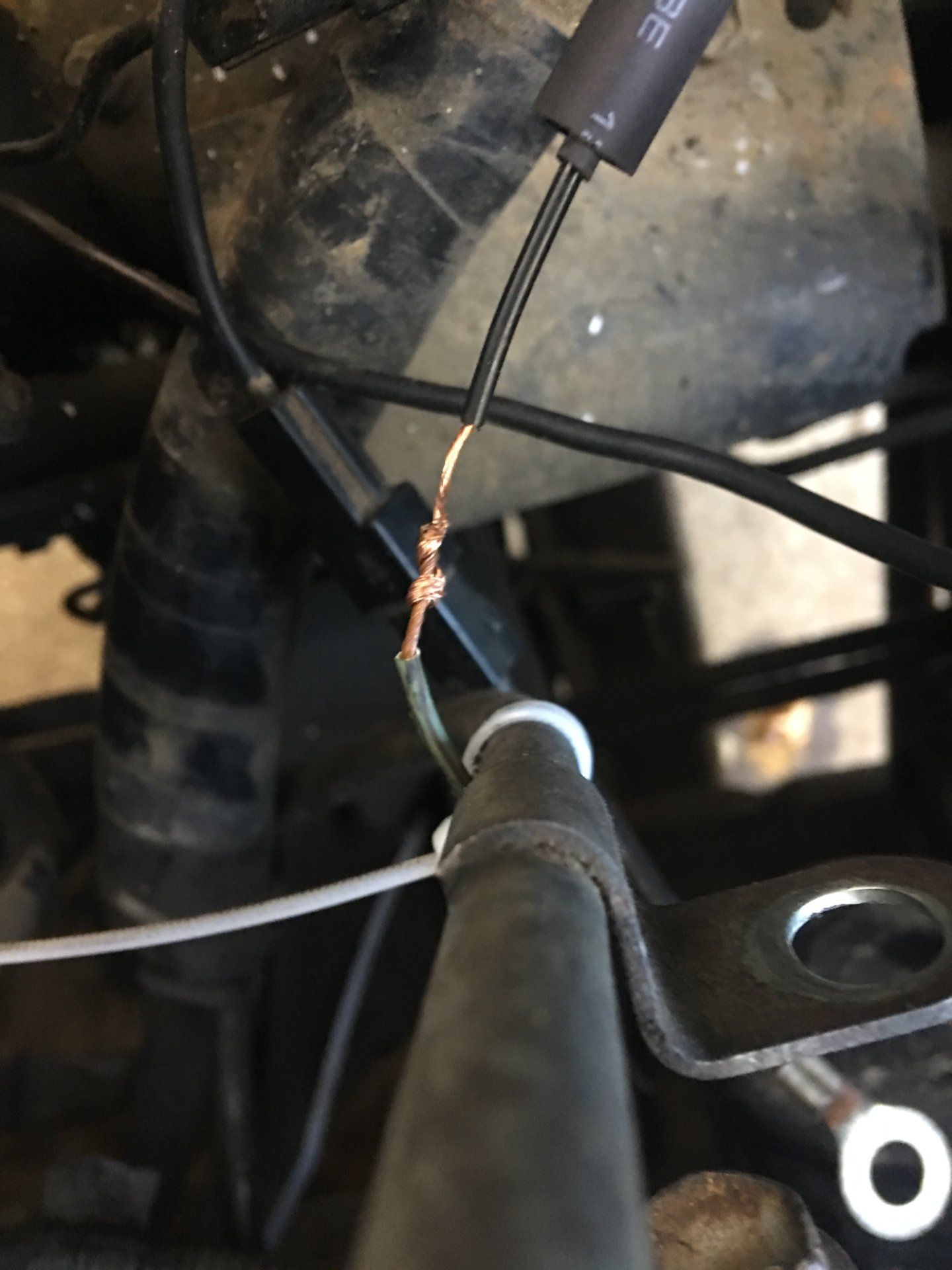

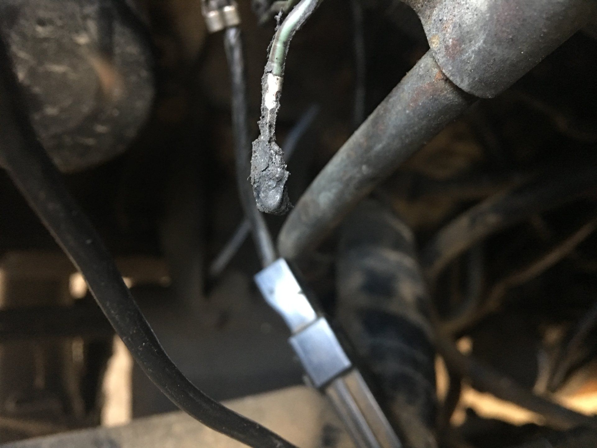

- spliced in a new male pigtail as the OEM connector was missing and RTV was used as a bonding agent
- tested knock sensor ohms, passed
- scraped the RTV out of the knock sensor
- stuffed sensor cavity with dielectric grease
- plugged everything back together
- 2 separate drives around town and no code
- drove on the freeway this morning, code 52 is back
RTV in sensor
RTV on female / missing OEM clip
Splicing, pre solder

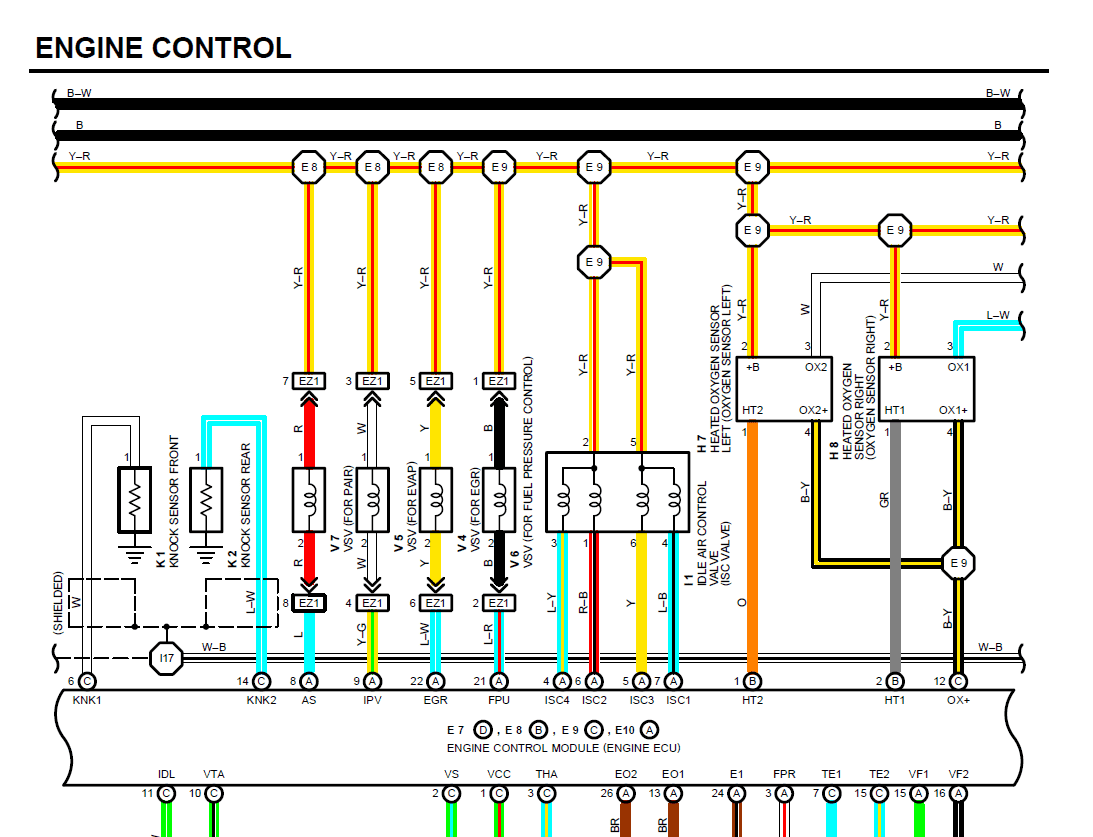

The troubleshooting chart for the ECM is thin:
Connectors are A, B, C, D from right to left
KNK1 is number 6, connector C
(see EWD below)
I've never had this problem, but my guess is that the circuit is simple enough that you should be able to trace it with a multimeter. Otherwise, Mr. T would have included a fault tree, as for the items on EG-234.
The front knock sensor is K1, the rear is K2.

FWIW, soldering harness splices is a bad idea. The solder joint is brittle and will fail under constant vibratory stress. A proper crimp connection, with proper sealing against environmental exposure, is a lifetime splice.
Huh. Good to know. I thought for some reason soldering was the best connection. this is the second time this weekend I’ve read about soldering not being ideal, well not the weekend any longer but...you get the idea.
@Malleus this is very helpful. Thank you
I’m electronically incompetent and I’m going to ask a couple questions that may reveal just how severe this incompetence is, ha ha.
1. To test the harness’ continuity with a multimeter, would I stick one probe in the harness connector at KNK1 and the other at ecm connector?
2. The “switch” in your first comment is KNK1, correct? And if so the switch is triggered by the engine knocking?
1. Yes, but that harness is really long. Like 10 feet long. I'm not kidding. I have one sitting in front of me. I'd run a jumper from either end and check the end of that jumper and the connection.
2. Yes. Good question, I've never had a reason to look up the knock sensor. Now I do. I'll let you know, if no one beats me to it.

Also, could this be another hot EGR pipe melts wire problem?
As for the drives around town then it throwing code on the highway...my wagon ecu takes about 19 miles and 6 start ups to relearn and throw a code. You may have never really "fixed" the problem to begin with.
p.s. I'm swapping in a motor and have some odds and ends I don't need. So, if there are any other used parts you may be thinking about let me know. If I have them you can have them.
That’s a great offer! I agree that I haven’t fixed the issue.
I’ll search more on the hot EGR pipe issues, it could be the case. It could also be the sensor I have isn’t clean enough.
This makes sense. Would I be testing in ohms?
